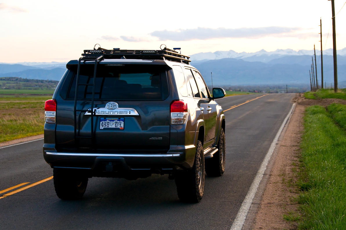

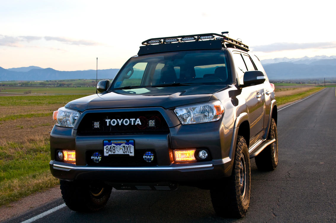

Can't say enough about the Budbuilt with Full Tread. With the tread they are GREAT step and I use them all the time to access the Gobi Rack. Small kids can clamber up and down. And without these as steps I couldn't get mountain bikes on top of my lifted rig. I can heft a bike over my head and step up onto the slider to mount on the bike rails.
Frankly I can't think of a better design (for me) and they look fantastic. Yeah the price is high but you get what you pay for.
Edit: I also wanted to mention that Budbuilt is one of the best companies I have dealt with in my aftermarket upgrades. Turnaround was in a matter of weeks on the sliders and communication was always fantastic.

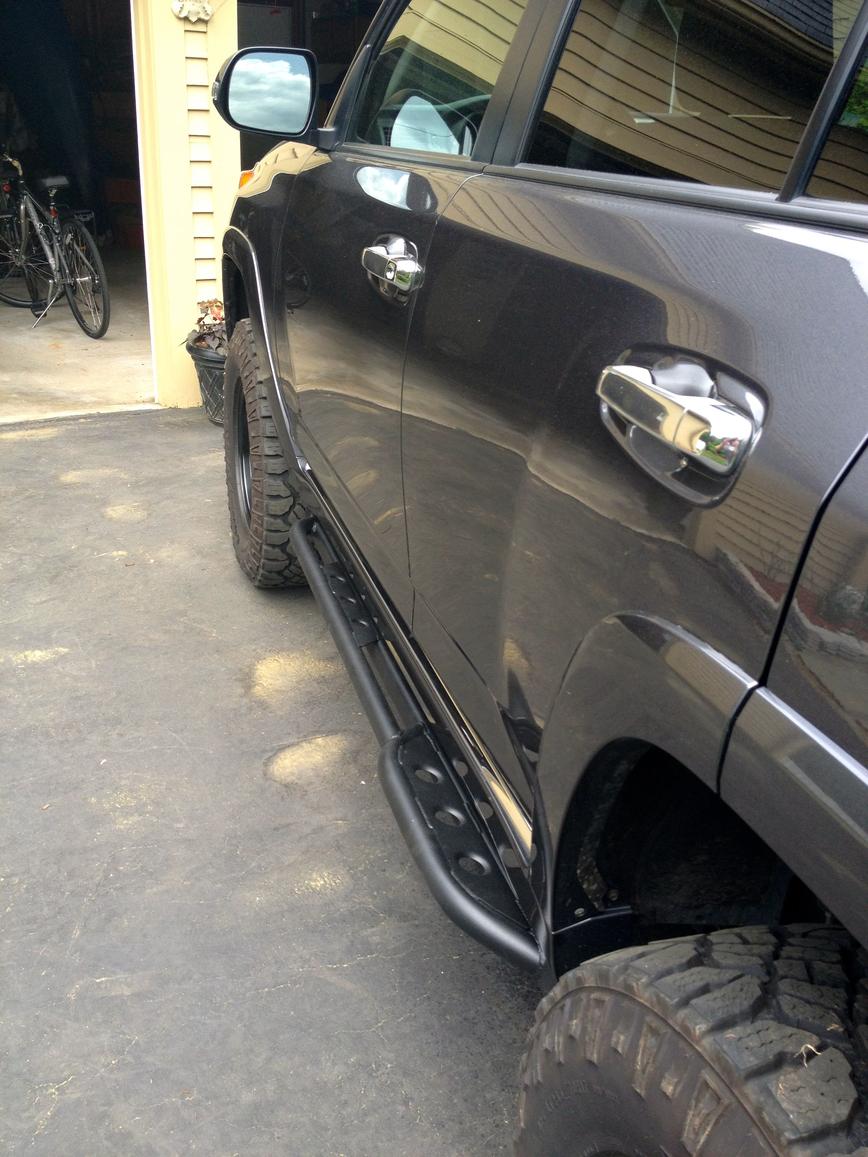

I've installed my OPOR sliders I bought from Metal Tech last week. Here's what it looks like. I got them in bare steel and used Rustoleum truck bed spray on them.

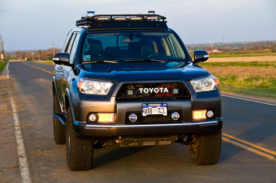

Thanks for those pics! Did you get your BB bump out sliders powder coated or did you paint them yourself?
Dude, that truck is amazing! If I had an unlimited budget (or specifically no wife) that is exactly what I would do to my 4runner. Top notch!
Let me help you out here Adam, click link and press add to cart: 10+ 4R Sliders, Bump Out, Regular - BudBuilt - Tough Toyota Protection
:party:
But on a more serious note, make sure you like how much the BB bump outs stick out, fab it up with a cardboard or something if anything. Some people seem to feel they stick out too far, IMO it's just right and a great sized step. If they end up being too far out for your taste, maybe get the Metal Tech OPOR sliders? You really can't go wrong with either brand...
