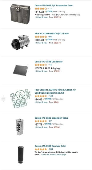

I believe [MENTION=113939]JerkyDrewster[/MENTION] replaced his entire AC in his 99 before he rolled it. I don't have the energy or search skills to find the post but he listed all the part numbers, some of which were available on Amazon at the time
I think you might have me confused with someone else! I think the most I did to my AC system was a standard recharge. My wife's old Civic had 3 compressors replaced in 2 years though... :frusty:
I think you are thinking of bamadrewski's ac write up DIY Complete AC Replacement on 2000 T4R Limited
Your attachment doesn't work by the way.
Yes! That's the one
