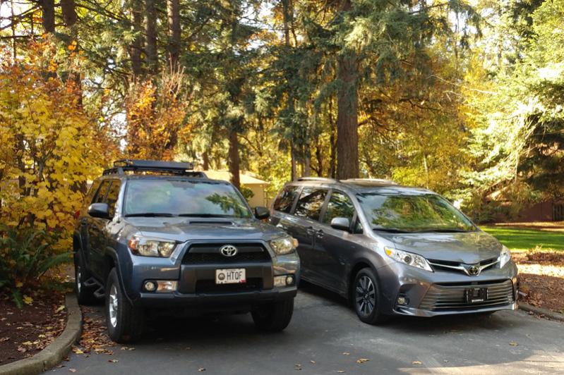

I run in S5 all the time, it helps with downshifts and delays. But that's on my old 2013 TE.
Our other Toyota is a 2018 Sienna with the 8 speed and radar cruise. The radar cruise works very well in most conditions.
