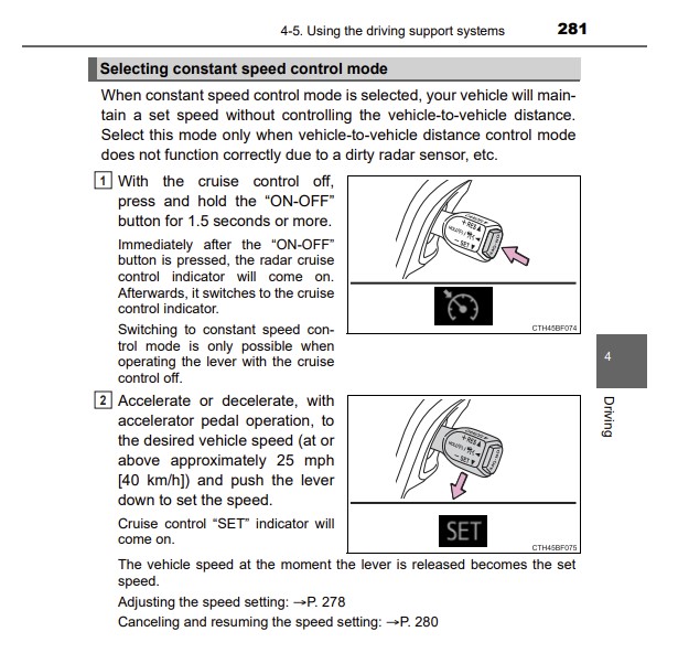

Does anyone know if there's a way to use the cruise control without it being dynamic and adjusting speed/distance? I just want an old school locked speed cruise control..
You can turn the adaptive (radar) cruise control off and have normal cruise control.

Page 281 of the manual that no one reads.
Last night I went out and tested to see if the 4runner would behave any differently in "normal" cruise control mode while going up long and fairly step highway grades at around 79-80mph. Wind wasn't bad either.
She'll still grab 4th about 1/2-3/4 way up. Damn. Turn the cruise off and use my foot to maintain speed and it doesn't downshift going up the same stretch. So frustrating. I guess I'm just going to have to learn to not use cruise control when driving in areas with any real grade and/or wind.
