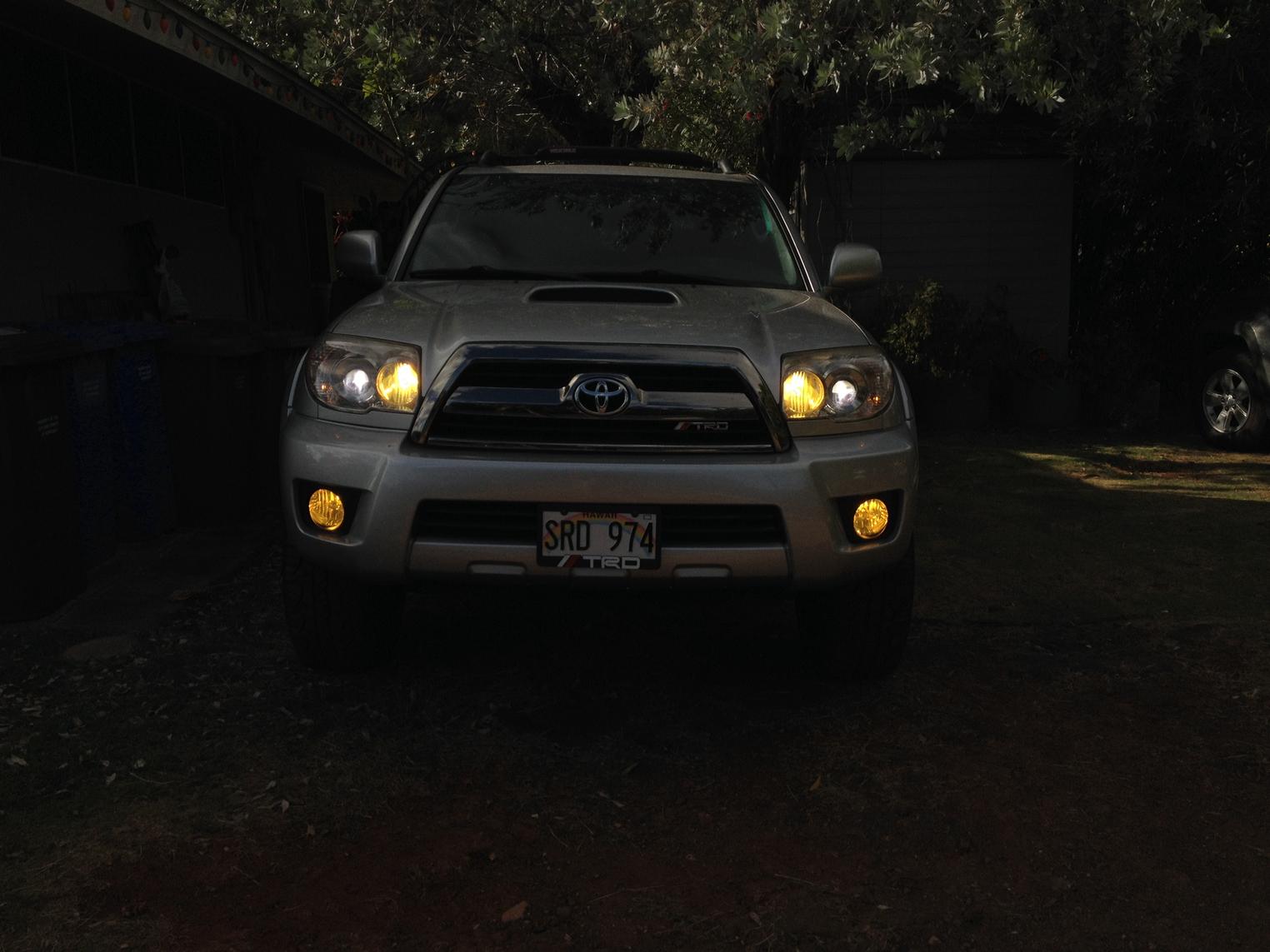

did it!.. thanks everyone for your time and input, also to JA for the great write up..
I installed nokya 2500k in fogs and in highs too. Looks great!
Now all I need are independent high beams.....and for lows not to flash when lights are off and i flash my highs.....

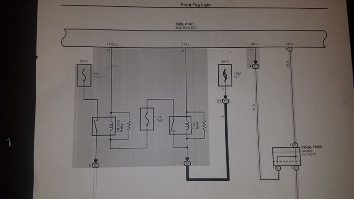

2019 Electrical schematic attached
Looking at the 2019 diagram we can see that there is still an AND gate that only allows the fog light to receive power when
1) ECU PIN14 is at ground closing the TAIL relay
(AKA ECU senses that the Parking light or Headlights are powered on and then puts pin 14 at ground)
AND
2) ECU PIN 13 is at ground
AKA ECU senses that the fog light switch is the closed position.
Option 1)
Wire the pin on the FR FOG relay Coil that original goes to ECU PIN13 directly to the Fog light switch on the Switched ground side.
By using a relay tap on the relay pin and running a single wire through the main grommet on the fire wall to the fog light switch.
This would
Still allow one to control fog light on or off when the head lights are on likewise fogs would stay on even in hibeam mode.
You would still loose dash light indicator of fog light on/off
Option 2 the simplest MOD...MAYBE)
Wire FR FOG relay coil pin 13 directly to TAIL relay coil pin 14.
This would.
1) Have Fog lights come on and stay on if PARKING lights/or head lights are on regardless of hi/low beam position
2) believe this would result in a situation if you are running AUTO lights that DRLs would still work with Fogs being off while in DRL mode
3) fogs would auto illuminate if in AUTO the ECU decides to turn on headlights.
4) fog light switch would not control fog lights AKA fogs are controlled by headlight switch.
PROBLEM is ( motor off so one can hear relays close)
Sounds like the the tail relay ( TOWING TAIL marked relay) is in the under the hood fuse box; which would make sense since diagram shows 12+power coming in off of a junction connected to the alternator.
AND THE FRFOG RELAY is located behind the DASH.... :(

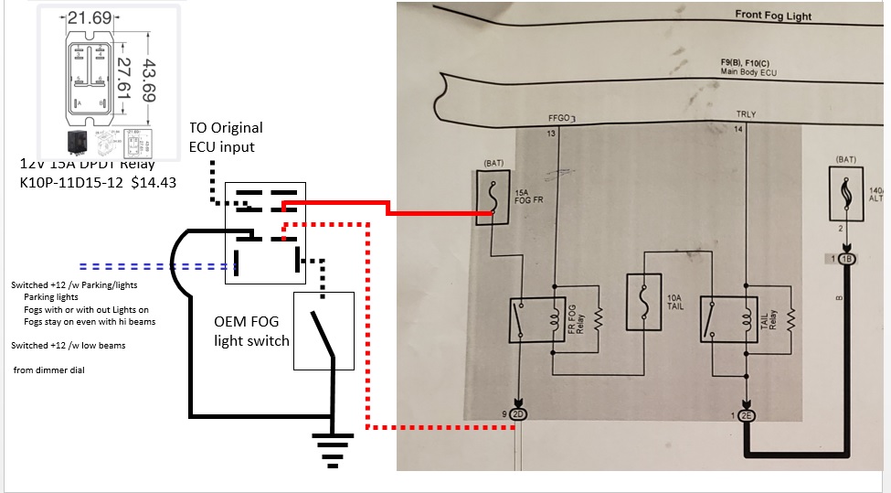

There is the diagram of the wire setup to make this work to have independent fog lights /retain dash indicator/ retain auto lights/ retain auto off...
Reminder this setup requires that at least the parking lights to be switched to on
This is NOT FOG light on at any time.
To find the correct wires I used a test probe to find the +12V switched coming from the dimmer dial. ( blue doubled dashed line)
and the same probe to figure out the wire coming out of the ECU that is the power supply to the fog lights ( dashed red line)

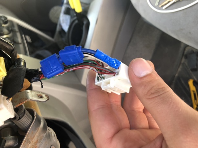

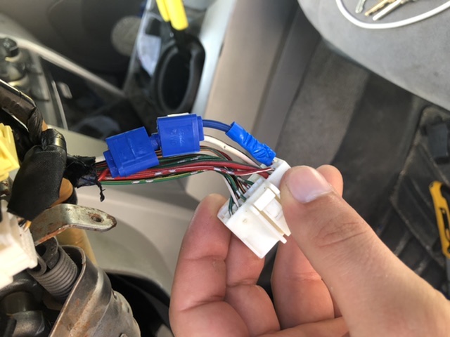

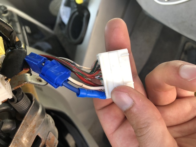

Hey guys,
I’m struggling with part 2 of this mod. I didn’t do part one as I just want these for Off road usage while the lights are on. I made a mess of the wiring and clipped wires when I should t have and now am in a jam... my headlights and turn signals work but not my fogs and my headlights don’t auto shutoff now.... any help would be much appreciated.
I’m at a loss as where to go from here...
-CW

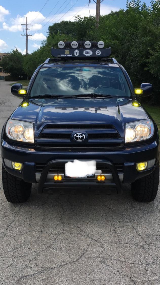

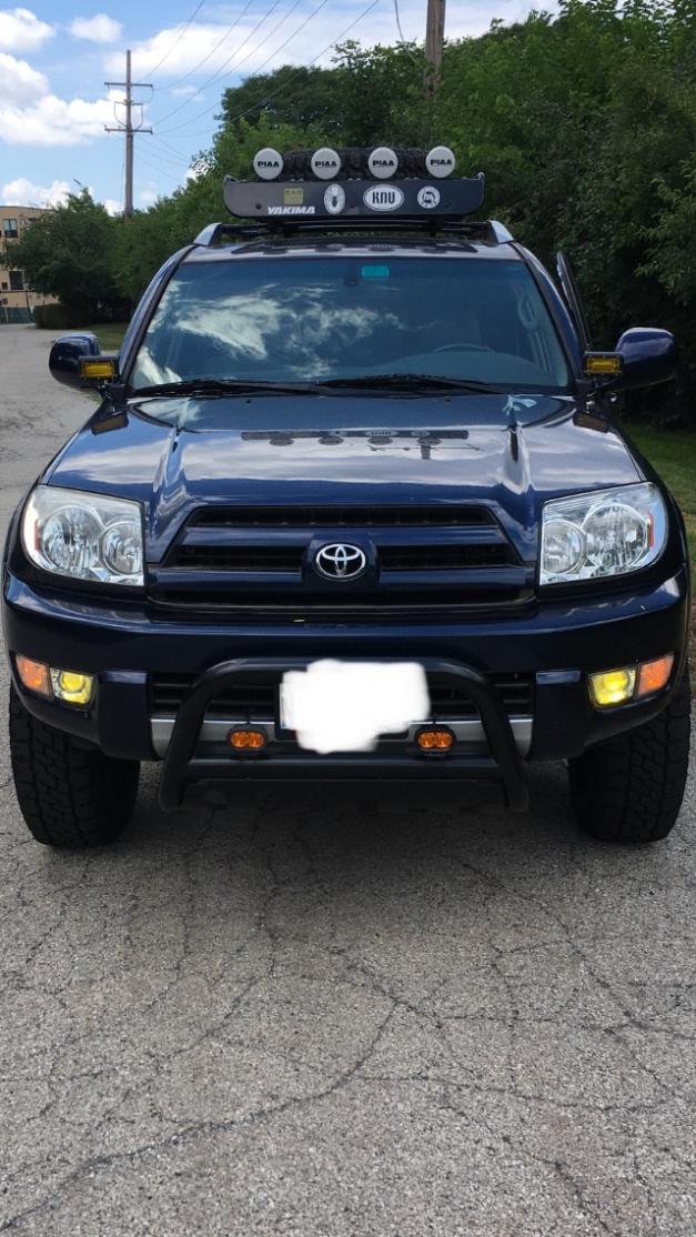

I did this fog light mod a couple of years ago, but never took pics.
More recently, I added a second (third?) set of fog lights where ditch lights usually go.
The first pic shows all the lights on, DRLs off. The second pic shows just the OEM fogs and the DRLs on, low/high beams both off. My two sets of aftermarket fogs are wired together, and only work when the headlights are on. The PIAA offroad/white driving lights on the roof aren’t connected yet, but I have all the wiring/switches ready to go. That’s my next project after I get rid of all the surface rust on the chassis/undercarriage.
