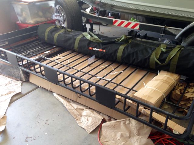

So I got all the Curt rack parts from Amazon Warehouse. Under $40 for each extension and under $80 for the main rack.
Did a little fitment and am happy to say if you want the versatility of an OzTent it will 100% fit the rack perfect. I have an RV-4 but its also the exact same closed up footprint of the RV-5.
Decided to stick with the Aluminum after all, steel is just too heavy and triple the $$ of aluminum. Im still going to have the rack welded together and then have the plates welded on the sides as well so its much stiffer. Then some paint.
Ill post the complete pic and if I did anything different. during assembly.

So i ended up following the steps in OP, it was just easier. Only exception is I had the rack welded together. Thanks for sharing this great idea! Saved a TON of money and quite frankly the rack is VERY solid.
