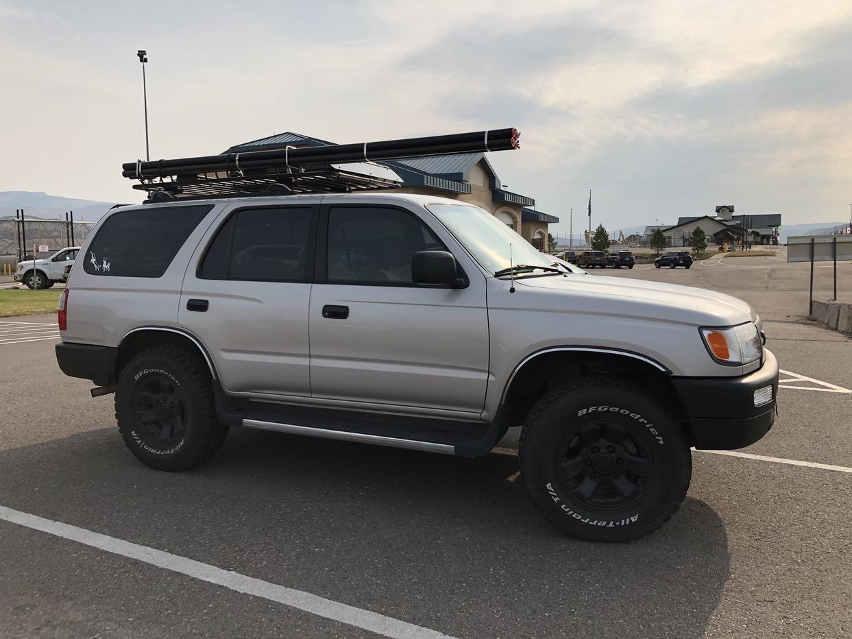

I just finished installing this on my 3rd gen and am really happy with the results. For the investment you really can't beat this setup. Thanks again [MENTION=143467]Toy2play[/MENTION] for sharing this!

Looks great! The rack helps a lot during our 4 adults in the runner camping. Lots of useful space. Glad i could help out.
Edit: super jealous of that lift in your garage!

What did you use as the support? Looks like a long L bracket welded/bolted to the aluminum tube/channel? I have been trying to figure out how to do this best and had the same/similar thoughts. I'm thinking to use the aluminum square tube as the main support and bolt that along with an angle/L to the roof. Then bolt the rack into the angle/L from the side (just like your photos show) so that I can 1. remove it easier and 2. maybe even fab some cross members in case I want to remove the rack and pop those in place at exact bolt locations for rack. This would be to maybe carry a canoe, etc. where I need only a flat roof.
either way, very interested in what exactly you did and why.
I used the 1" square tubing like the OP, and added an aluminum L bracket on top of it. I used longer bolts to go thru both the L bracket and the square tubing, no welding, but may do that in the future since I have a TIG welder.
I like the extra lateral stability the L bracket provides and I used the wing nuts to make removal quicker/easier. This way I can leave the supports on and take the rack off. I was thinking of maybe putting some cross bars up for mt. bikes, or whatever.
It's not hard, but a little tedious when it comes to lining up all the mounting bolts. By the way I used angled head bolts and countersunk the holes so they are flush.
Hope that helps. Let me know if you want to know what hardware to get, I went to Ace hardware about a hundred times figuring it all out and would happily help you avoid that! :)

As for the 1" tubing.. I meant to ask what thickness aluminum did you guys use? I'm thinking of the 1/8" instead of 1/16", same for angle.
Can someone confirm the aluminum tube size/thickness? I assume it's the 1/8 but figured I'd ask what the others are doing. I'm hoping to have all this done by next weekend.
I think i have 1/8 and it was a bit overkill.
Edit: confirmed its 1/8, i probably would have gone with 1/16 if i did it again.
Overkill in what regard? I thought 1/8 was too thin haha.
I've had quite a bit of weight up there and the 1/8 thick tubing doesn't budge at all, I'm pretty sure 1/16 would be the similar. Your roof would probably collapse from the weight before anything happens to the tubing.

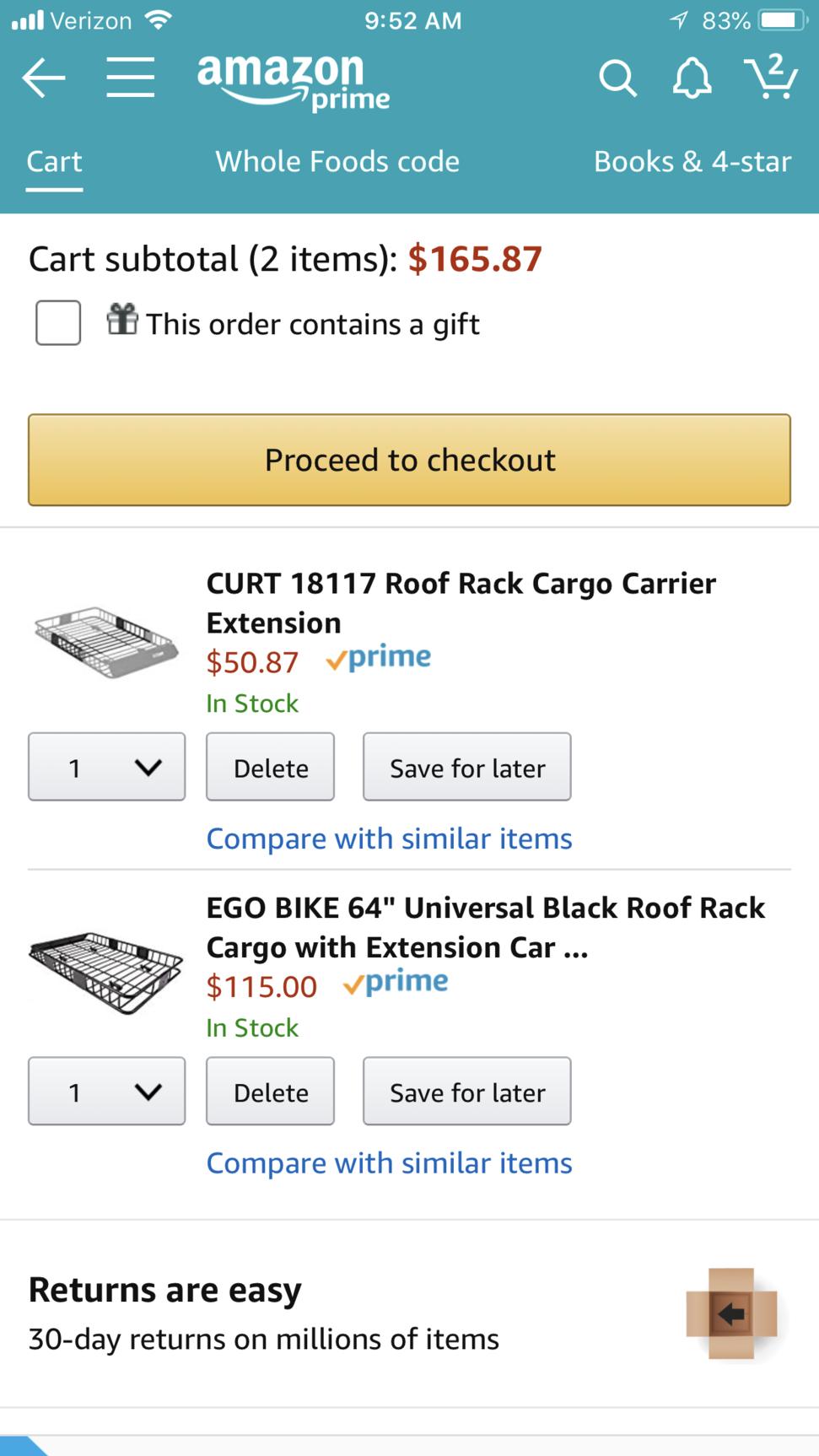

~$170 off brand curt rack
I got this today! Im going to see if it fits. Its off brand curt rack already extended 64”. And bout another extention
