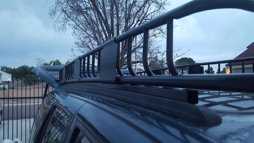

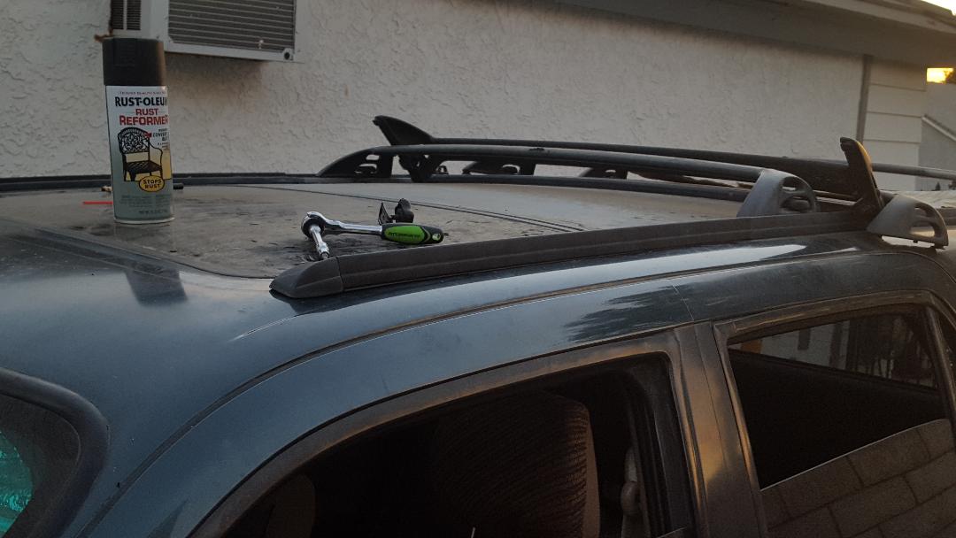

I extended my stock rack ~27" by adding cut down sections of a junk yard rack, that's as far as I could go before the front of the roof starts to curve down. It just barely fits around the sunroof. I used rivnuts/nutserts(M6 stock size) to attach it and butted it up against the stock rack. Looks like a stock rack if you didn't know any better. I wanted the extra length to support my kayak.

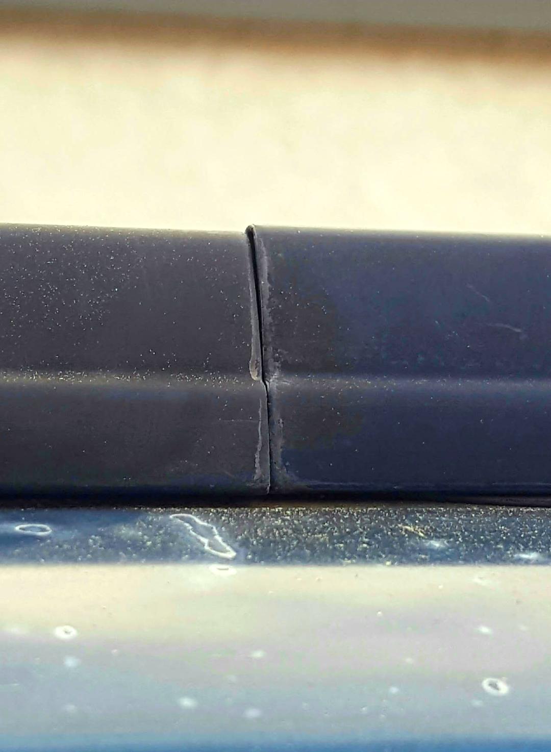

What does it look like where they meet?

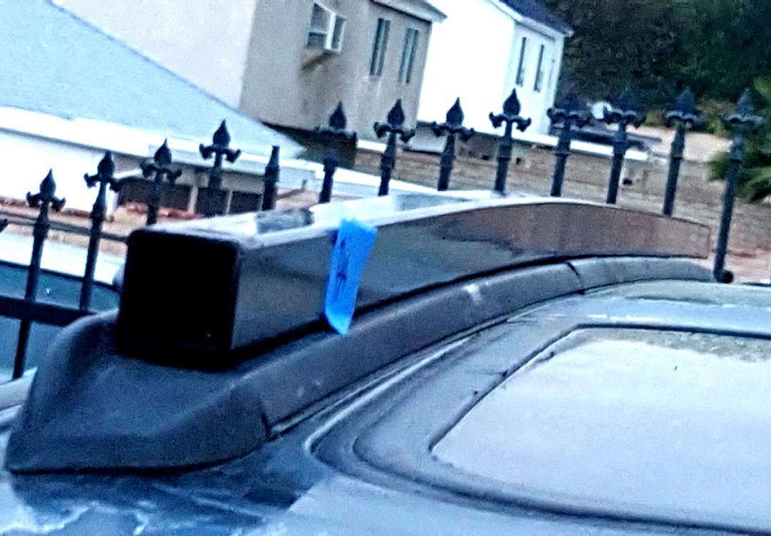

I just butted the two rails together and it looks pretty clean, at least it hasn't bothered me yet. I will try to get a picture when I get home tonight.

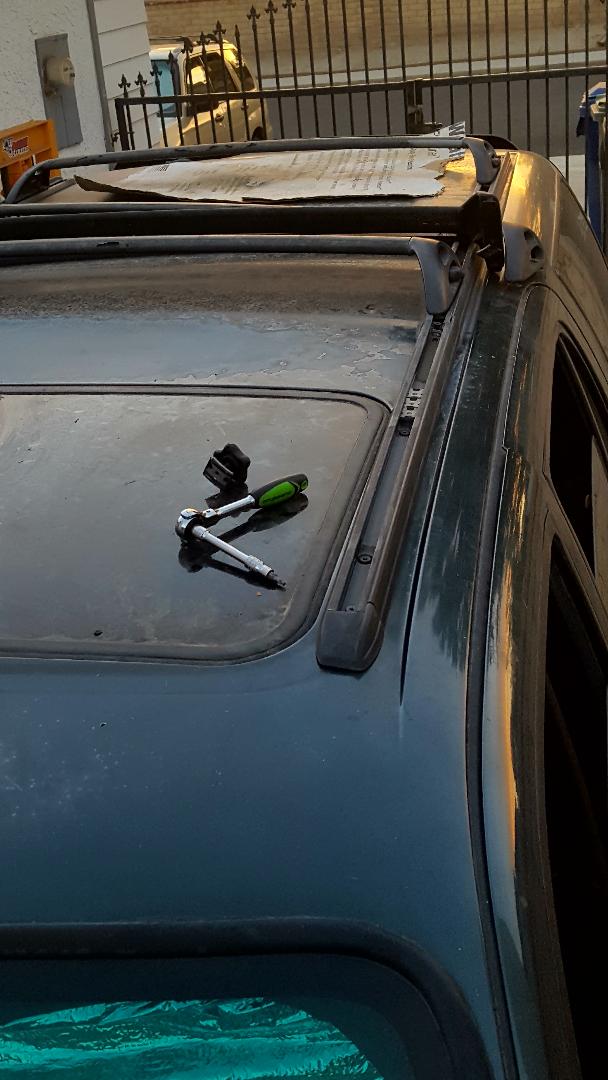

so... what my questions are, does this interfere with the sunroof function at all. how did you seal the new holes in the roof

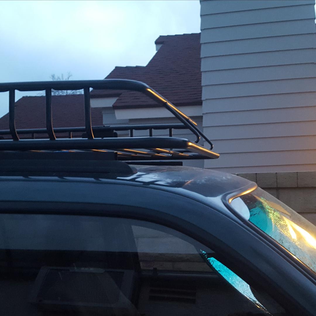

how did you get the wind deflector mounted like that ?
used 4 brackets that came with the rack. flipped them around. 2 brackets have a spacer, those are the inner ones. Used some weatherstripping along bottom edge so it doesn’t scrape the paint. Bolted up and adjusted.
Initially I had it the way everyone seems to put it but the noise was awful going down the highway cause of the wind. I was getting whistling and a terrible resonating noise. Once I flipped it all the noises went away.

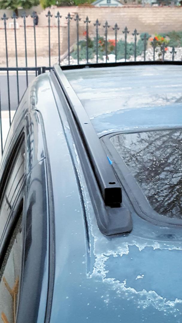

I kept the front section of the junk yard rack so the stock plastic caps fit in the front and the holes in the new extension piece lines up to where they didn't hit anything in the sunroof. I added a hole to the new rail where it butts up against the front end of the existing rail. There are three M6-1.0 nutserts/rivnuts in each new rail section, two use the stock holes and I drilled one at the rear of the added rail. I sealed around the rivnut/nutsert and the threads with RTV.

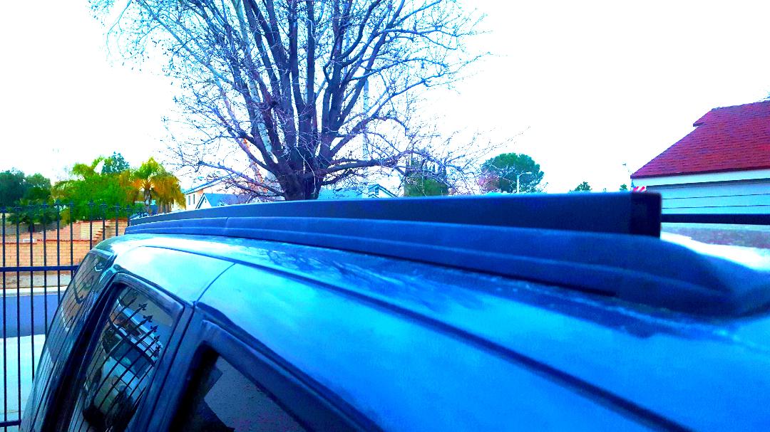

You can see that the full length of the roof is not flat so I have added a 1"x1"x 6' bar to each side of the rail and "contoured" them to match the roof line. The rack will sit on top of the bar then bolt to the roof rails using M6-1.0 ~3" long bolts to the existing sliding nuts that are in the stock roof rails, as the OP did in his design. I will try to get it together & some pictures later tonight.

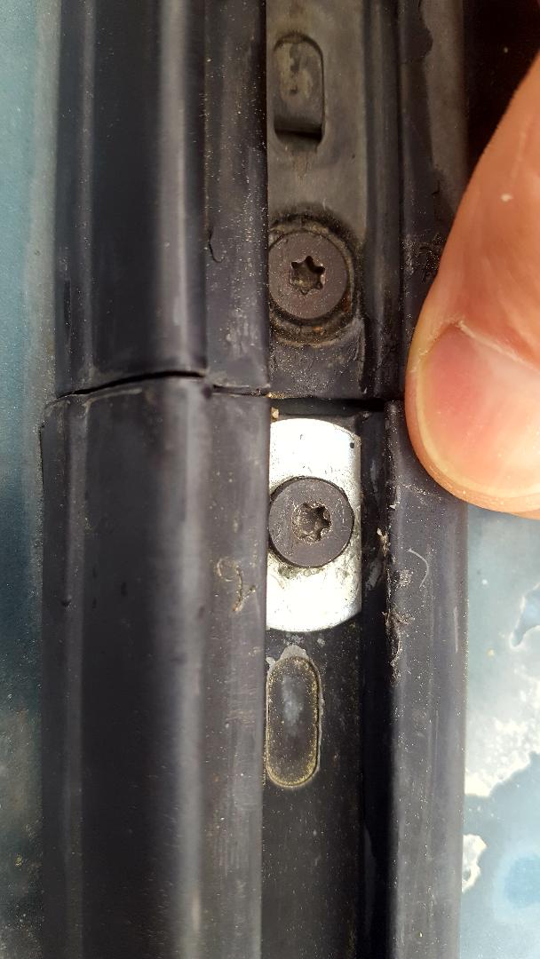

Added some pictures, bad ones as it's almost dark, one is of the rails butted together. The rack is just resting on top of the 1"x1" right now but it conforms to the roof curve pretty well, it will fit perfect when I bolt it down. There are 2 extensions and in its position it just clears the tailgate spoiler and that's where the front ends up, about the same pitch as the windshield.

There are actually 4 rivnuts on each side, 3 use the stock holes in the added rail section and I drilled one in the rear of the rail where it butts against the front of existing one. One of the photos shows a washer that I ground the sides off to fit in the rail channel on the added hole.
