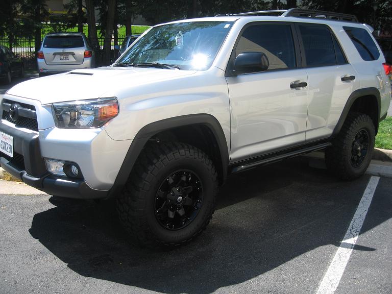

I've been a watcher for about a year and this is my first post. I have a 2010 Toyota 4Runner Trail Edition that I need to upgrade before I head down to Latin America with it for a couple of years. I've added some SW rock sliders which I love. I was also able to purchase the OW 2.5 lift kit just as they were going out of business. I should have it installed in the near future. I also plan to buy some UCAs, probably light racing or Icon. Additionally, I'm replacing my wheels with the MHT Fuel Offroad 17" Octanes. Overall, I think this will be a decent set-up.

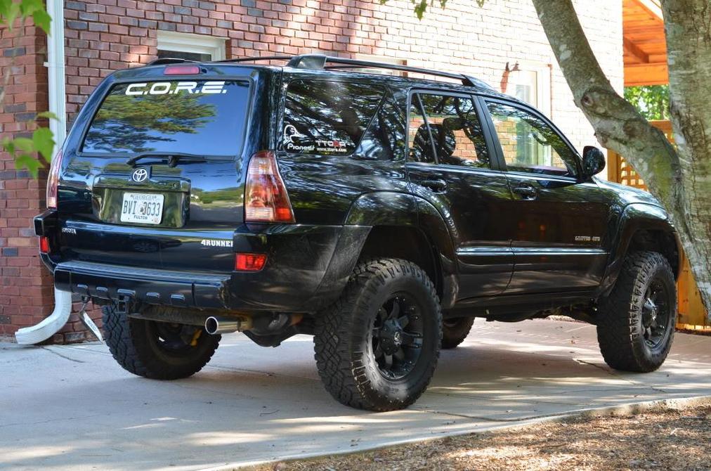

These are the wheels I'm going with on another 4runner, they're not too blingy. And at this point I'm leaning towards mounting the KM2s on them based on the recommendations at this point. Thanks again to everyone and your feedback.

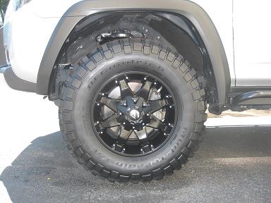

So my shop in NOVA quoted be nearly $1500 for four BFG KM2s. I checked out Discount Tire Direct and got them purchased for $1135 out the door, including stems. Definitely not a bad way to go for tires!
Now the tires are shipped, light racing UCAs shipped and rear coils shipped. I'm just waiting for the rest of the OW 2.5 kit to be completed and sent out...and the Fuel Octane wheels.
Thank you for the tire suggestions. So far I'm very happy with the results.
