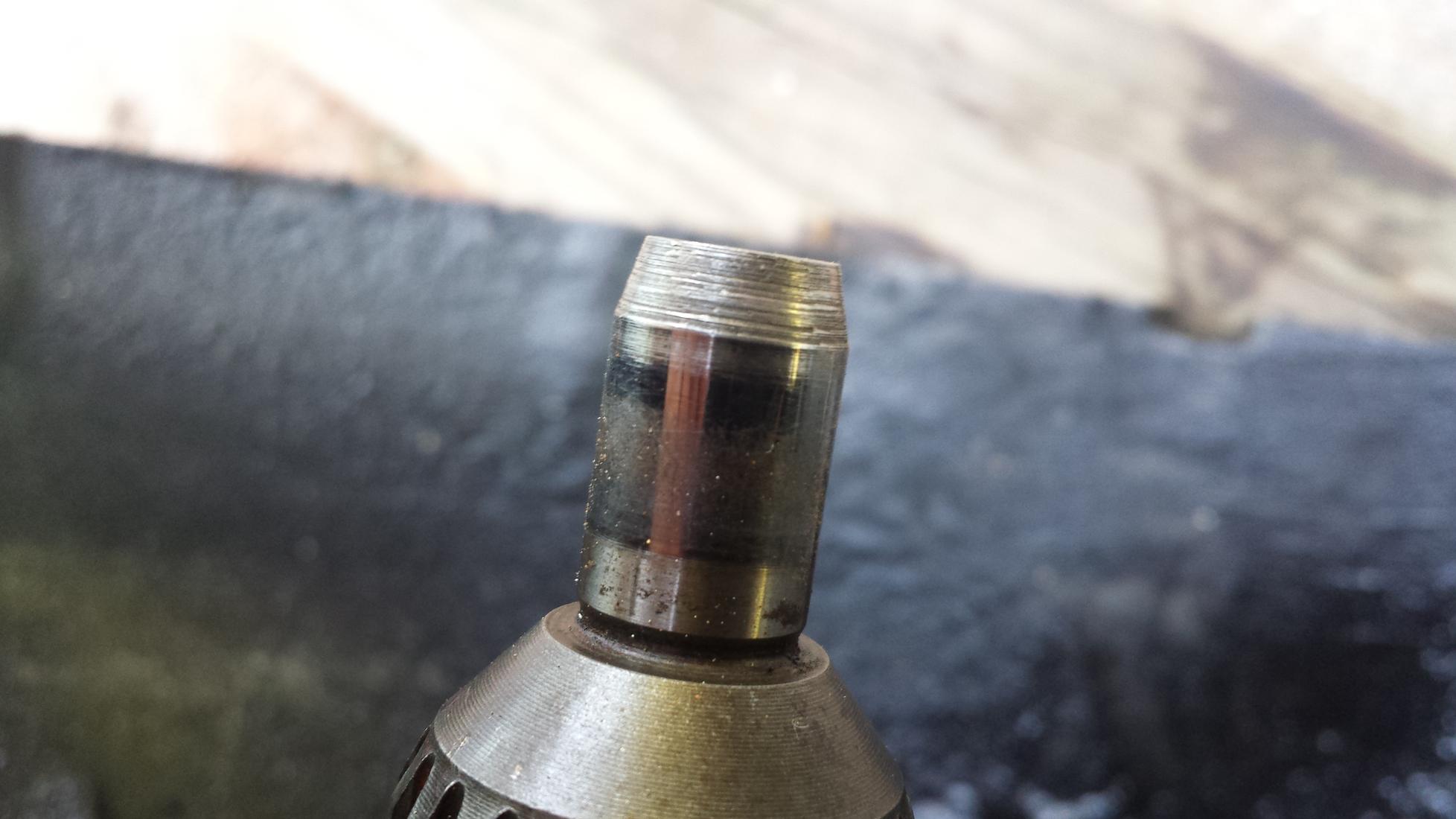

Let me clarify a little. After I inspected the TO bearing, which seems fine, I move to the input shaft. The tapered end is not smooth. Either it has tool marks from factory, or it is rubbing/grinding. The pilot bearing feels smooth and turns freely but not sloppy. I can see the end of the crank and it has matching tool marks or rub marks. I hope it's only TO but it was an awful noise.
The transmission input shaft should definitely not be contacting the crankshaft. Neither of those components should have any play at all fore-aft. If there is, something is Really Not Right™.
You could measure the distance between the crankshaft and the rear surface of the pilot bearing, and then compare that to the tapered end of the trans input. The two distances should be nowhere near the same.
Thanks KV, I'll take some measurements. Hard to think the TO bearing that moves so freely could make that noisr. And Hyde, I'll work on some pictures. Thks guys for the replies.

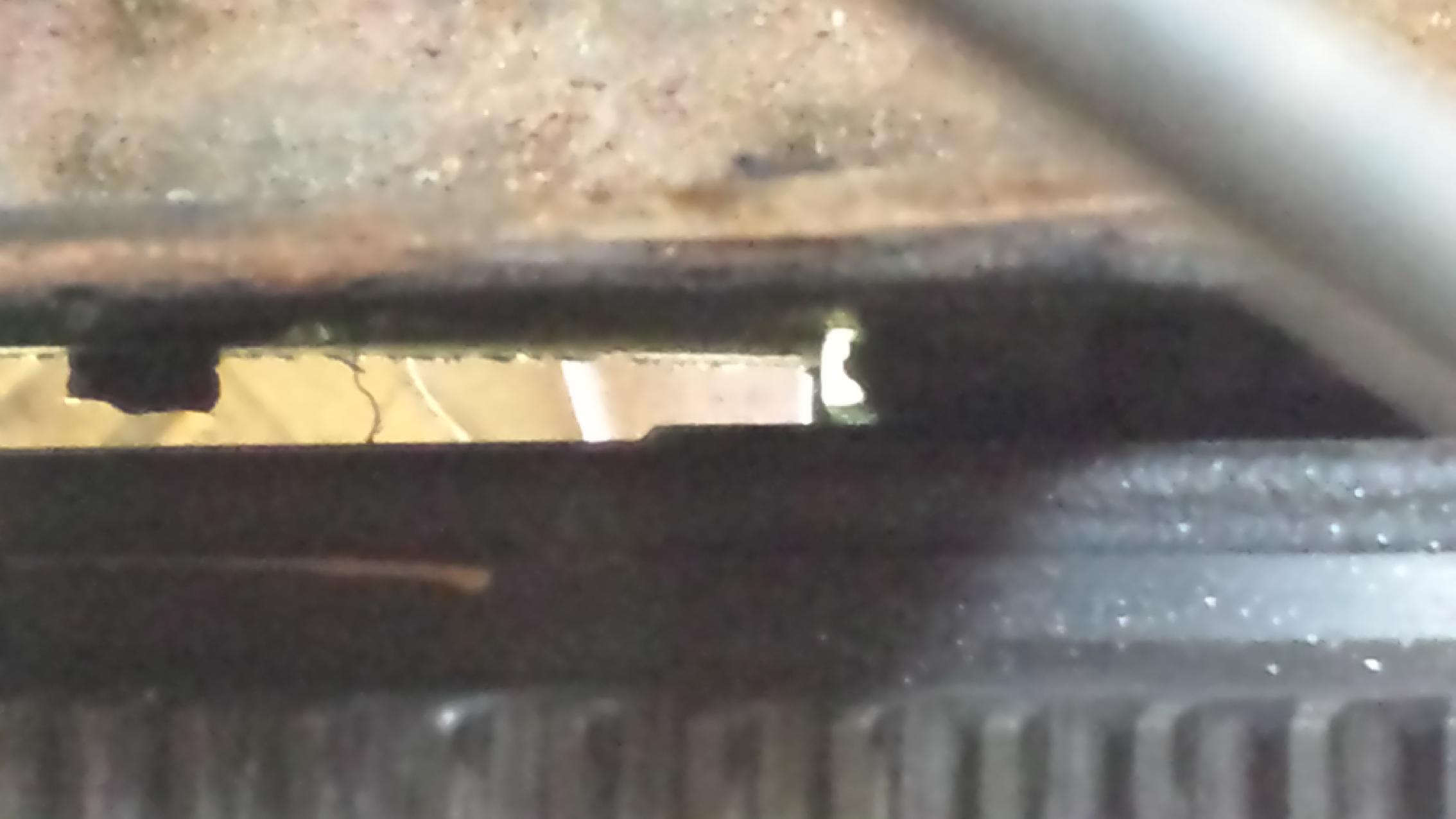

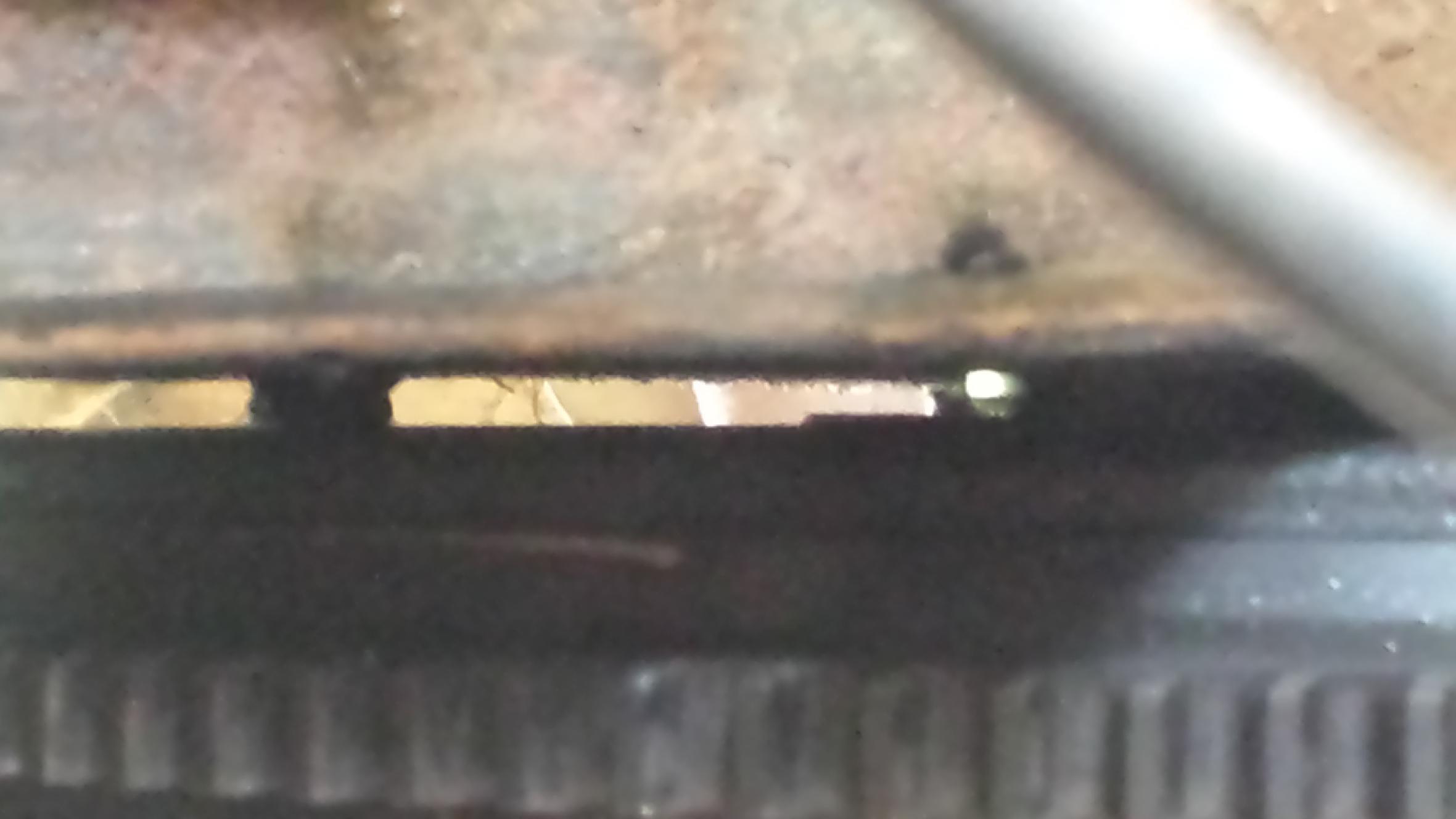

Ok. I dug a little deeper. I still think clutch/PP/TO bearing are all good, so I took some pix of input shaft end and the end of crank where it seems to be rubbing. As I grab the flywheel to reposition, it push in noticeably. I can grab the flywheel and move it back and forth about an 1/8 to 1/4 inch very easy. What can cause this? I don't believe it's anything good. Tried to post pix not sure how. The first 2 pix show the gap difference and the third one is the wear on the end of the input shaft.

The bottom of that picture is the flywheel and should be the left side. The flywheel can be push in until the gap is gone on that bolt head or whatever it is.
that pic is too close/blurry, I cant tell what im even looking at.
have you removed the pressure plate? perhaps the flywheel bolts are loose.
There are 3 pictures. The first 2 I was focusing on the gap between the flywheel and block. The picture needs to be rotated clockwise 90 degrees. The bottom should be the left. The difference in the light seen between the flywheel and block is quite noticeable.
Pull your pressure plate and friction disc out check that the bolts are to torque but I think that some how your crank is bent. That's the only real way to get marks like that as that part is inside the crank shaft

if what you are saying is true, the crank is moving front to back, the thrust washers are the problem. you may be able to drop the oil pan, remove the center main cap, and replace them. depending on WHY its moving, and how bad the damage is, just replacing them might be all it needs.
