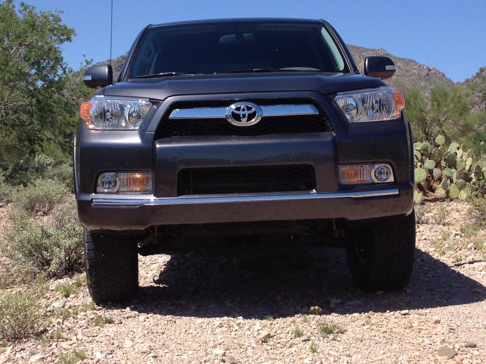

I had Load E on my 08 Tacoma 4x4 and they don't bother me. Ok so I spent the day in the desert driving it and playing a little, also I have some more on road opinions. Love it sums it up. Much stiffer which is want I wanted, no more floating feeling, it feels more like a truck but one with a good suspension set up. THe ATP's are super smooth on road, while driving on the highway at 80 MPH felt like the OEM tires, no humming but the Cadillac/soft suspension feel is gone which is what I wanted.

looks great! Your other post said you went with 884 front and 889 rear. Those 889's in the rear sure do give a ton of lift - any reason you went with those over something with a little less lift, say the 895E? got future plans to add some weight in the back?
I'm building this towards overland/exploration type rig, so yup went with those coils for the storage that will be going in the rear. Will probably have to go with heavy springs once I get a rear bumper and rack but that's down the road quite a bit.

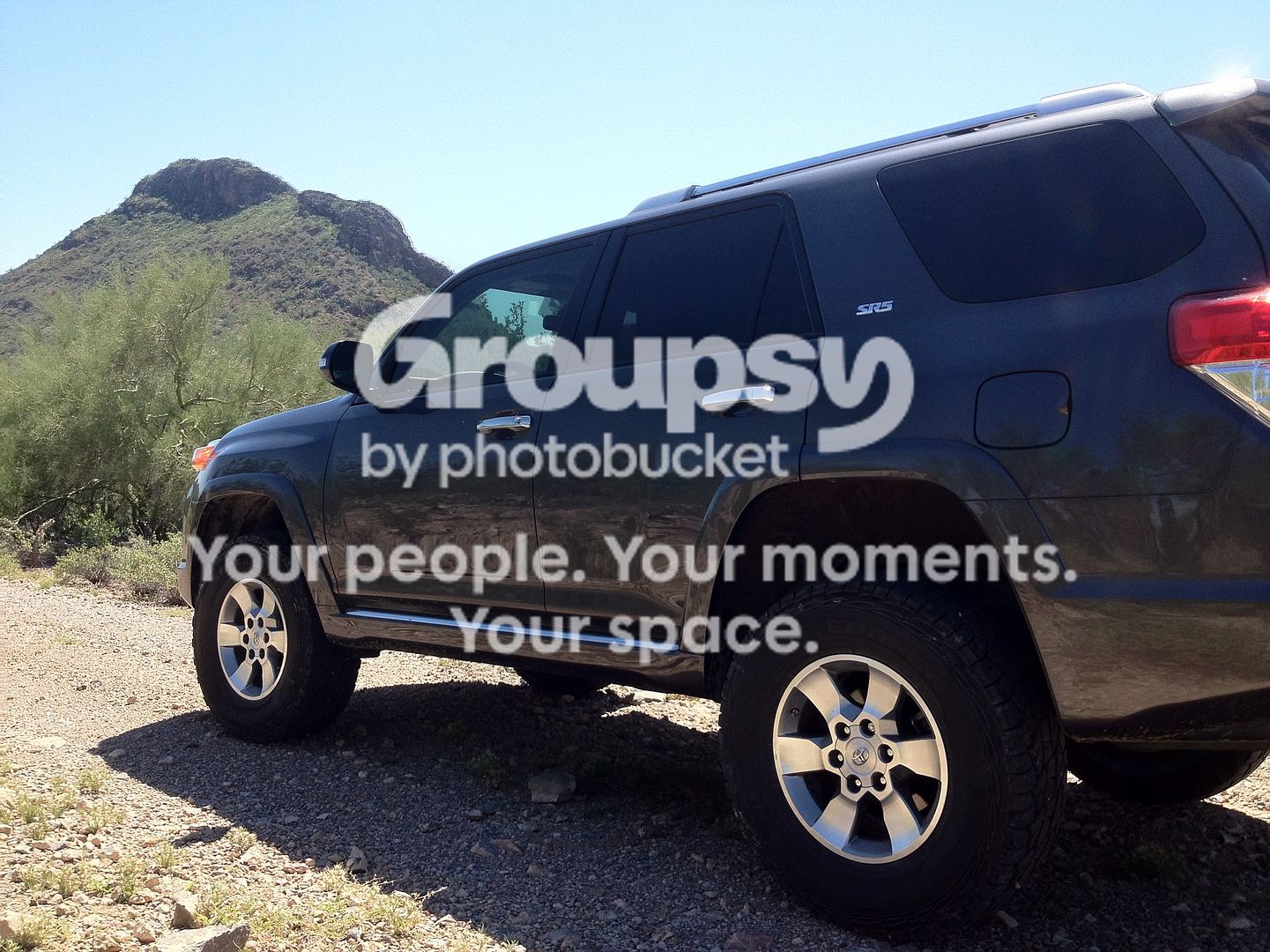

I had Cooper ATP 285/70/17 Load range E installed last night. I am bone stock and there's zero rubbing anywhere, but when fully compressed I'm sure it would hit. Just posting this so that other's who maybe don't off-road but want a larger more aggressive tire then stock these are available. My OME lift is being installed now so even off road I shouldn't have any issues.
I've only driven 10 miles on them so far and they are smooth, them being load range E I immeditley noticed a huge difference in the way she handles, much firmer, I only have 4500 miles on the truck right now and wish I had done this on mile one... Although these aren't the most aggressive tires I've owned they are way more aggressive then the Cooper AT/3. I had the Cooper ST on my 08 Tacoma TRD Off-Road and the ATP seems to be a cross between the AT/3 and ST. I will test the suspension and tires this weekend...
Should have gotten a tread shot but I was tired this AM and not thinking clearly... Cooper's website has zero info on these things and they are available only through Discount tire and I will include a better shot of the tread pattern so they can be compared to other tires.
