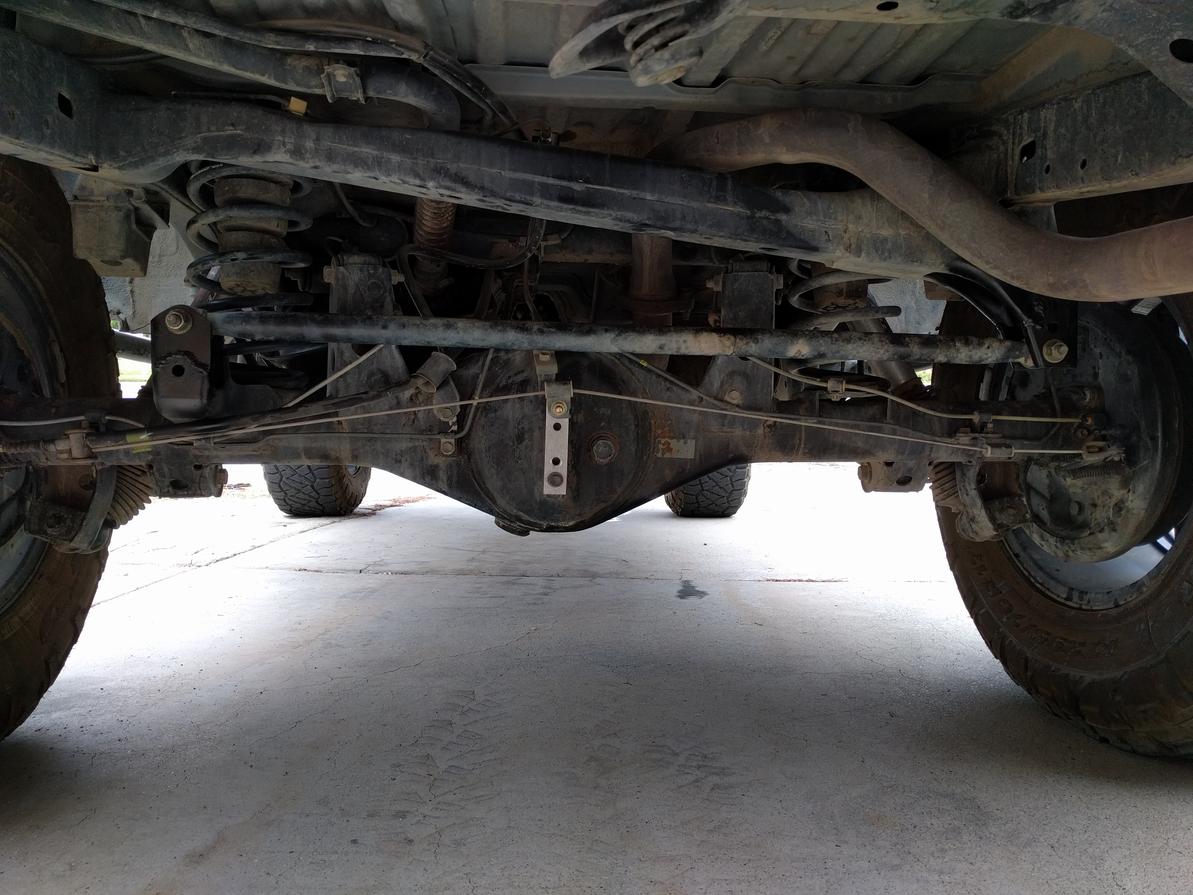

Here's a shot of my rig with the PCK. That's the stock panhard bar and it's almost perfectly flat. The kit is cheap and made by a member that put a ton of research into it before finalizing the product. After a lift it's the first thing everyone should buy. Ok, maybe the second right after Lower Ball Joints. lol
Kind of obsessed with how nice that kit is. Some damn good engineering on his part.

This is an issue some have and some don't. When you lift the axle is pulled to the passenger side, away from the tank. I've never had the issue with or without the PCK. Since the PCK re-centers the axle you'd think it would occur more with it for those with the issue. I haven't seen anyone report that in any of [MENTION=28464]eimkeith[/MENTION] threads though. My theory is that when the axle is pulled passenger side it wants to pull back to drivers side more when unloaded, thus causing the gas skid contact for some.

What is that crazy parking brake bracket on your axle housing? Thats not the normal lift extension.

As long as the PCK levels the bar as well as yours does, I don't quite see how that could cause an issue. Now, if someone put a longer PHB on, that makes sense to me.

Good question. That is the bracket the Toytec includes with there lift to extend the rear brake line down. I put on new extended stainless all the way around so I had no use for it in there intended location. I never did like the way my parking brake line sat below the axle housing in it's stock location. It's way to easy to snag it on things when wheeling. So I put it on the axle to raise the parking brake line. I had to loosen the bell cranks and back off the tension at the lever itself but now it's perfectly adjusted and my parking brake line will never catch on anything.
