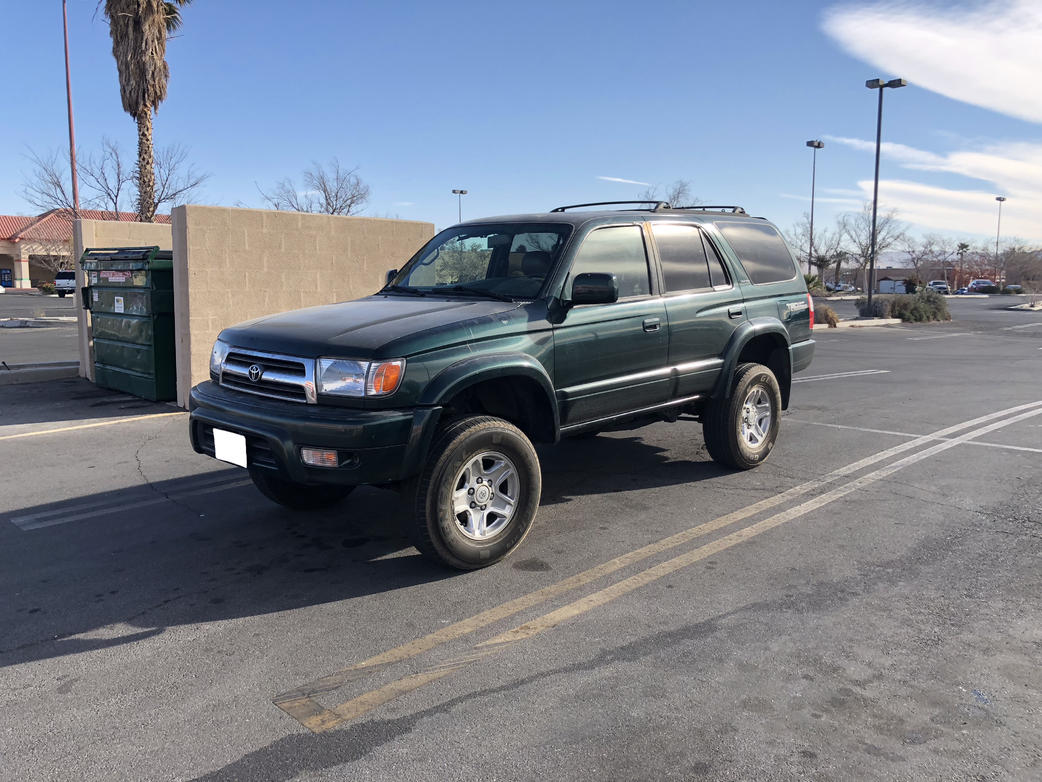

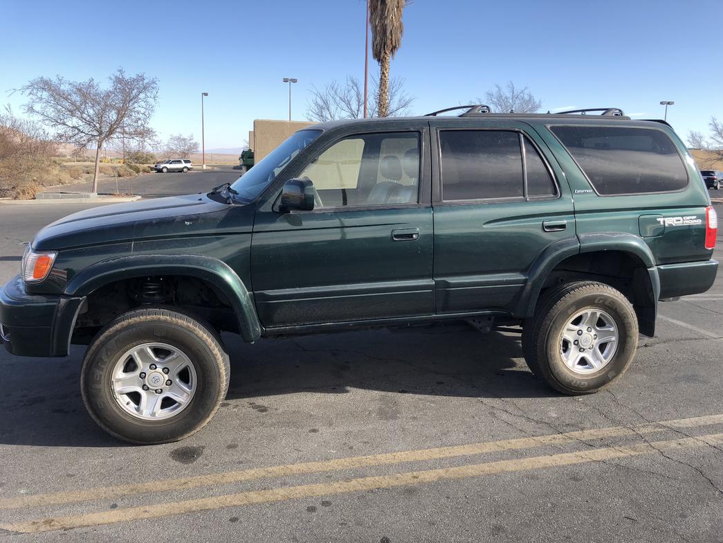

Installed 3" lift, now re-thinking that decision -- Opinions?
I am considering a lift kit but idk what I want I have looked at rough country's 3" lift but many say it nose dives and I do not want that I like toytec's spacer idea with 2" in the front and 1.5" in the back. I don't want a crazy expensive lift and nothing extremely high. I plan to keep stock tire size because I have just got new a/t's. Just wondering if there are better options than this.

Honestly, no idea. I moved to an area that has lots of desert and mountains, and wanted something to do some exploring. Current plan is to do some car camping as well. So realistically? Probably not. I don't plan on doing any extreme rock crawling or off-trail stuff.
As for how long to keep the car.... who knows. I'd like to think I can put an extra 100k on it (@ 200k now), but time will tell what life throws at me between now and then (life-wise. Different job, family, location, etc).

Where are the damn pics!!!!!!!!
And to answer your question: keep what you have, spend $90 on a panhandle bar. BTW selling used well incur a loss that could exceed the cost a PH bar.
