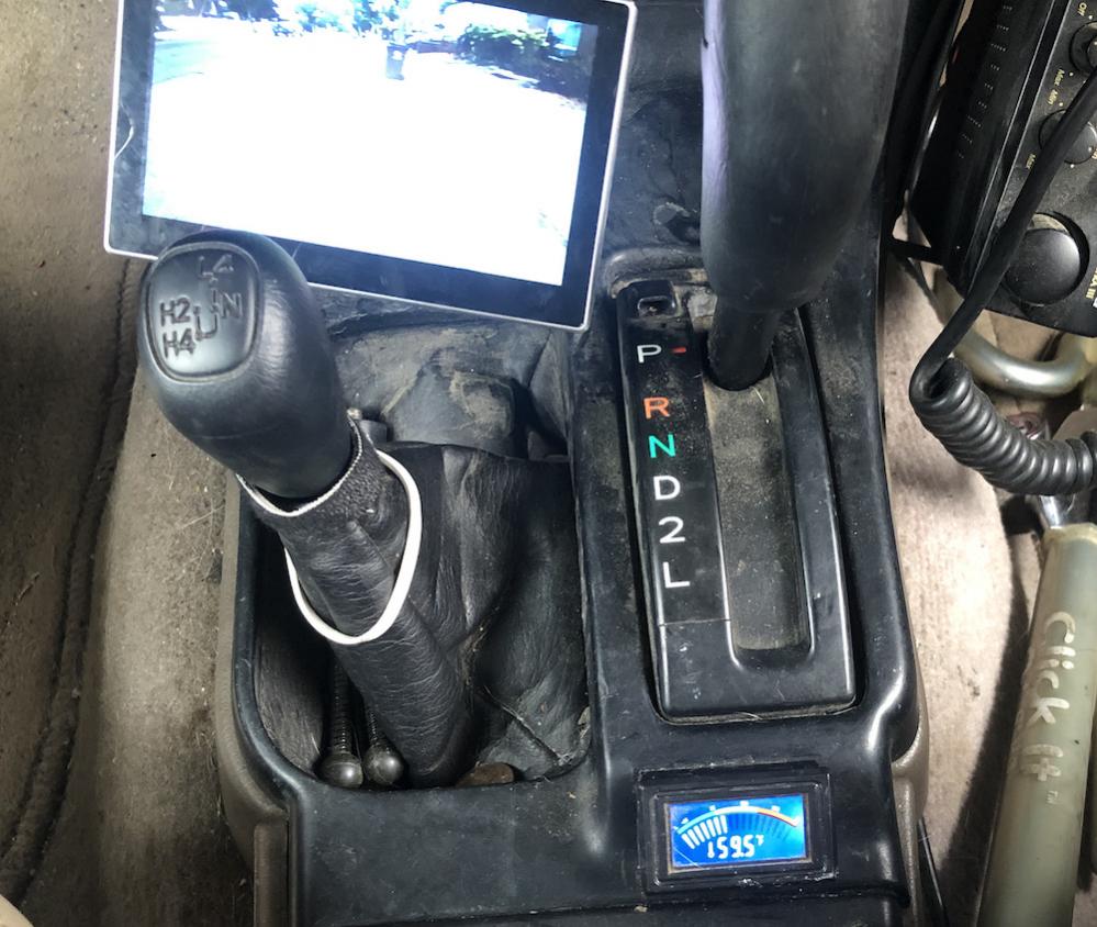

Yeah, send me the CAD. I'll see if I can print it out. I use one of these temp guages, not as elegant as your solution but it works.
