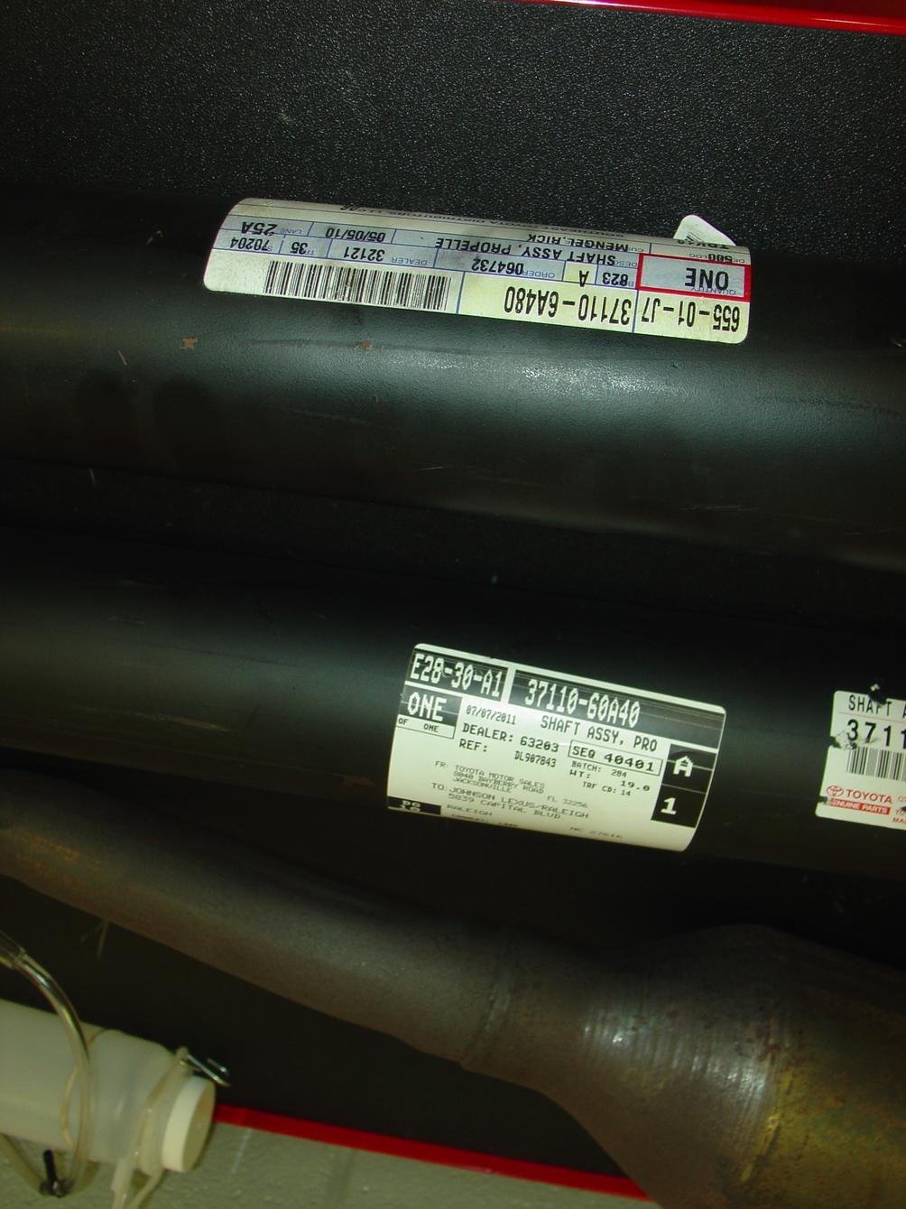

Here is a photo of both shafts.
The one on top is the shaft installed by Toyota as a possible fix to the clunk. It did not work.
Lexus has a more recent TSB that I viewed only at the dealer and based on that, I received the shaft on the bottom.
The Lexus part # is 37110-60A40.
Good luck.
