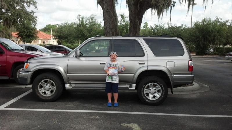

installed OME 906 rear coils
finished. 906's and billies. i like the lift as well as the handling. fronts coming soon! will i need spacers in the front with the 99 talls? also, the right rear is 36 1/4 and driver side is 36 9/16. is that normal for one side to be higher?
How are things going now? It looks like I'll have the exact same setup as you . I got my silver 4x4 2000 SR5 a month ago, with a 100% stock suspension on it. I'm replacing the rear springs with 906s (keeping original front springs), and Bilstein 4600s all around. I can't believe those factory shocks were still on it when I purchased it.
I'd love to do it all by myself, but I'm getting a mechanic to do the full installation. Considering we will have the exact same setup, is there any special advice I should give to my mechanic when he installs them?
Glad to see the tread is still alive. Yes the left side sits about a half inch higher. I have no idea why. I loved the setup with the 906's. Definitely better that the HD OME's as far as ride and I didn't want a huge lift for my wife to complain about. I sold my 4Runner about 8 months ago. At least the guys I sold it to sends me pics every once in a while. I ended up getting a new sequoia, nice but it ain't the same
man, do it yourself. it is not that hard nor does it take that long. well, if you can't, tell him to do it right.

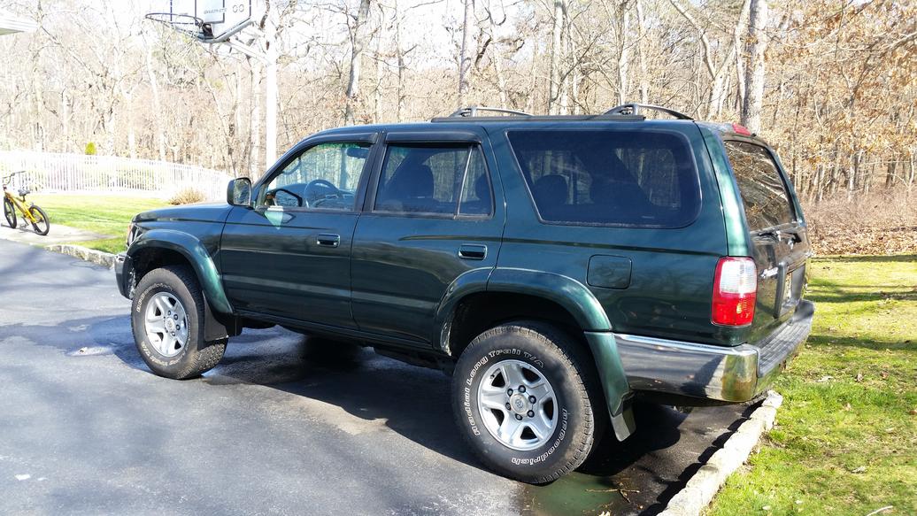

I'm running Tundra Bilstein 5100 up front on lowest setting and Bilstein 5100 in the rear with OME 880/906 setup. Love this setup. Just a little higher than stock without affecting any other suspension components. Definitely better than my 179,000 mile original worn out suspension.

I installed my 906 coils that had been sitting in my garage for a couple of months now and I call say I am very pleased with the coils so far. The PO had installed a 2" spacer lift in the rear and when I put the 906 coils in I was expecting a really firm ride like a lot of people had said but the ride quality was the same as the spacers but felt a lot more planted. I did loose about an inch of height but that will be fixed with some trim packers. I can't wait to see how these ride with the 2.0 fox shocks waiting to go. Definitely would recommend these coils to people who don't want to go with a full 3" lift.
