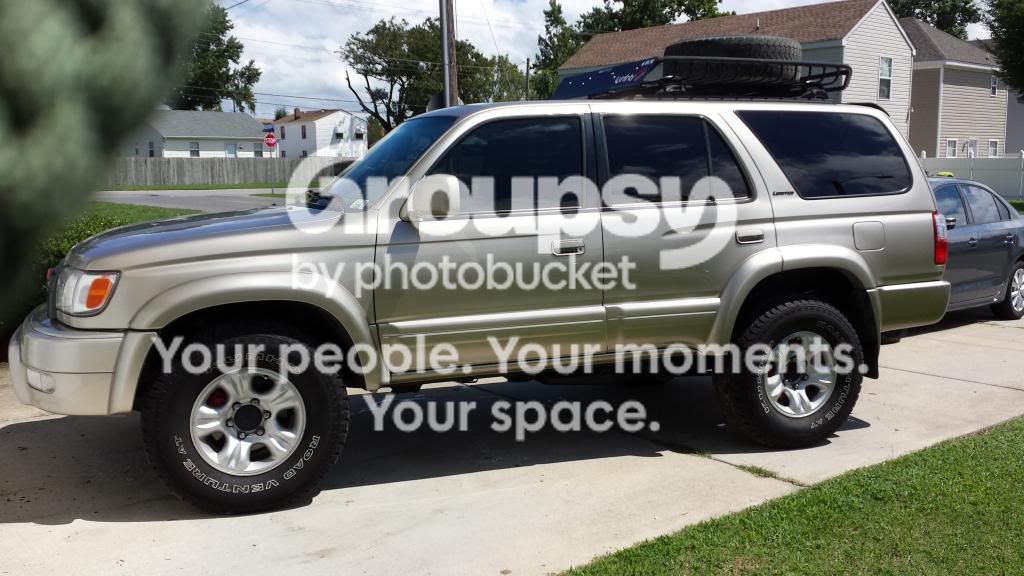

well I got the itch again and installed 906 rear coils with the stock 99 coils up front. Bilstein HD at the 4 corners. 2 weeks ago, I towed my jet ski for the first time with my 4runner. Stopped by my parents house on the way home and my mom says "how come the back is soo low?" that was enough for me. After much contemplation ......ie spend 150 for some new coils.....or save up the 1000 clams for the 3" ultimate toytech. Got 'em last night and installed them right away. went from 35.5 ground to fender up to 36.75. gain of 1.25. just what i wanted. Rides nicer too. Will post pics in the daylight.

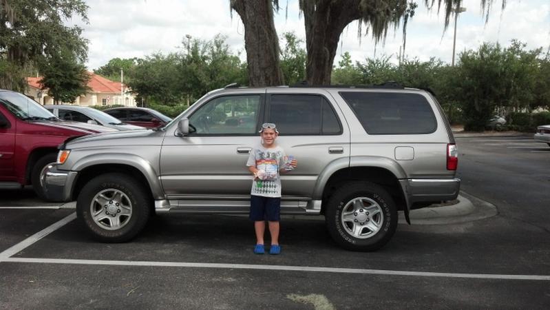

I have an 01 with 906s and everything else stock. Kyb stock height shocks were put on about 1.5 years ago and 906s went in about a year ago. Has rake but doesnt look bad at all to me. I AM gonna throw some spacers up front soon tho. I will TRY to post a couple pics tomorrow. I love the improvement of tbe 906s
hope this works. Stock height shocks on 2001 with 906s in the rear. About 1 year old so they r settled
Are those 265/75/16 tires?
I'm interested in getting those size tires, and the 906s for towing and less sag in the rear, so your pic would give me a good estimate of what mine would look like.
