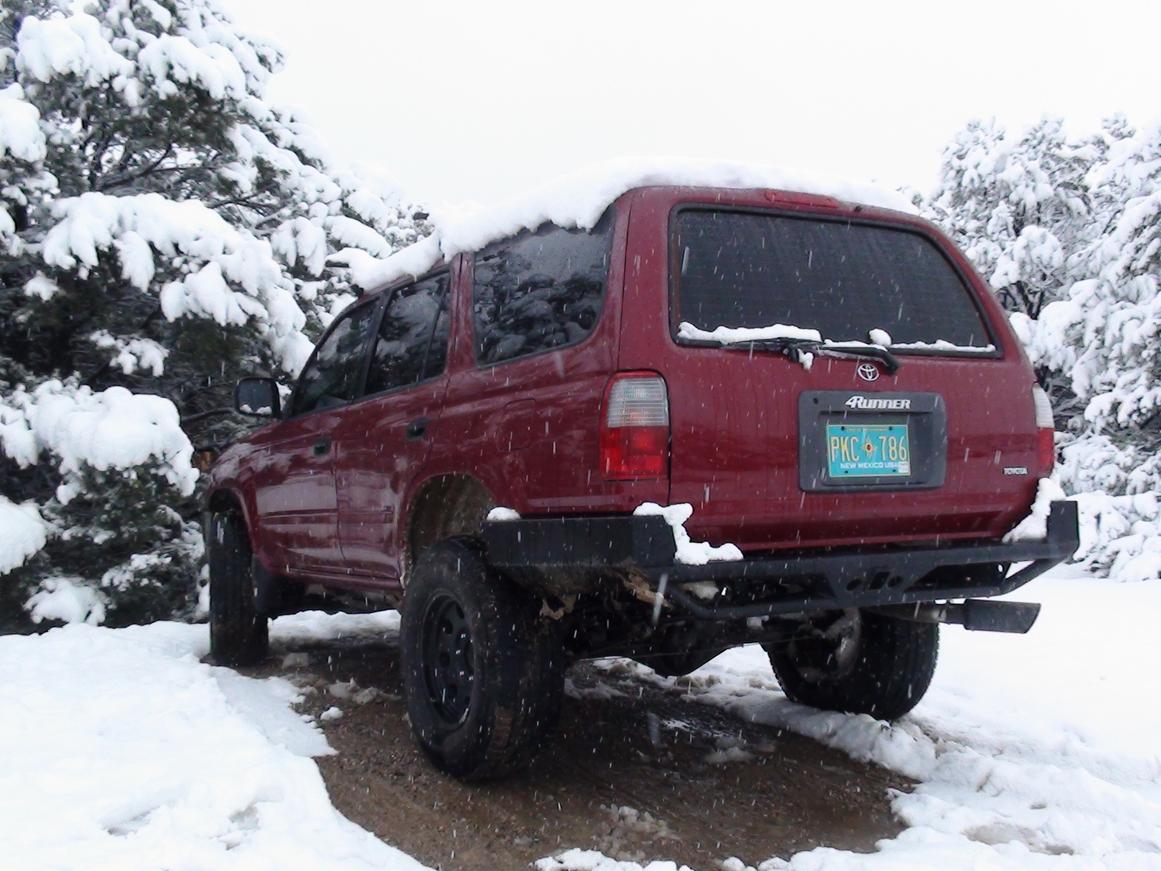

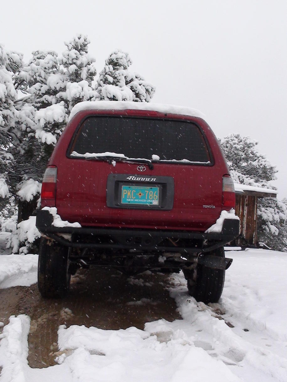

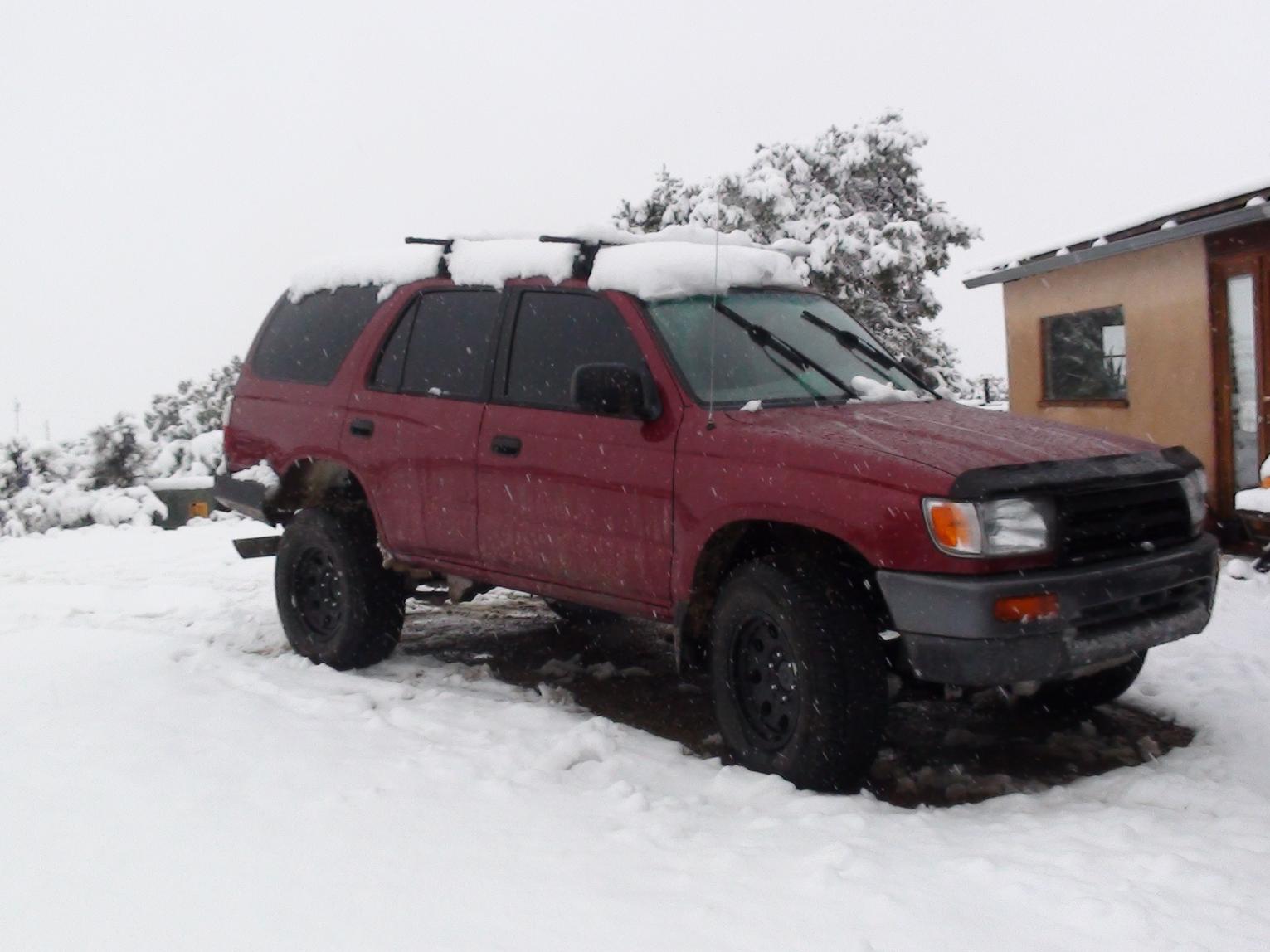

OME 906s and Icon 2.0 rears installed-killer ride
Got the rear of the lift installed yesterday; 906s, 10mm trim packers both sides and the used Icon 2.0 rears. Feels phenomenal on road and in the 6" of snow I woke up to (WTF?), still bumpy off road, but not too stiff at all. I love the combo at least for its first hours of existence.
I was at 20.5" mid wheel well to fender (no flares), now 23-23.5 inches, hard to tell with my unscientific measuring and parking downhill. Feels great, makes the leak in my rear diff more obvious.:rant:
I bought the Icon coilover adjustment key for the fronts that I'll try and keep at 2.5 or so for level or tiny rake.

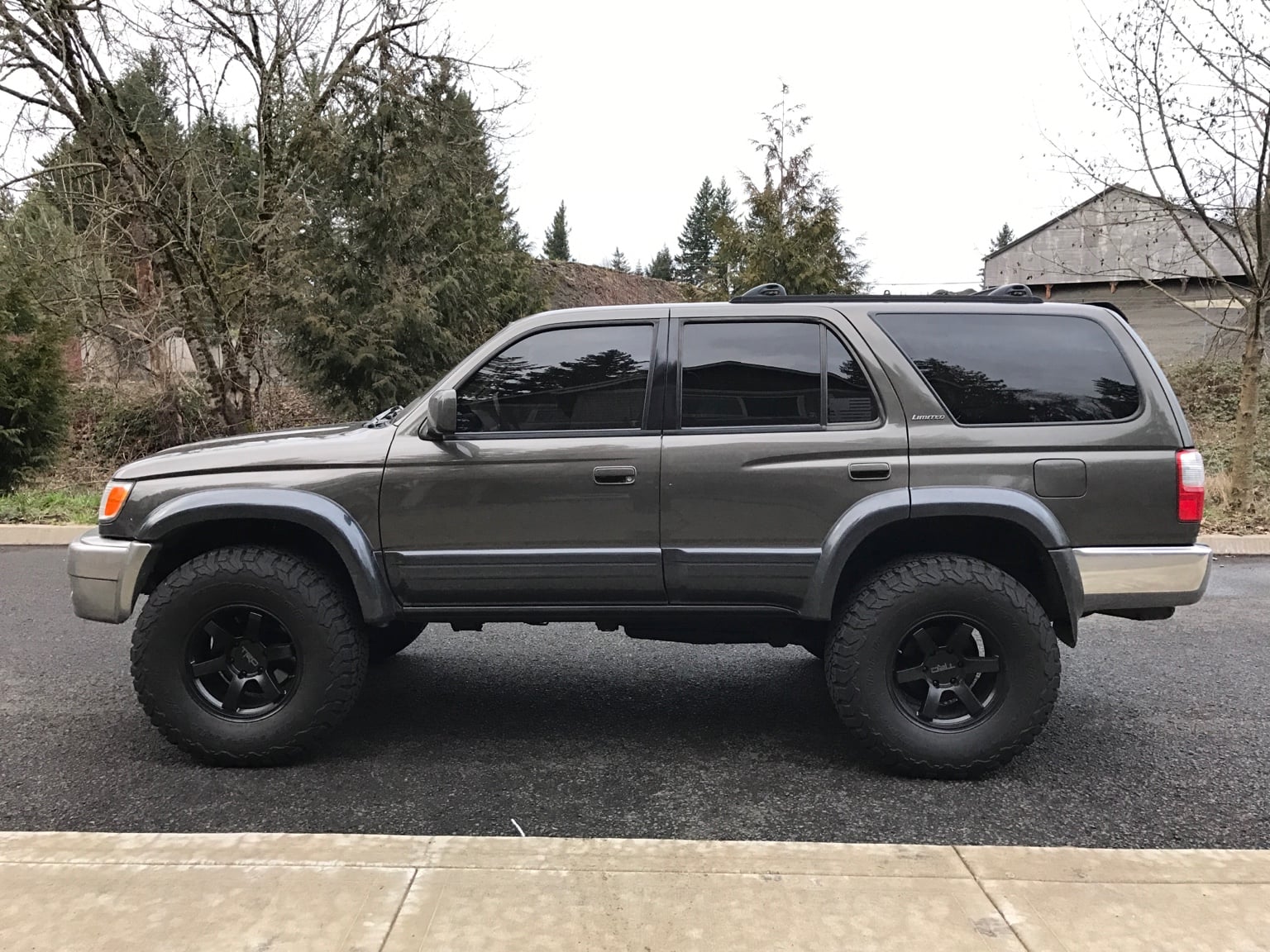

I like a little rake, and don't think 1.5" rake is excessive. It all depends how much lift the 906 actually gives you- obviously.
Some have reported the 906 being pretty firm- maybe even harsh- but the shocks have a huge impact on ride as well, so take that with a grain of salt.
I know nothing about the KYB, but I loved the Bilstein 5100 with my Superflex coils, and HATE the ride with Bilstein 4600- so I know first-hand shock choice is extremely important.
This is with my front fender 38 1/8", and rear at 40" even-
So, basically 2" of rake, and- personally- I don't think it looks excessive at all.
