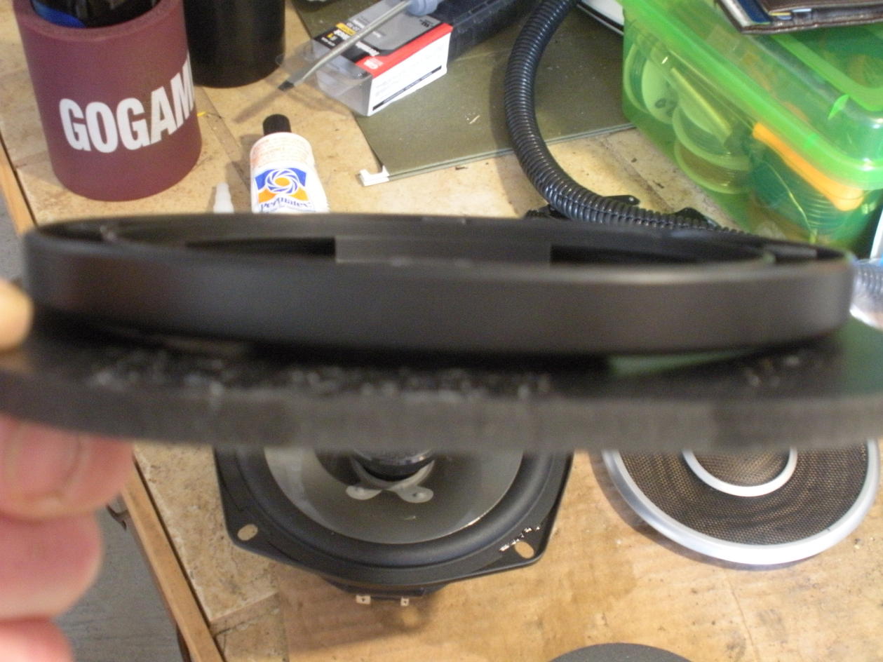

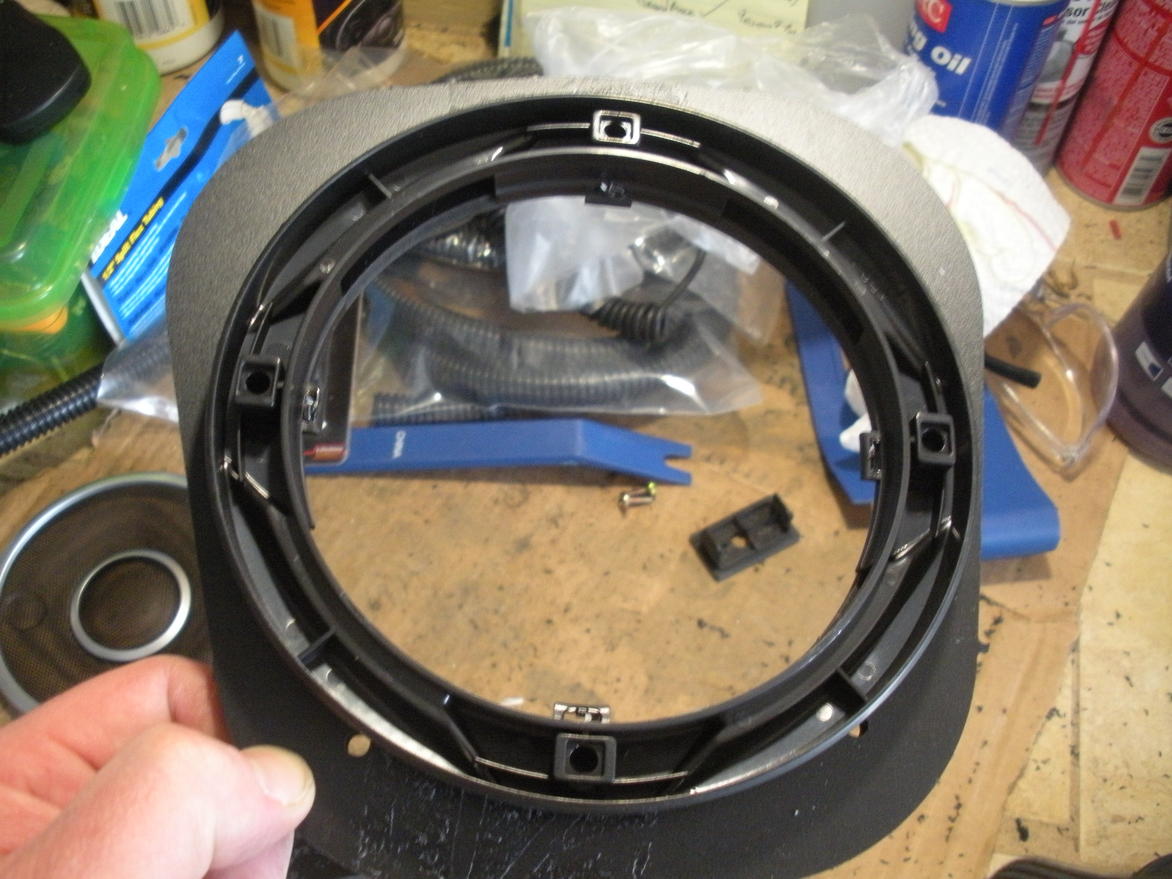

Like others have said, the fronts are pretty straight forward. I installed JL Audio C2s all around. 6.5s in the front and 5.25s in the rear. I used these (PVC Speaker Adapters - CNC Machined - In Stock or Custom Made) for the rears. They didn't provide enough clearance for the windows to roll all the way down, so I used the grilles that came with the speakers as a "spacer". Worked perfectly!!

Sorry for reviving a 2 month old thread, but just wondering if you ever got your problem fixed. If not, like what a bunch of other posters have said, go here, PVC Speaker Adapters - CNC Machined - In Stock or Custom Made. I purchased a pair of these a few weeks ago w/ a pair of 1/4" spacers to go along w/ the adapters. The adapters are the same size and shape as the original stock speaker housings and will fit 6.5" speakers. I purchased the spacers because my speakers depth was to big and was hitting the window rail. Just an FYI, with the 1/4" spacers, my speakers were still hitting the window rail and I should have purchased the 1/2" spacers instead. What my installer did was use foam tape to give it that extra spacing I needed to clear the rail. I couldn't be happier.
I posted some pics on this forum of my install. Here is the page where you can find it if you have any questions on how it looks like installed.
