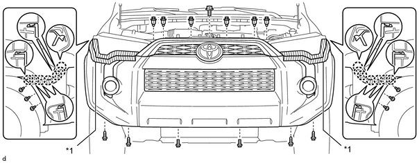

How does one remove the bumper? Also I got a valance for a decent price but it's damaged so if I put it on I would probably paint it. Besides the color accent I'm having a hard time differentiating between one with and without it to be honest.
Rear? Remove the bolts in the fender well, bottom side of the bumper & on top right in front of the cargo area. Lift the cargo holds a bit so you can pull. Then gently pull on the bumper fascia. Get one side up & then move to the other side & pop it loose. It's simple you can't really screw it up unless you pull hard on the bumper with a bolt still attached.
Sorry, the front. But I imagine it's similar. Thanks!

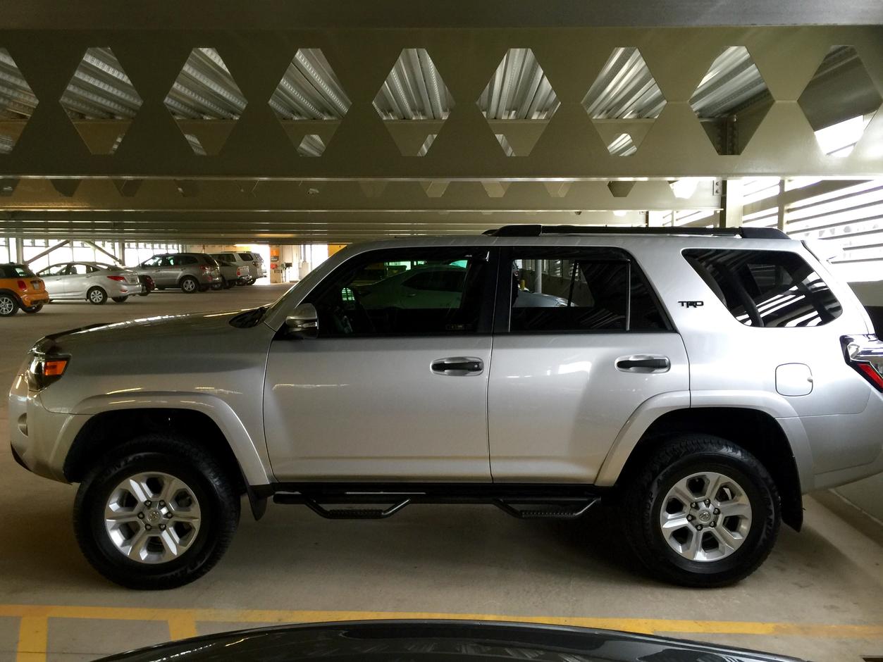

'13 Trail door handles
Always wondered why the '15s have color-matching handles..
I decided against dip, and went the extra mile to make it legit. I ordered '13 Trail Edition door handles/bezels. Install was easy, just time consuming. More info in build thread.

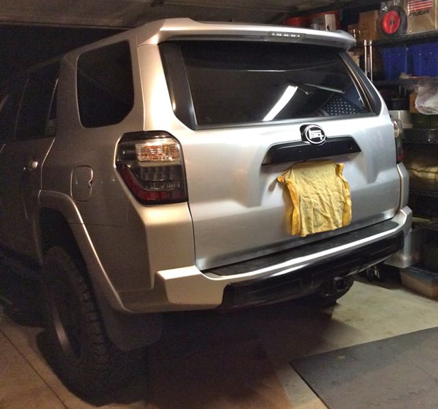

Here are the pics I promised.
Thanks for you help/links/advice.
[MENTION=119618]Hook Em' Horns![/MENTION]
Nice, it's a totally different truck!
I'm kinda liking the naked rear handle panel look, and the custom TEQ badge is a cool addition.
I know you're on cloud 9 right about now, and have probably been cruising all day; enjoy, it looks great!!
\m/

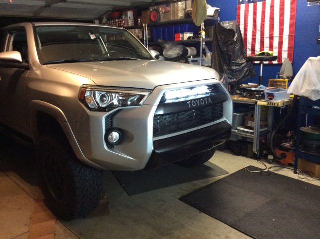

Light mounts.
Looks great. Is the lightbar mount custom? If not, where can I buy the mounting kit?
Man, I thought you read the entire thread
Check out BradBrad619 thread on his super awesome light mounts that go in the lower grill. They are super clean, reasonably priced and I think I would have went that route if I didn't use my ghetto fab Home Depot mount.
http://www.toyota-4runner.org/5th-gen-t4rs/211930-2014-2016-behind-grill-light-bar-mounts-2.html
Here's what I used
Home Depot fabrication.
http://www.toyota-4runner.org/2213196-post179.html
