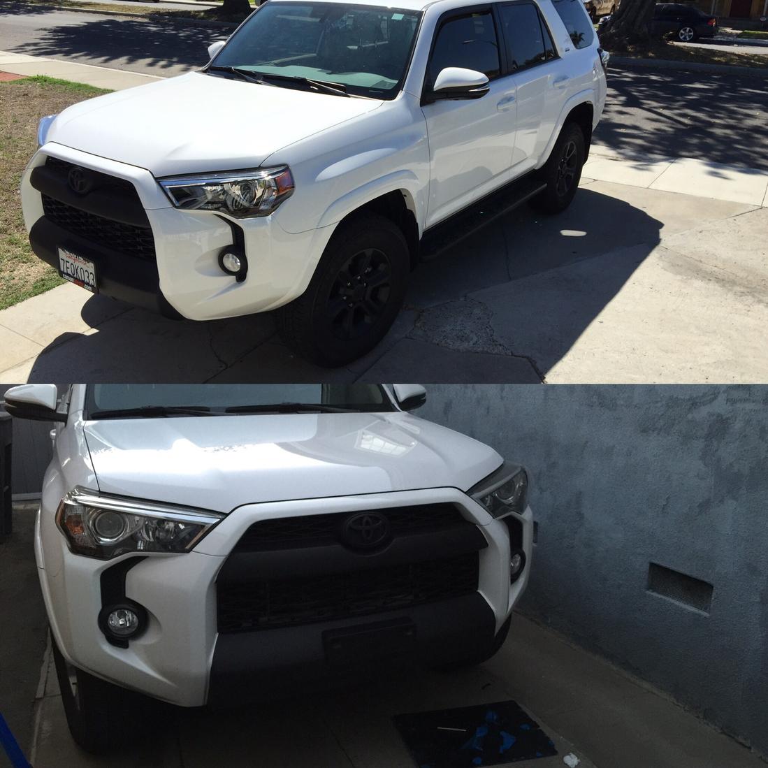

Step 1: Acquire TRD Pro Parts
Step 2: Take off front bumper
Step 3: Use dremel to create slots. There are 13 indication marks on the bumper.
Not the finest craftsmanship.
Step 4: Install front valance panel to bumper using clips
Step 5: Put back front bumper
Pretty Easy! Hardest part was taking off the front bumper.
