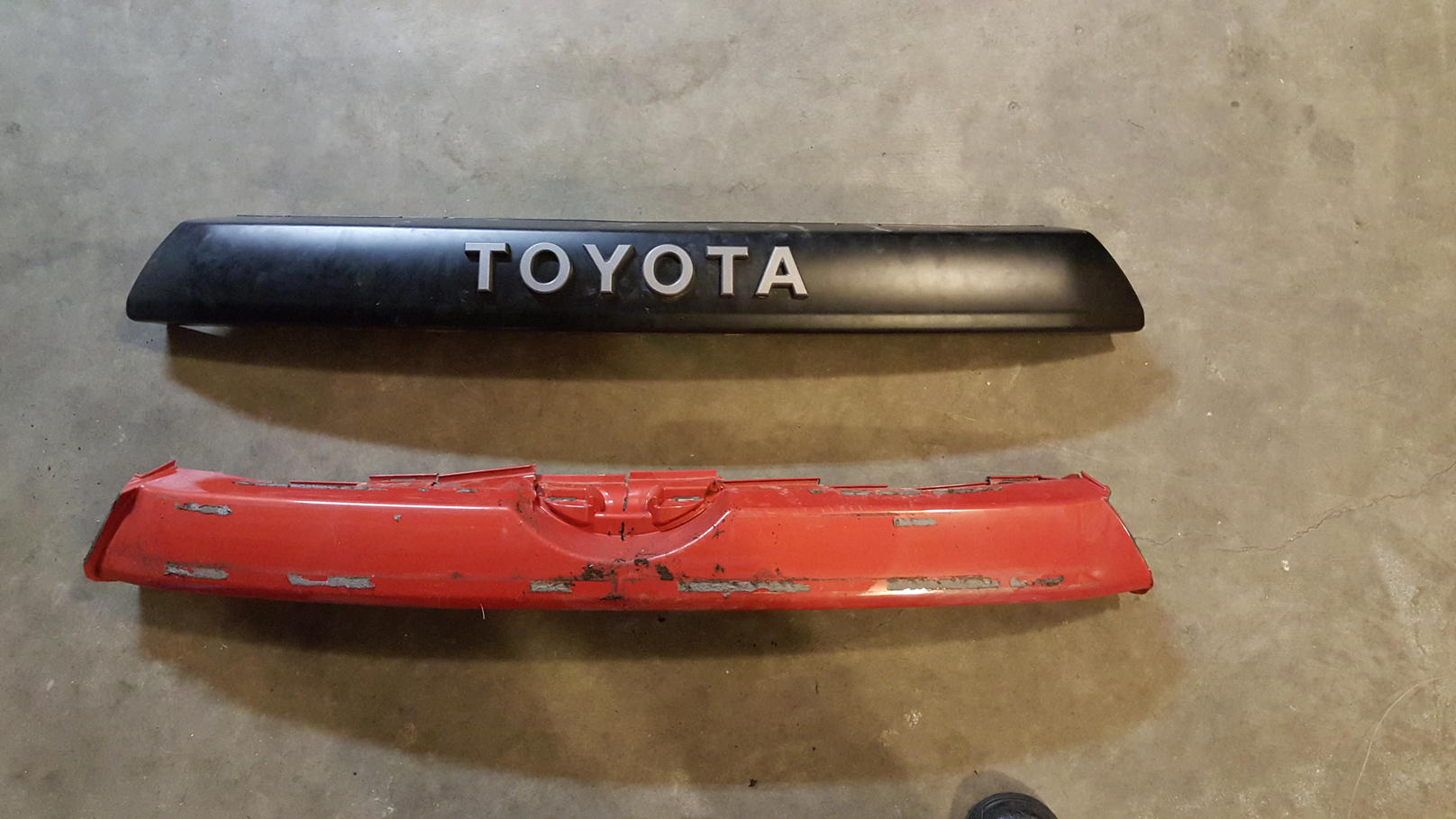

This is crazy but I received my used TRD Pro garnish. It is still attached to the bumper panel(it was cut off). I've been trying to remove the garnish. The tape is on strong. The garnish will break for sure if I pull on it hard. I spray a crap load of goo-gone between the garnish and bumper piece letting it saturate. Gonna hit it with a heat gun and hopefully I'll be able to gently pull it off.
Warm the piece up slowly and take your time. Just a little bit of pressure with constant heat and it should pull right up.
No such thing as gentle. Hit it up a dryer, and constant pressure to get this biotch off. Not hard, just patience...

Yeah ya did!
Now I need to get mine off...
looks like a lot of work to get off.
Did you get his lower valence as well? [MENTION=117117]Seattle206[/MENTION]
Very do-able, just a good soaking of WD-40 or Goo-Gone plus a heat gun/dryer. It'll will break for sure if you try to pull it off too hard or end up cracking the garnish paint.
I have his lower valance too, its in pretty rough shape, scuffs, cracked paint, tabs are broken, and a crack on the corner. I'm gonna clean it up, bondo the crack, sand, secure those broken tabs, repaint it in a satin semi-gloss black to match the garnish. The TRDP valance is a much glossier black compared to the garnish.

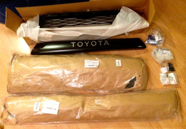

Got my package today.
Tracy Griffin @ Lithia Toyota of Springfield was super attentive and even packed the parts together to decrease the shipping cost. If I have to do it again I would buy from them. There prices are super low and were even lower with the 12% off coupon they gave out for black friday , cyber monday.

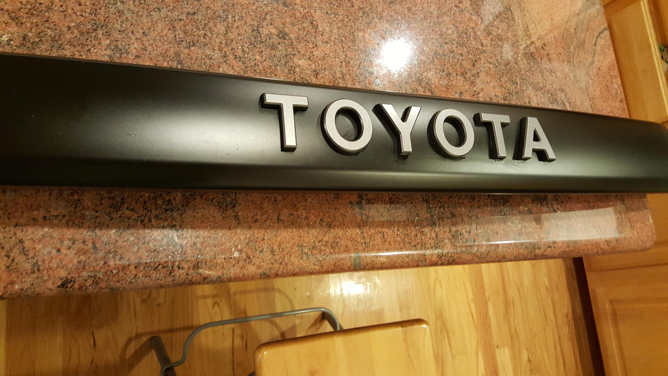

are there any bumps or spacers under the toyota wording?
I'm contemplating getting one of these, but not digging the logo.

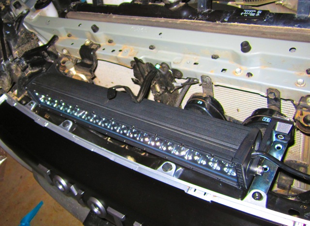

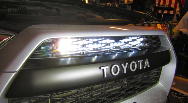

Finally got around to installing my PRO grill and 20" LED bar.
I mocked up the mounting and all I needed to do was to drill the holes a little bigger in the spot that I used to mount onto the metal black grill support using home depot L bracket .
Once the extra vertical material of the bracket was cut off I drilled holes for the light bracket to mount to the home depot L bracket.
I used red Loc-tite on all the screws and will take it for a weekend drive to see if anything will rattle loose before I do a final mounting/alignment.
Still deciding if I want the power to be on constant, accessory or high beam.
