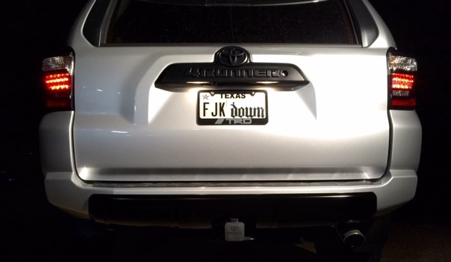

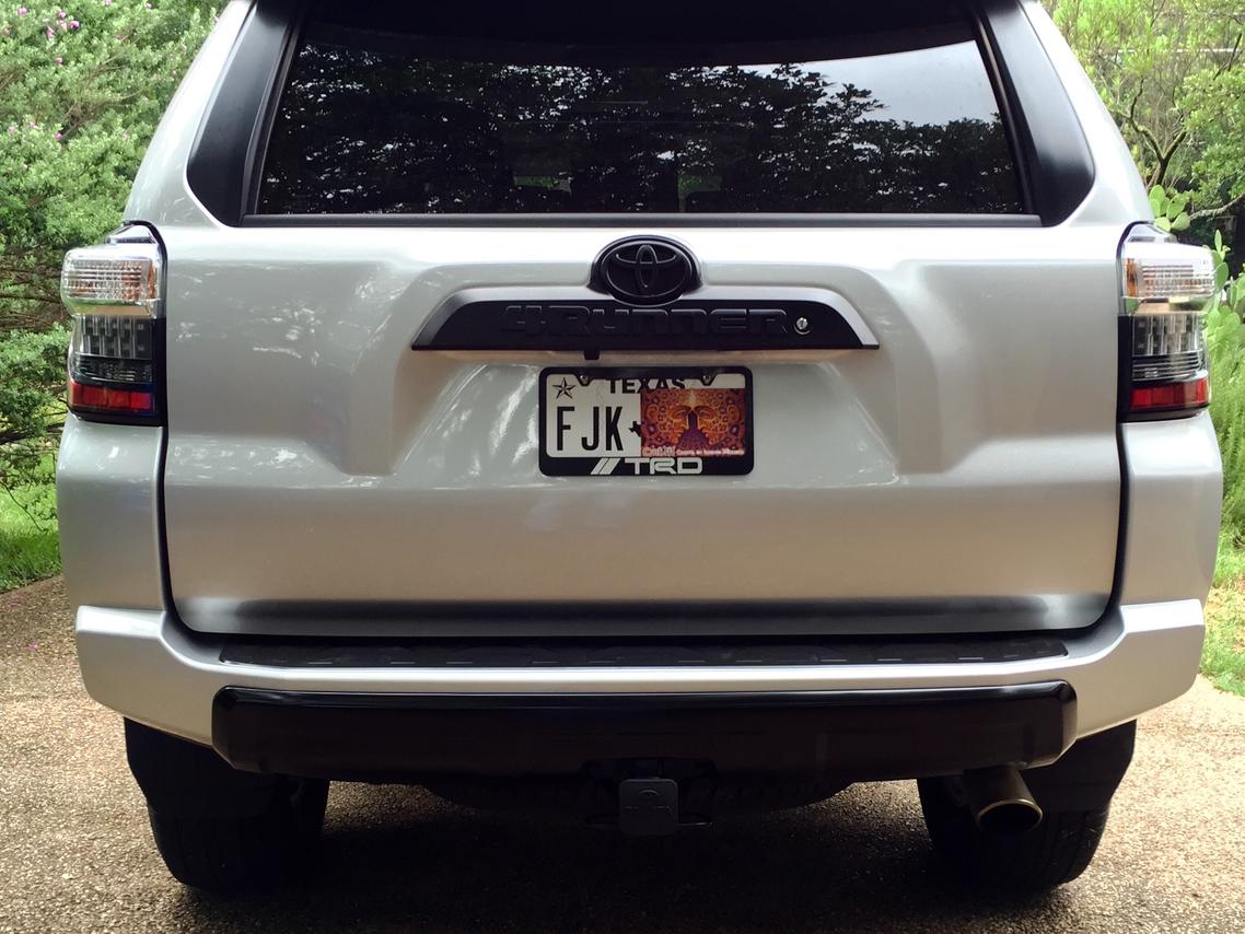

Swapped the rear hatch handle panel out for the TRD/TE panel (black), and then applied the blackout kit.

I'm confused - isn't the rear hatch panel already black on the SR5? I'm currently overseas and can't look at my truck to check, but I could've sworn my '14 SR5 rear hatch looks like the 1st photo you posted.

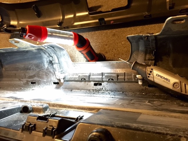

Also, thanks for the info and documentation in this thread. I will probably eventually do the TRDP grill mod, but think it sort of needs the front and rear valences to complete the look. It's nice to know that the bumper removal isn't too difficult and that the slots are pre-marked from the factory. When buying a Dremel, do you need any specific kind of bit? I don't own one yet, but it's a tool I've been meaning ti pick up for a long time anyway. Does it have some sort of blade attachment, or do you just grind through the plastic with a sander or metal file or something?

The handle panel or whatever the piece is called that has the 4RUNNER emblems on it is body colored on the SR5's and is black on the Trail and TRD Pro's. This is why I have not blacked out my emblems yet. Still not sold on the black emblems on a black background. I almost want to swap mine out for a silver SR5 one, almost...
Ah, my SR5 is black, which explains why it already has a black panel.

I was told to use a bit that has a twist in it for plastics, and the Dremel I bought came with a starter pack or whatever with a ton of bits, and the needed bit was included.

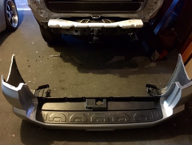

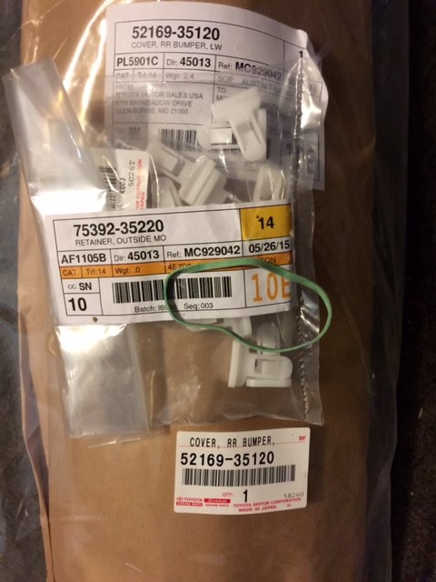

TRDP Rear Bumper Cover
Start by removing the screws in each wheel well and pop the clips out.
Make your way along the bottom of the bumper, removing all screws.

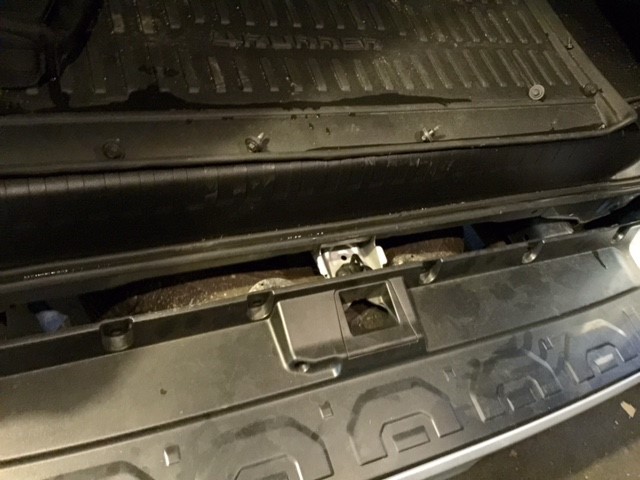

Remove screws on the top side of bumper (tailgate area).

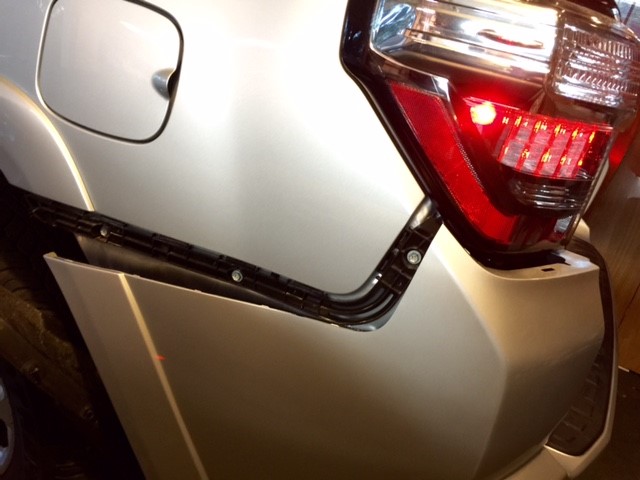

To remove bumper, start in the wheel wells.
Pull the bumper (snaps) downward on each side.
Separate the tailgate area.
Remove bumper.
Wipe down/clean the inside of bumper, revealing the hole cut markers.
Put the Dremel to the cut markers.
There are 15 holes/cuts, but only 14 of them need a fastener (the one in the middle near the hitch area doesn't need one)
Slide bumper cover over the bumper and apply 14 clips where the cover's arms stick through.
Put bumper back on truck and apply screws/clips.

Honestly, removing either bumper is easy, and the rear one is super easy. I noticed the area where the rear bumper meets the side panel wasn't aligned yesterday morning, so I took it off to fix it and it literally took me about 7 mins to remove. What I found was one of the tabs that snaps into place was folded down, so I used a rubber driver to hold the tab in place and guided it into the groove it snaps into...FIXED! Put the bumper bk on in same amount of time..job done.
