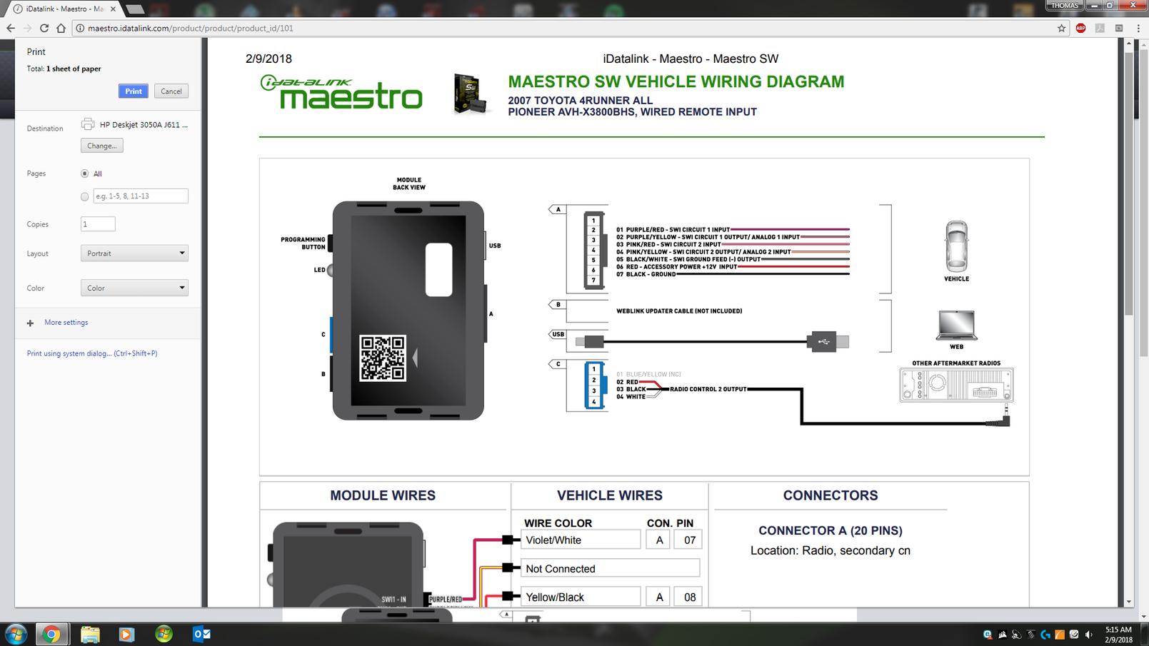

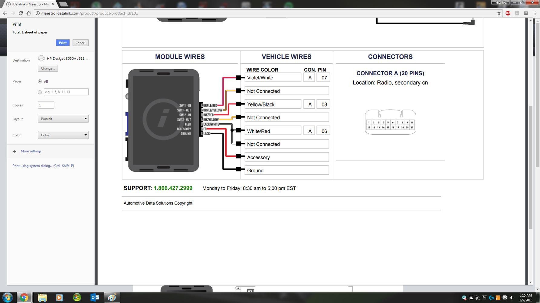

riceandpho Elite Member Feb 9, 2018 #42 you guys should make an account at idatalink maestro. the directions and pictures they give is easy to look at. also the maestro sw is easy to program with there web interface. Attachments sw1.jpg 127.9 KB · Views: 196 sw2.jpg 120 KB · Views: 190
