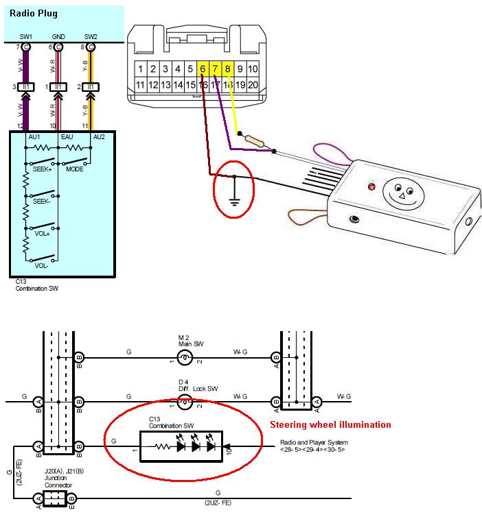

First off, the PAC doesn't supply voltage to the lighting circuits, as the steering wheel control illumination is still fully controllable by the rheostat on the dash. Granted, it looks like the ground is supplied through pin 10 at the steering wheel control (which is the white/red wire at the radio - pin 6).
How did you connect your SWI-Jack? You do need to make sure the SWI-Jack is wired up correctly though.
Look here:
The only wires you will be using from the PAC SWI-Jack are the red (power), black (ground), and white (to steering wheel control wires). Individually tape off the other wires so they don't touch each other or metal. They are not needed, and not used.
Make sure pin 6 is connected to the white wire from the SWI-Jack, and also make sure it gets grounded to a GOOD ground, verified by a multimeter.

I simply am having trouble understanding why I do NOT have illumination for my SW controls if the steering wheel control illumination is still fully controllable by the rheostat on the dash.
Secondly, the chart is wonderfully detailed, but I have no idea what the heck a rheostat is or does.
Bottom line, does the illum become disabled when this plug is pulled or should I still have illum and there is something wrong?
If you have the 20 pin connector disconnected, I would say that

Well it s official. The SW controls illuminate when I hooked the 20 pin plug back into the OEM stereo. The circuit must complete itself to illuminate.
I am now confident when grounding out pin 6 when installing the SWI jack the SW controls will illuminate.
Look here:
So the way I read the wiring diagrams is that the radio is supplying ground through pin 6 to the C13 connector on the steering wheel at pin 10. Since C13 pin 10 is the ground for the steering wheel illumination it needs to be connected in order for the illumination to work. In that case the steering wheel illumination can't work with that 20 pin connector unplugged. Where would the illumination circuit connected to C13 get it's ground?
I just put a '06 steering wheel with audio and phone controls in my 04' SR5. I don't have have the axxess module connected yet, thus the 20 pin connector in my 4Runner is disconnected and the button illumination does NOT work, hence why I was reading this thread. :-)
On a separate note, I downloaded both the '04 and '06 wiring diagrams and neither show the wiring for the phone controls that I can find. All of the descriptions of connector C13 in both manuals show only SEEK +/-, VOL +/-, and MODE. Why the wiring for phone controls is not there I can't explain but it seems like they could use the same strategy that they used for the wire that supports VOL and SEEK. They could add resistors to support talk, hang up, and answer to the MODE wire.
