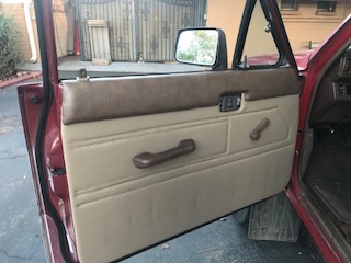

Does anyone have any hints for modding the door panels to reattach easier? I took mine off to insulate them and having a hell of a time trying to put them back on
Wow they came up great. I like the idea of using the dowel for the reliefs. Great job!
Thanks, it ended up being easy enough that I’m not too concerned about longevity. Making the template and cutting the fiberboard was the most tedious part and not really that big of deal.
