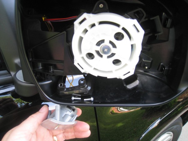

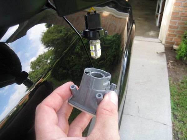

To access the puddle lights in the side mirrors:
1. Use the mirror controls inside of the truck to turn them as far in TOWARDS the window as possible.
2. Get out of the car and go put two or three fingers between the outside edge of the mirror housing and the edge of the mirror itself.
3. Then, you can start to gently pry the mirror towards you. You may hear a sort-of harsh clicking noise, which is a sound that the motor makes when you move it around manually. This is OK.
4. Once you get the outside edge of the mirror as far out as you can get, this is when you have to pull kind of hard and then it just pops out toward you. It is a little scary because you feel like you are going to break it.
5. Once it pops loose, you are good to go, and you can just put the mirror on top of the mirror assembly. You might want to use a small rag or something to protect your paint before you sit it up there.
6. The picture here shows where the back of the mirror attaches to the motor mount.
7. To put it back on, I started with the left side, pushed it in a little, and then snapped in the right side. It is a little hard to tell if you reattached it all of the way after you do it, so be sure that you did, or you might lose a mirror on the highway!
I hope this helps!

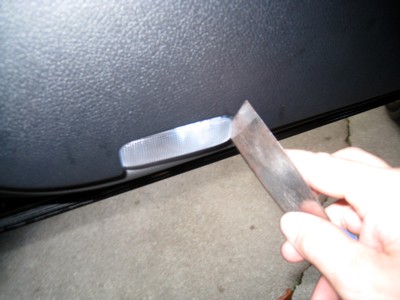

so i just started installing the V-LED's into my t4r.. map lights look great, dome light looks great.. the freakin bulbs dont fit the housing in the door puddle lights tho!! i broke one of the housings trying to modify it too.. my question is though as of now, how do i pull off the 2 tail gate light covers? thanks guys
Anyone know anything about the door lights? I hadn't even noticed them before but popped out the unit today and it looks like the same bulb as the map lights. The bulb is enclosed in some kind of extra case after you pop the unit out that I couldn't figure out. Granted I spent about 2 minutes looking at but wondering if anyone has already done this swap... Thanks!
i went to replace my door puddle lights today and the bulbs i got from V-LED were too long for the inside clear cover to go back on.. i'm searching for a new bulb that has worked for someone and i'll contact v-led tomorrow to see if anything else is shorter in length to allow that clear plastic cover to be put back on.

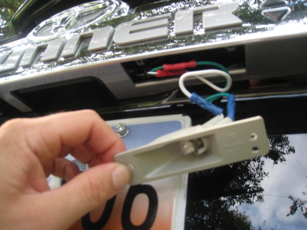

Insert a flat tip screw driver into the driver side of each light cover and press forward. There is a metal bar/clip you have to compress. Once you compress this piece of metal and lift up on the light cover, it should pop right out.
Thanks, i eventually got it.. pesky lil pieces.. just couldnt get the doors done due to the bulbs being too long.. but everything including the mirror puddle lights look great! Ill take pics soon
Any way you can put up a night pic of the mod'd LP lights? Wanted to gain an idea of the actual brightness of the amber lights opposed to white led's. That and also wanted to see the corrected angle of illumination after you switched them around.
I don't have a pic, but I would say that the LP looks just right. Although it did not look right until I switched the housings, as described in my mods. Also, your LP might look different since it is probably not the same design. I would also check with your state laws about whether or not you can put a colored light in there. I recommend the amble LEDs. I think that it is a very nice SUBTLE improvement. I can try to get you a pic tonight maybe.
