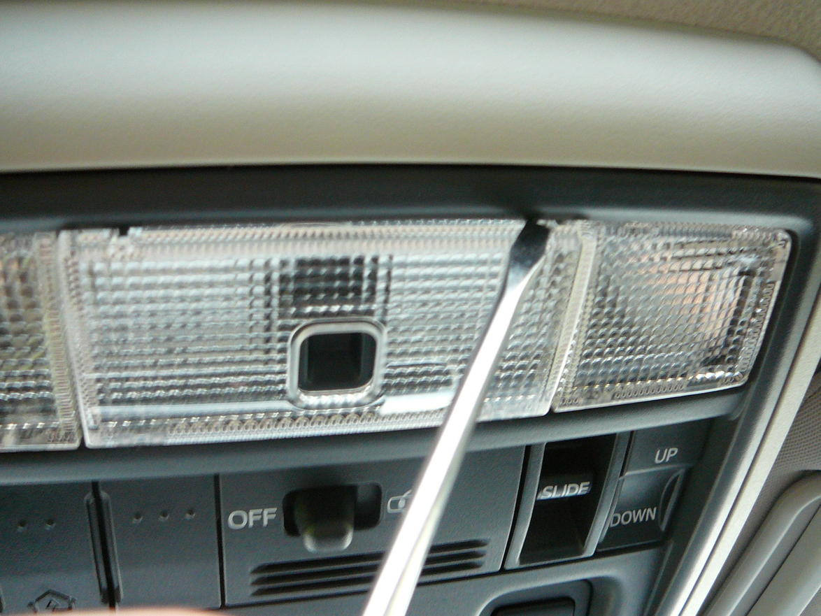

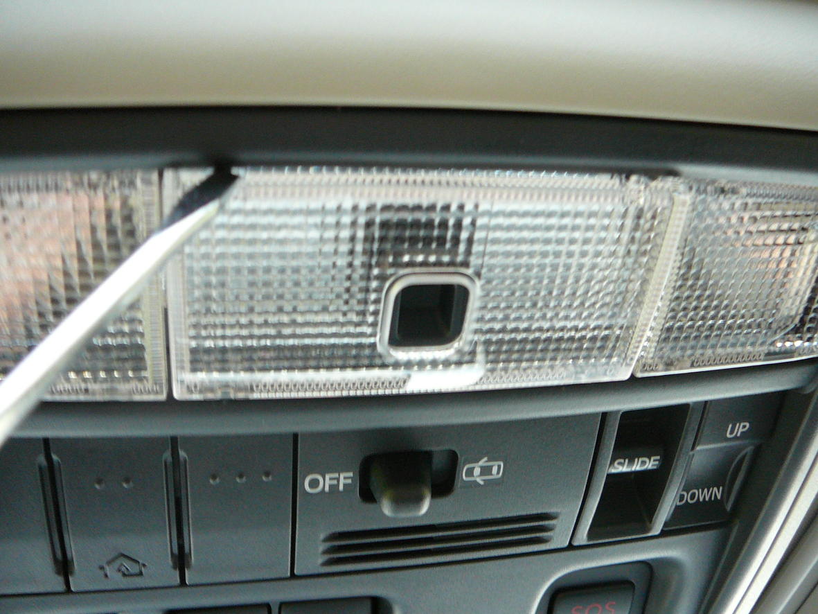

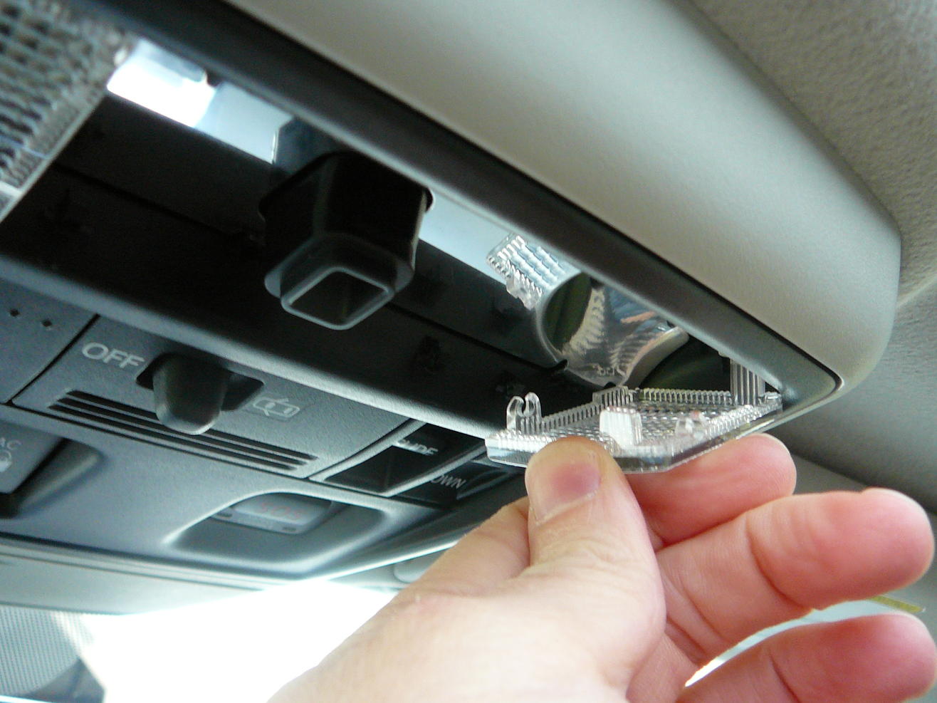

Accessing the bulbs:
1. Use the flat head screw driver to gently pry the center lens out a little bit at each point
2. After the center lens is removed gently pry the side lenses out.

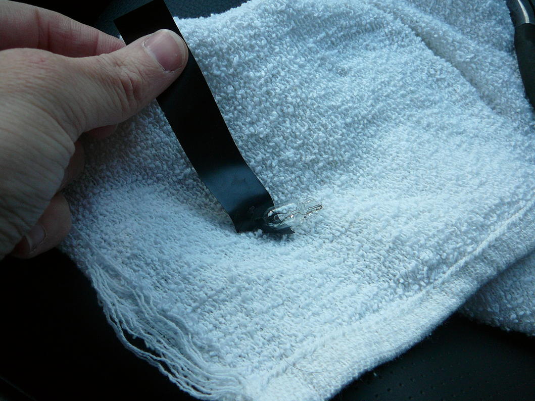

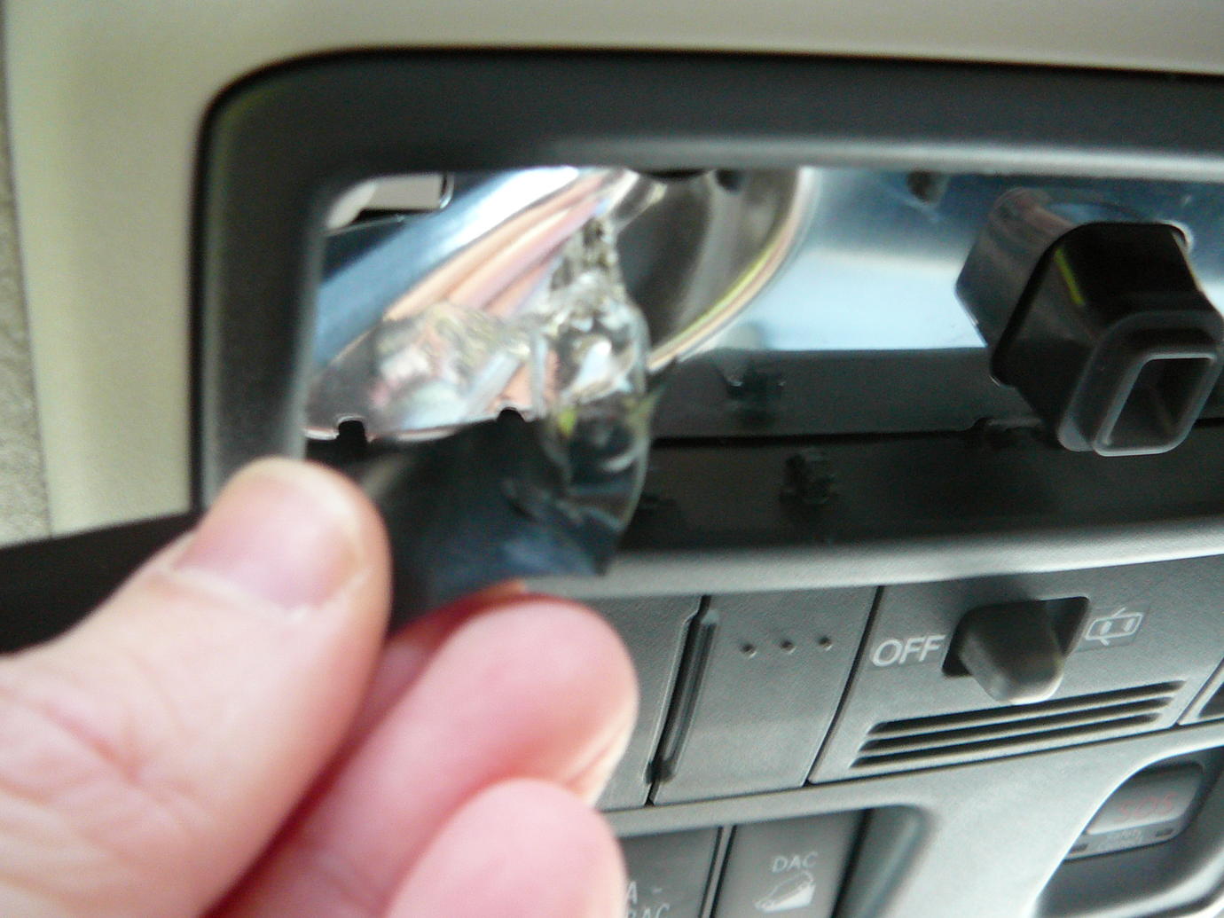

Removing the Bulbs
1. cut a strip of electrical tape. (mine was about 3 inches long, but could have been shorter)
2. wrap one end of the electrical tape around the bulb as much as you can
3. with your fingers grab the tape and bulb and gently work the bulb out.
