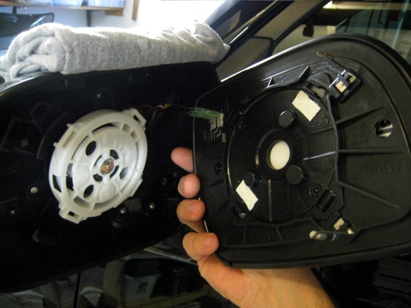

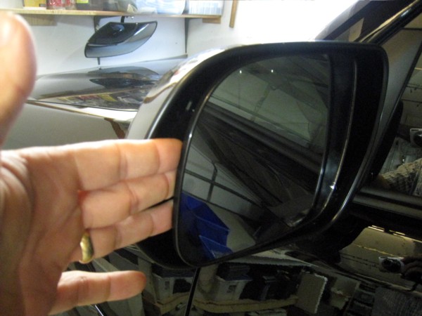

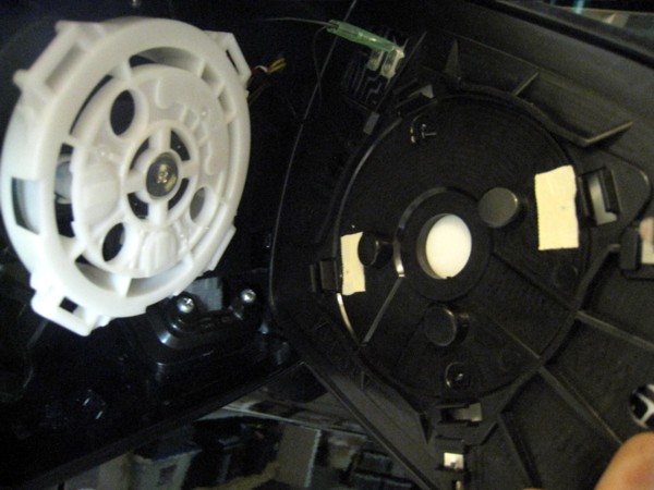

2014 4runner side mirrors puddle lights
I'm wondering if anyone has done the side mirror puddle lights on the 2014 I tried yesterday and pretty much took the whole side mirror appart and I couldn't get to the bulb. If anyone has done it please post some pics on how to do it. Thanks!!
So I finally got around to doing my mirror puddle lamps and cargo lights today.
I popped off the rear lift gate trim panel bottom edge as suggested here, thinking the entire time there must be an easier way. Once I got the panel loose and looked at the cargo light housings, it was pretty easy to see the easier solution.
The cargo light covers have a silver metal push clip on the driver side of each cover. You can slip a small flat head under the driver side edge of the clear cover, put a little pressure one it and the housing pops right out.
No need to loosen the entire trim panel. Quicker and don't have to worry about popping the clips.
