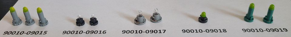

2007 T4R Climate Control Backlights - Specifics?
I am attempting to specifically identify LED replacements & sources to replace the OEM incandescent bulbs in the climate control panel in a 2007 Toyota 4Runner SR5. Attached photo reflects those OEM bulbs and bulb numbers.
I have seen in other posts that 5630(t4), 5630(t3), and 5628(t3) will work But specifics are lacking regarding which of these bulbs replace which OEM bulbs.
Also, of the bulb numbers above, I see no information in other posts about the varying height/length of the bulbs (in other words, I need specific order numbers and sources).
Finally, I have scoured internet sources and the 5628 is not to be found anywhere. Can someone identify where the 5628 can be purchased? Or is it supposed to be 3528 instead?
I just need very specific LED identities and sources for each of the bulbs in the climate control panel:
90010-09015
90010-09016
90010-09017
90010-09018
90010-09019
Can someone assist with this detail? Much thanks!
