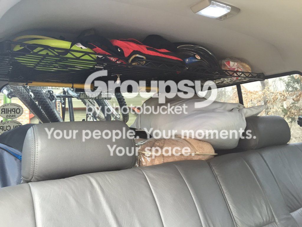

Anyone run something similiar to this? I am wanting to do this in my 4runner and am not having any luck finding something that will work

The one in the first pic is just a shelf from a metro rack. Another possibility would be a garage ceiling rack if you are looking for something metal.
Is it made for the 4Runner? Do you have a link?
Neither are made specifically for mobile use. The first one can be bought at about any store, but generally you have to buy the whole rack.

I would feel so uncomfortable sitting in the back seat.
I can't imagine how that is secured that it wouldn't be coming at you, head level, in the event of a crash.

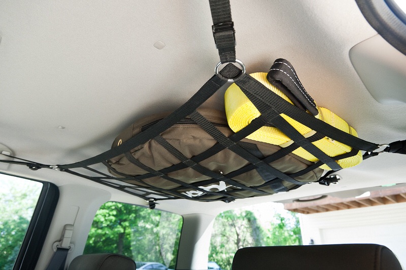

I used a bungee net to make my interior roof storage. It won't hold alot of heavy items, but for camping it will hold what I need.

Yep, Home Depot sells metal clothes closet shelves similar to your first picture. Replaced the rear coat hanger hooks with Toyota Striker Assembly #58460-35012 (x2). Hung the rack from the striker assemblies a year ago to see if it would work (ya know just to test fit). It's still there, still haven't mounted it permanent. It hasn't moved and I only put light stuff on it. It does block a bit of the rear view mirror. I bought 18"X48" (x2), and doubled them up so I have a front lip and a rear lip to keep stuff from sliding off.
