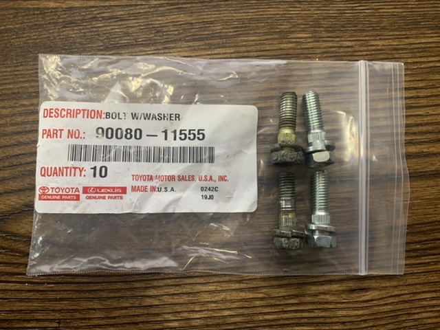

I'm pretty sure Firestone alignment buggered the threads and they weren't holding the splines tight enough such that the joint slipped. Here's a pic of my old ones vs. the new:
I'm going the chase the threads on the coupler joints before using the new bolts...

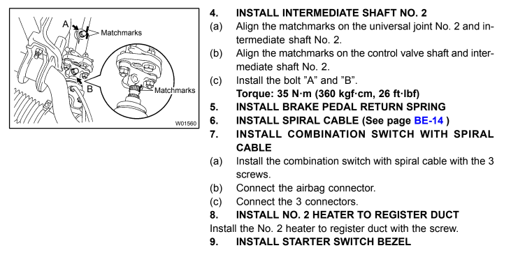

found the relevant page in the FSM, SR-20 (page 1378) and it looks like there is nothing special mentioned about the knurls.

I'm changing them because the threads were all buggered up after removing these to re-center the wheel. I suspect Firestone either over-torqued these or tried to remove the coupler to re-center the wheel without removing these bolts all the way. Either way, see first picture to see the old bolts. I'm not comfortable trying to put those back in place and so bought new ones.

Are the pictures not showing up? It's bolt A and B as shown in the FSM diagram in my second post. They are the bolts that tighten the clamp around the intermediate steering shaft and the steering rack itself.

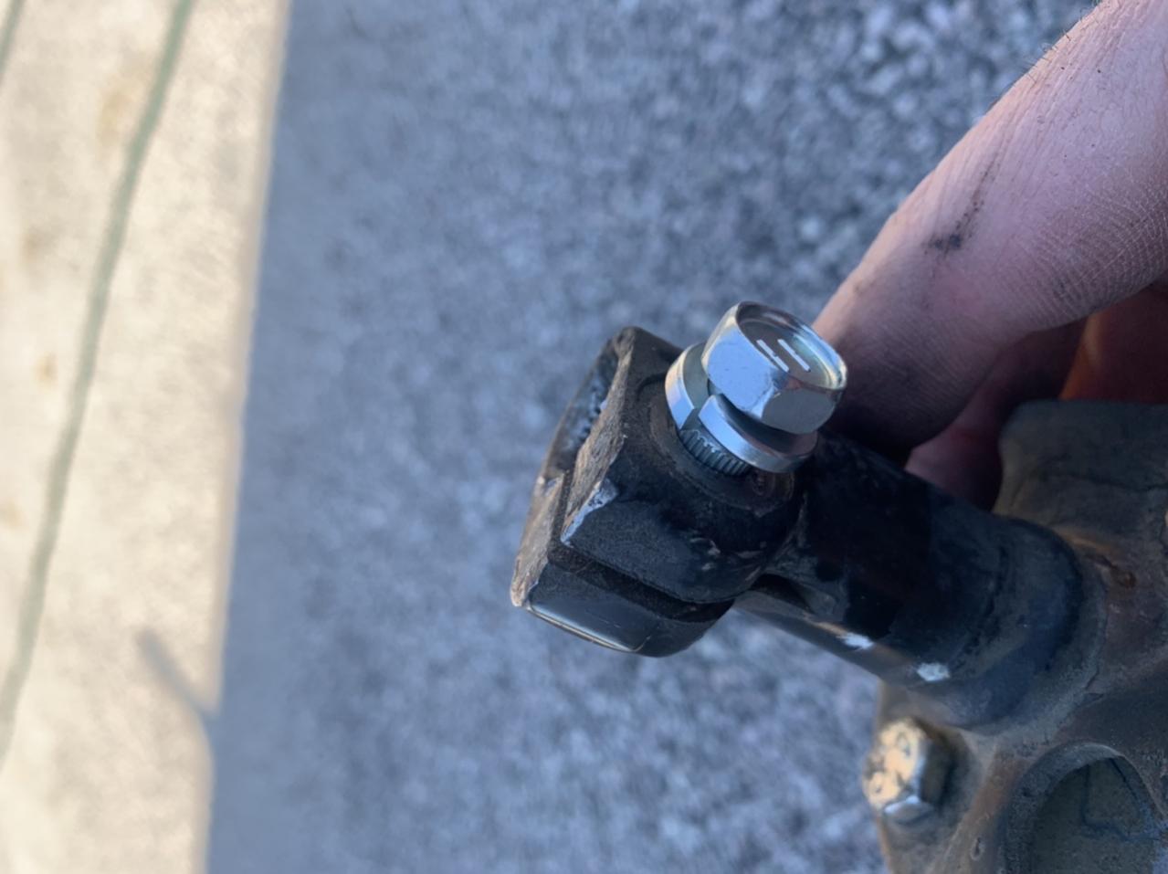

And for all the hemming and hawing about the knurls, turns out they don't even engage and don't look to be doing anything after all. I guess toyota just re-used some bolts here and called it good. Interesting... I tried to get a picture of the (lack of) knurl engagement...just take my word, they don't matter in this application.
Of course the knurling doesn't even matter lol Thanks Toyota!
