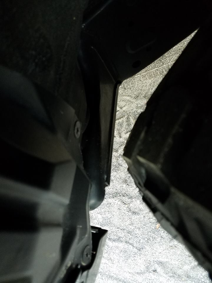

Any chance you could take a quick picture of the rub area and maybe also a picture of the lower control arm cams? That would tell us where your LCA is set relative to the frame.
