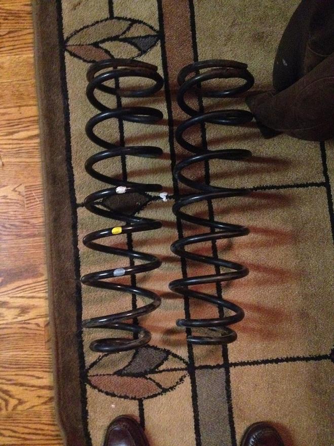

I know some will be itching to post the link in the FAQ lift section. But as you can see from the chart the color code does not match any of the listed ones. The seller has an LX450 which they came off of, but was curious as to what this code meant. Or is it just another color code the 450 used. Thanks
Height of spring/color code/wraps
21" Blue Pink White 9.25 wraps
21" Grey Orange White 9.25 wraps
20.25" Blue Yellow White 8.75 wraps-one of these is a confirmed LX450
19.5" Green Yellow White 8.25 wraps-one of these is a confirmed LX450
19.5" Purple Green White 8 wraps
19.25" Double Purple Dark Blue White 8 wraps
19" Double Pink Light Blue White 7.5 wraps
18.5" Double Pink Grey White 7.5 wraps
18 7/8" Orange Orange White 7.75 wraps
thats what they look like, measure them height wise.
