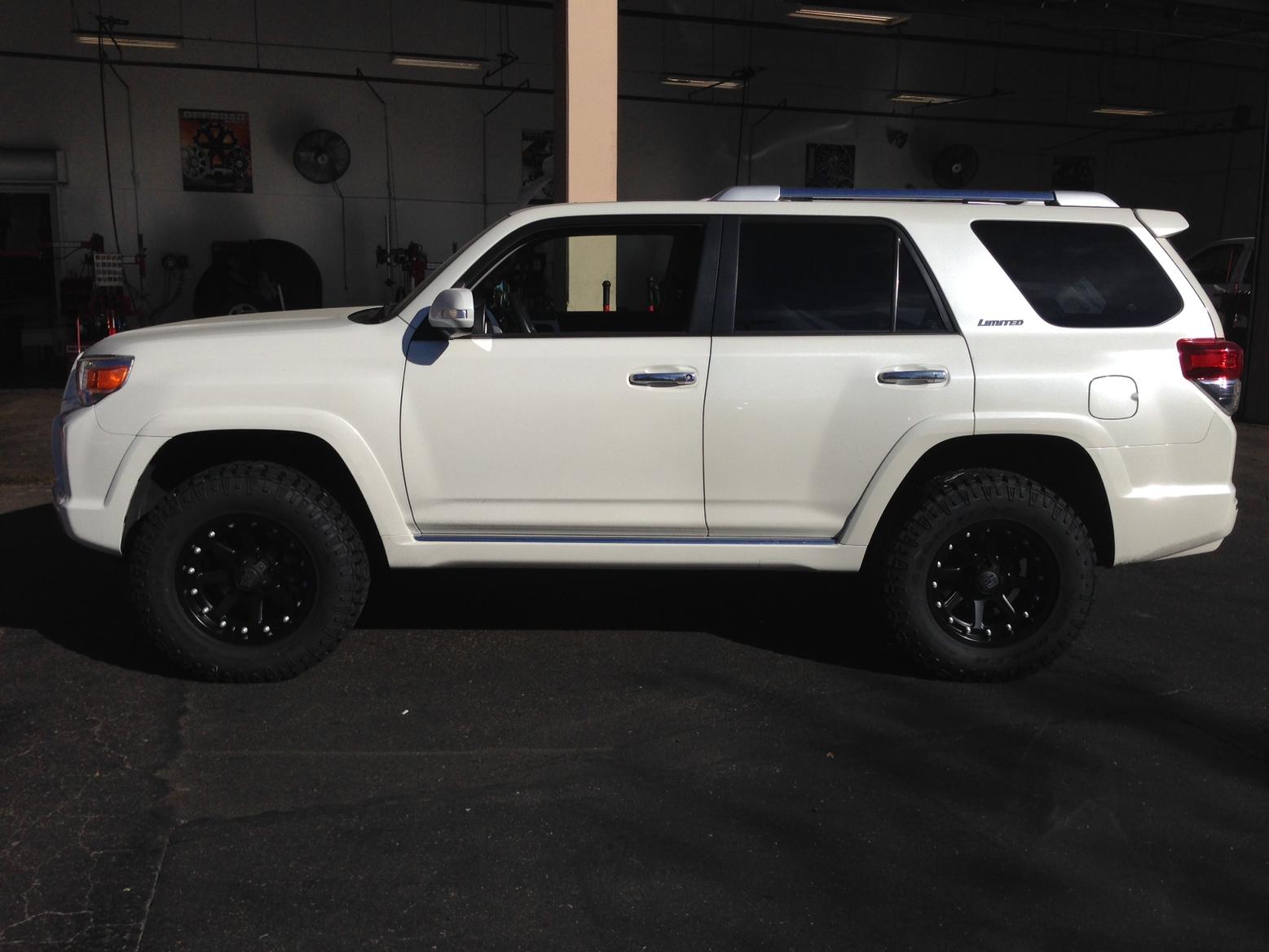

Had I taken some before pictures it would have been easy to prove but since I didn't it becomes a he said she said. The ride itself is still completely like stock. It is VERY comfortable and the only thud I hears going over speed bumps on the rear passenger. Everything else still feels OEM. I checked underneath the car this morning and no leaks so could this have just been some residual oil during the installation. If the XREAS was completely shot I would know/feel a difference correct? As far as the ready lift being crap I beg to differ. If care was taken to my driver side shock during installation this thread never would have happened. I believe it is a quality kit to achieve/fit bigger tires like the big boys without spending an arm and a leg. I don't wheel the rig very often. Ride is still OEM. With proper installation the Readylift is a quality kit. Here's a photo with the new wheels.
LOVE the wheels... but i'm biased :rofl:
...As far as the ready lift being crap I beg to differ. If care was taken to my driver side shock during installation this thread never would have happened. I believe it is a quality kit to achieve/fit bigger tires like the big boys without spending an arm and a leg. I don't wheel the rig very often. Ride is still OEM. With proper installation the Readylift is a quality kit. Here's a photo with the new wheels.
