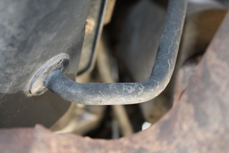

And from the Sienna world, there is a vent tube where the dipstick would be.
https://www.siennachat.com/forum/154697-post25.html
I keep hearing that the transmission is sealed. When I look at it, it has a flexible vent tube that clips to the side of the engine just below the cylinder head. The vent tube attaches to the transmission where the dip stick tube used to be.
Now what I am thinking is there still a place in the casting for the transmission that would allow for a dipstick and tube to be placed, kind of a retro fitting if I must suggest?

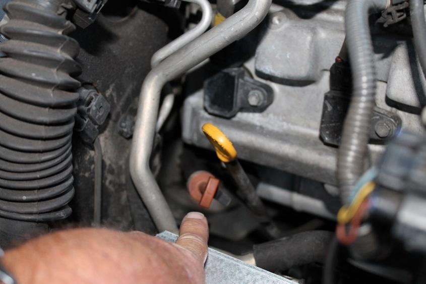

3rd picture Passenger side: Yellow round handle is Engine Oil dip stick.
Brown T handle is the Transmission Fluid dip stick.
4th picture: Transmission Dip stick tube where the pan is bossed for it.
