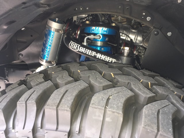

You could always do what i did, it’s really smooth now.
