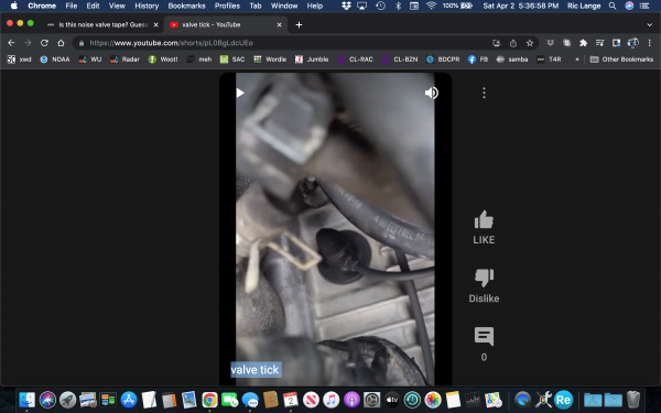

Why does half way through the video it looks like a hose not connected to anything?
As mentioned the ground is important to the sensors, please hook it up.

I swore I seen a hose in the video not connected to anything. I’ll screen shot it if I need too…..
Found it.
