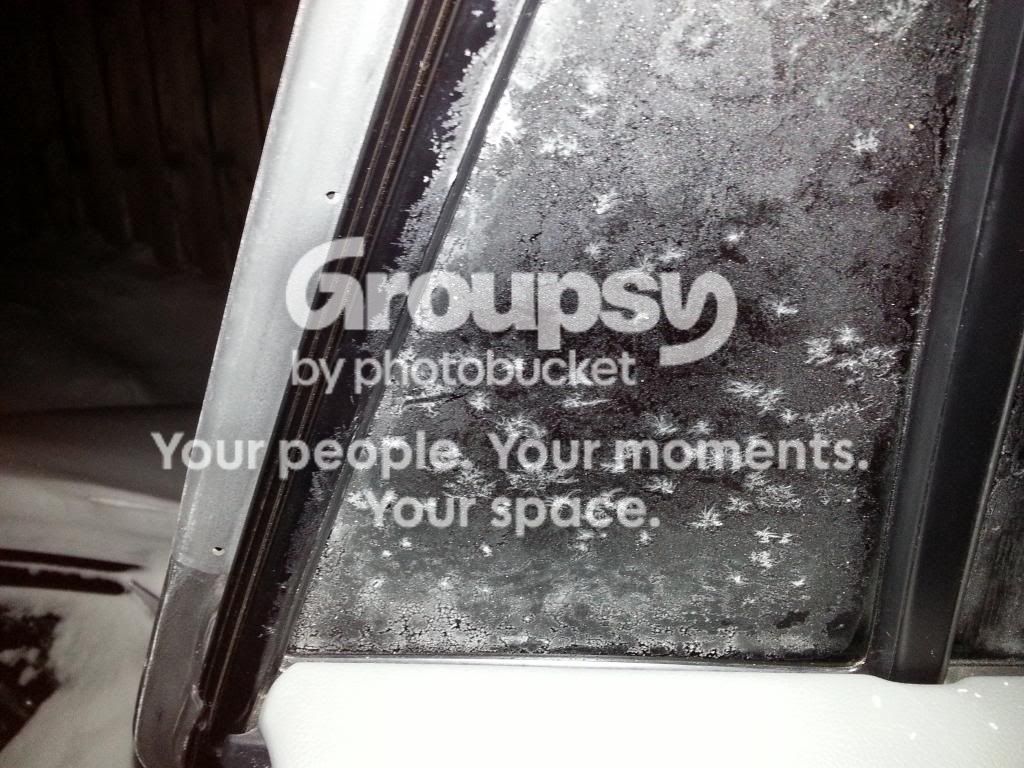

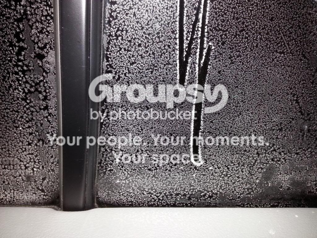

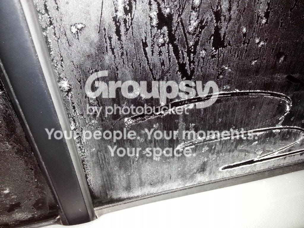

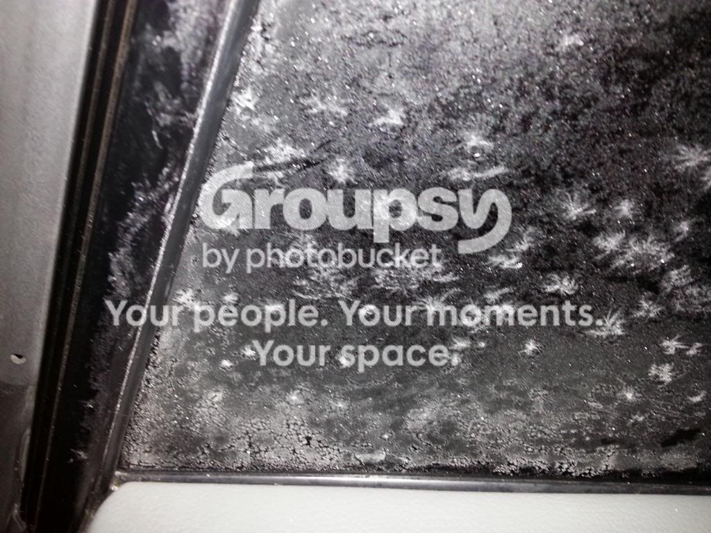

I took some pictures to show if this is normal on a 50k $ truck.
We had some -35 celsius the past 2 weeks and the back windows froze from the inside. There is like 2-3 millimeters of frost on the inside of the truck.
I took it 1 time to fix it but they seemed to have done nothing.
Here are some pictures and any help is welcome. I have an appointment with my dealer on Monday and I want to know if I have to go over the tech straight to the manager and tell him I am not happy.
My thoughts is that there is some air coming inside and the truck is not fully airtight or something.
Thanks in advance :)
If you've got any kind of moisture inside your 4R, either from damp floor mats, damp carpets, or something in the cargo area, it will condensate on the inside windows and freeze in the cold, giving you the frost in your pictures. Make sure the inside of the truck is bone dry before wasting your time at the dealer. Rent a heated garage for a few days if you must. And from here on in, control the amount of snow you drag into the truck with your boots, and those of your passengers, or the problem will be back. This is pretty basic stuff.

Yes it is definitely normal, although there is a lot in your case. I noticed my 4Runner is a bit worse than most vehicles I have owned/driven, and I think it is due to the interior volume in regards to the airflow from the AC. It has nothing to do with the sealing of the vehicle, and I don't honestly know how the dealer could fix this. This is the result of the the amount of moisture inside the vehicle which is condensing and freezing on the exterior glass, which is cold because it is the boundary between the heat and cold. If you run the AC with the heater, it will help by pulling the moisture from the air, also make sure you are definitely NOT using the recirculate air button, which will help bring dryer air in from the exterior. You can also crack the windows a bit which will help bring in dryer air from outside, and allow you to run the heater at full without cooking yourself.
You have a lot of frost, and if it is really cold it will take a long time to dissipate, so I would use a scrapper or credit card on the inside of the glass to clear it off for the time being.
Besides from just snow being dragged into the vehicle, you also get it from people breathing inside the vehicle if you have a full car load. You mentioned you washed the truck inside and out, and that is almost certainly what has caused this.
