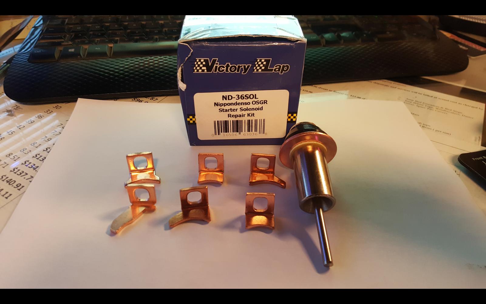

Rebuilt my starter for a 2nd time this weekend. It had been clicking for over a year! Finally wouldn't catch. My hands are cold arena sore, but it's done. Bought a kit on ebay for $17 that included both contacts and plunger. (97 4wd 3.4 auto)
Victory Lap ND-36SOL Solenoid Repair Kit https://www.amazon.com/dp/B0031HL09E/ref=cm_sw_r_taa_Zh1qybM66MRGQ
Good to go for another 100k!

Is everyone replacing the plunger just to be safe or is there good reason to?
This doubles the price of the repair, but more importantly my local dealer has the contacts in stock, but I'd have to wait till tomorrow to get the plunger too.
No, not needed. I'm the Original Poster of this thread, I forgot :) and I did this repair like 7 years ago, and it's only the one side of the contact that goes bad, but I did replace both contacts, re-used plunger.
Great, thanks!
Now all I've got to do is get the starter off!
Well, in the OPs case, I reckon it wasn't necessary. I would concur that the larger of the two contacts is the one that receives the most wear. The part of the plunger that makes contact with the copper contacts did show signs of some wear in my starter solenoid. Basically the surface looked really rough.
However, this is the way I look at it. It's sort of a pain in the ass to get the starter out and back in. Do you really want to roll the dice for the savings if the plunger then gives you problems sometime down the road? I think this is why most of us just replace the plunger while we're in there. It's like doing the valve cover gasket job. It's a decent amount of labor to get the valve covers off. Do you want to roll the dice and save on replacing the cam plugs or should you do it while you're in there to save yourself a bunch of repeated labor if your gamble doesn't pay off and the cam plugs end up being a source for an oil leak. Just like replacing the water pump while doing the timing belt. You're already in there so why not do it. Anyway, I could keep going but you get the gist of what I'm saying.
