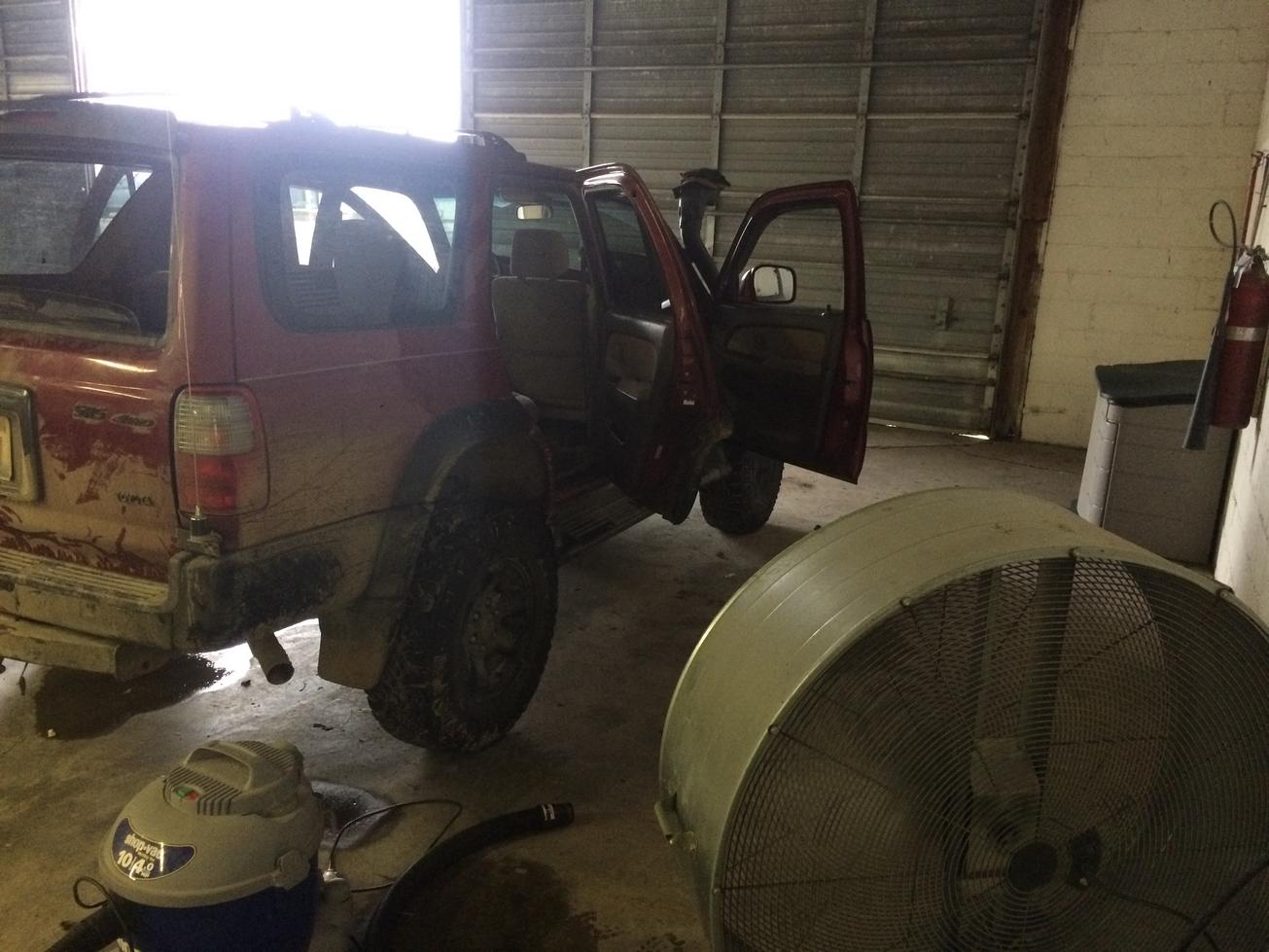

So, I started messing around with the Runner today. It still has some damp spots so I put a big fan blowing on it, might freeze now though lol. Does anyone have a line on a vinyl floor liner to replace the carpet in our cars?

I've been in water deeper than that without a snorkel with no problems......unless you hit that water at speed.........

Yeah, it had side walls so a wave got going and was over the hood at one point...
