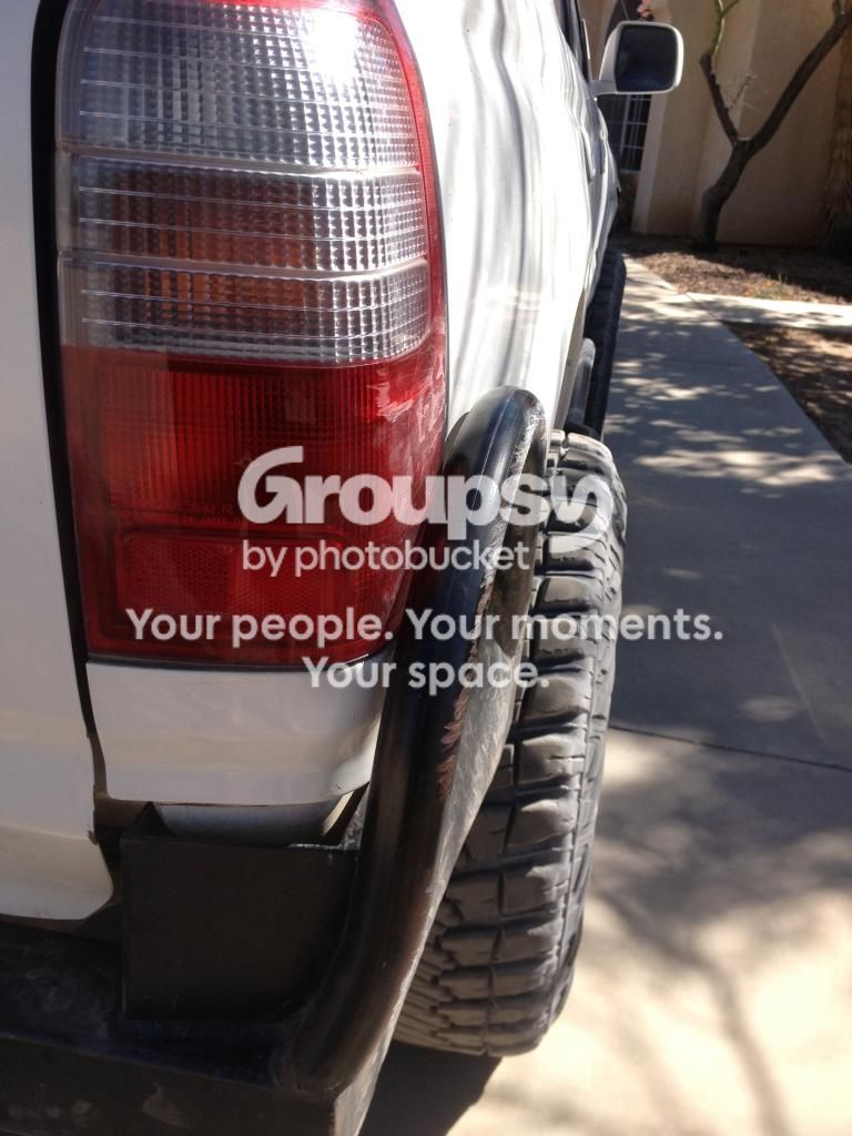

Bent the sweet batwing into the side of my truck on bullfrog the other night. It caught the entire truck. Barely cracked the tailight and got a nice dent front tubing smashing the quarter. Cut most of the way through the batwing. bent it back and re welded it. THen my friend talked me into trying to punch the dent out so i popped of the interior trim and tried it. Got 90% of it out.
Time to try and gusset these things.

Damn dude.. I'm kind of worried about that situation too if I ever hit them a little hard. Dunno how I could gusset them though.
It bent the entire bumper... they have held up good but this was a really hard smash. Im thinking use some 3/16 and plate the entire batwing. or ad a 3rd tube in the middle then plate it.

I just cut and bent them back. then re welded. Im probably just going to be real lazy about it like everything else on the truck and leave it for awhile. I think you could easliy gusset them proper, and it would have been easy to do initially, its going to be a pain adding it as a second thought.

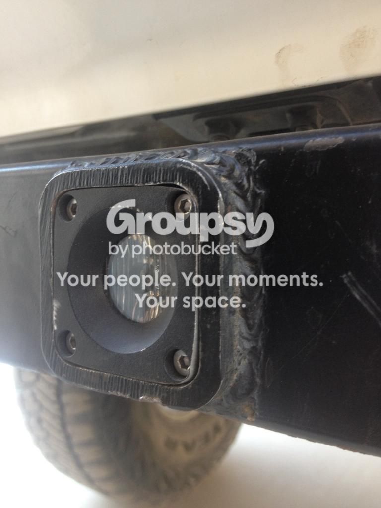

on a side note. Got this led pod for almost free from a buddy who imports them from china. Decided to mount it in the receiver in the rear bumper since i dont have reverse lights. Put it on a switch. Its perfect. I drilled and tapped a set screw on the top and it seems secure enough. Its a 10 Watt single led in a flood. Its really bright. Output is right there with the rigid 2x2 pods. Good enough for me. Had to grind the housing a little. Although I tested it on others and it fits in perfect with no grinding.

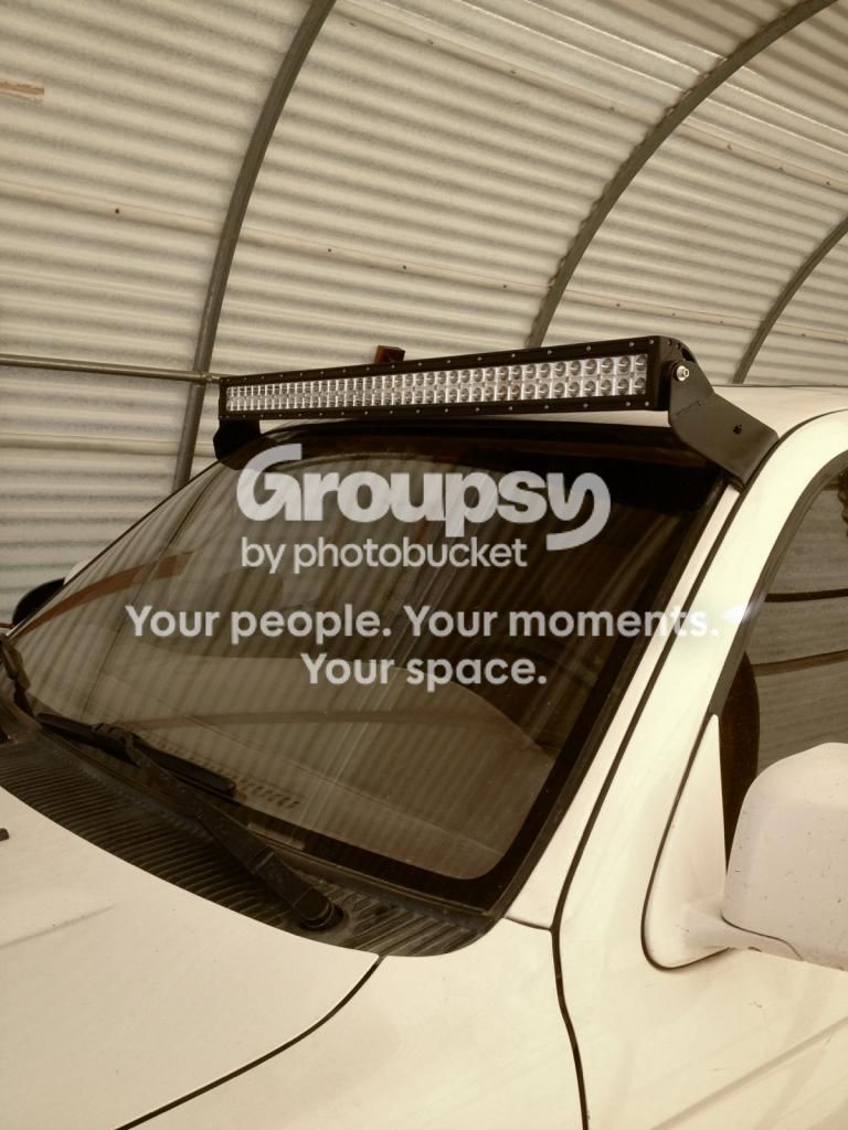

Close up of the mounting for the lightbar. I really didnt like mounting this, but these mounts were the least bad idea I had. THe bar is 41.5" all spot pattern with 3w cree chips. Seems pretty good, it has the distance i wanted. I still like the 10Watt cree bars on the bumper. Got a deal on the bar, straight from china so I cant complain.
Looks good to me. I actually like the ARB like that than what it comes stock. Let me know if you ever scrap it...I'd be happy to take it off your hands...haha
Also I really like your receiver light, definitely keeps it away from potential thieves and looks good. How's the light output?
Got this led pod for almost free ($7 plus a 6" square of 3/8 scrap steel) from a buddy who imports them from china. Decided to mount it in the receiver in the rear bumper since i dont have reverse lights. Put it on a switch. Its perfect. I drilled and tapped a set screw on the top and it seems secure enough. Its a 10 Watt single led in a flood. Its really bright. Output is right there with the rigid 2x2 pods. Good enough for me. Had to grind the housing a little. Although I tested it on others and it fits in perfect with no grinding.
Just saw this... Brilliant. I might just add this in to my receiver hitch and do just a simple plug and play with the trailer harness...
That reverse lights bright as hell. Was good meeting you at KOH (I was Matt's buddy). Hopefully I'll have mine ready for next year.
