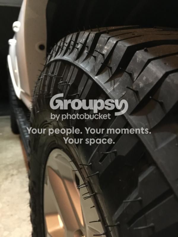

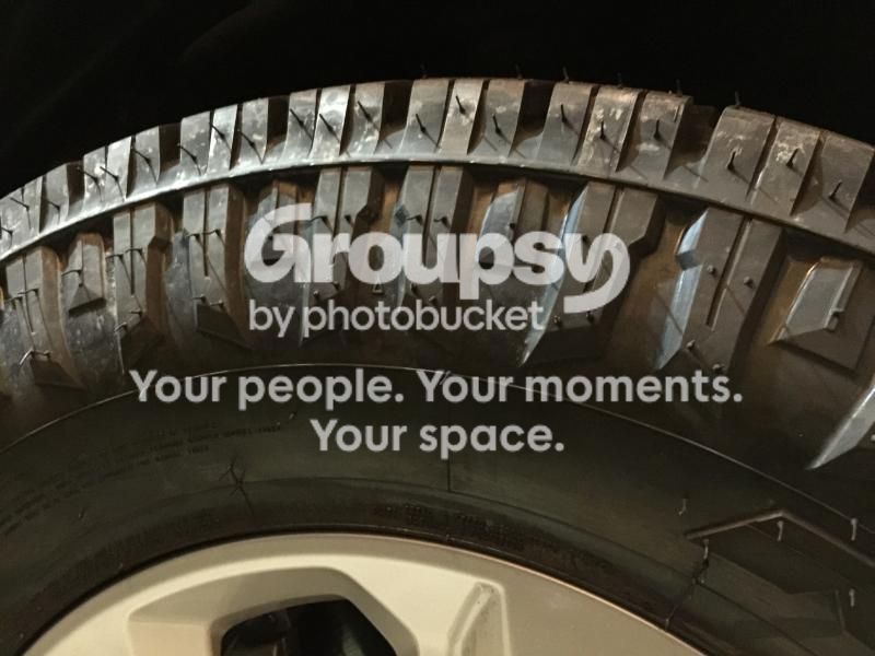

Overall I've been very pleased with them. I'm running 285/70/17's on my rig. As this is my first off-road vehicle, I don't have much to compare these tires to. I was deciding between these and the BFG KO2s, but they won't release the size I want until March.

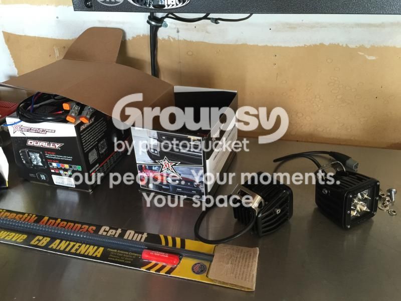

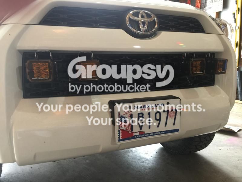

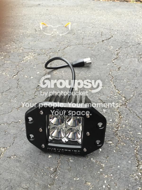

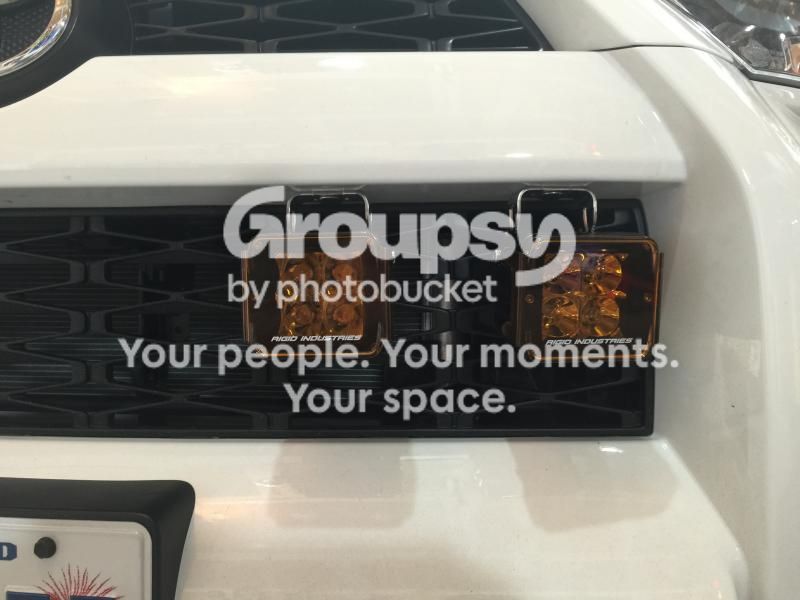

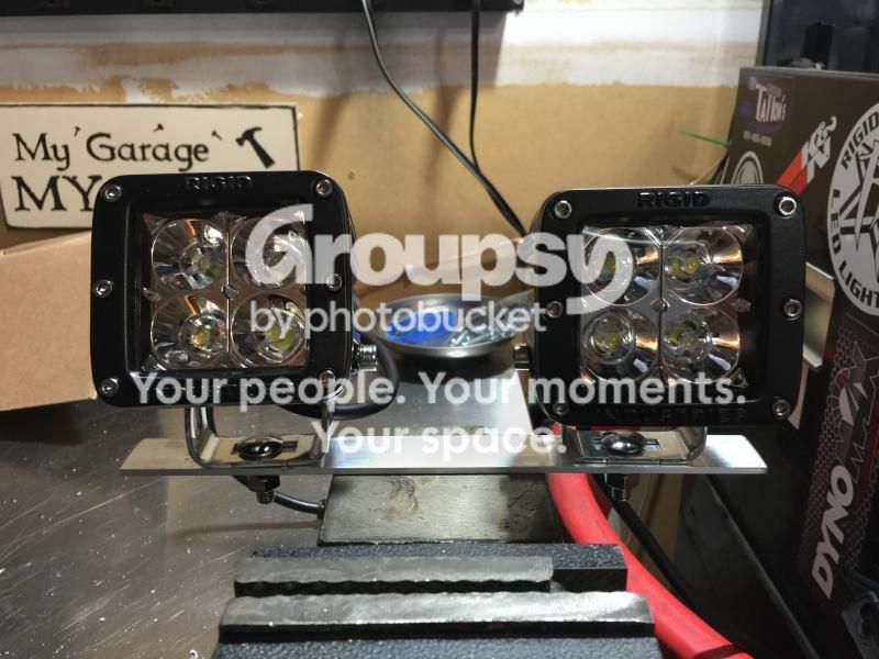

Got some daylight:

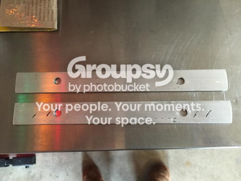

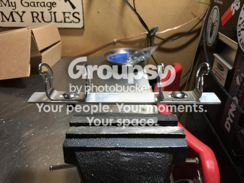

Made two brackets (totally stole the idea from Desert Dawg :banana: ):
Fit daylight to the brackets:

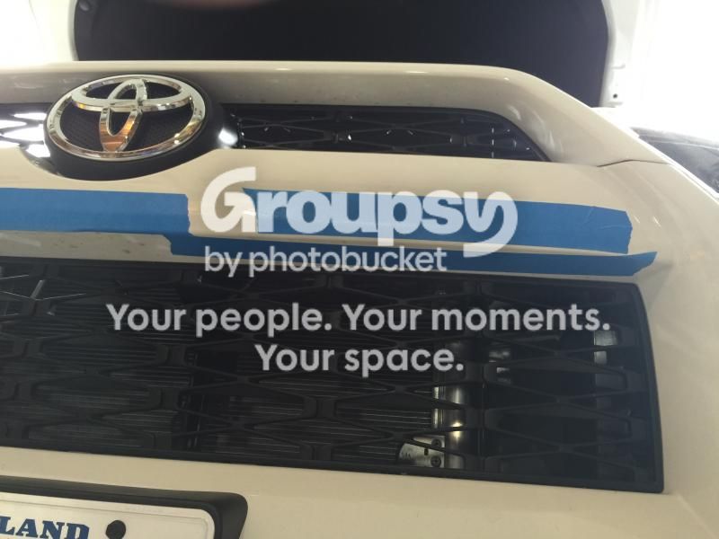

Prepped the 4R by finding the center and offsetting the outer light at 16.5":

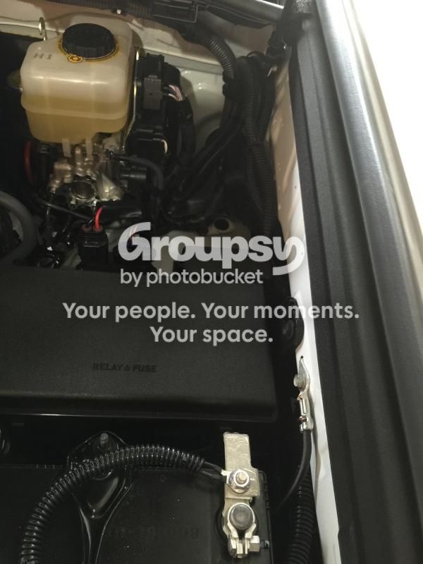

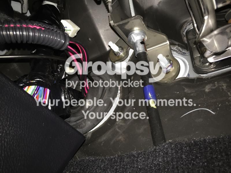

Ran the wires thru the firewall:

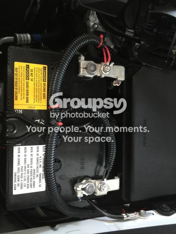

Clean wiring to the battery:

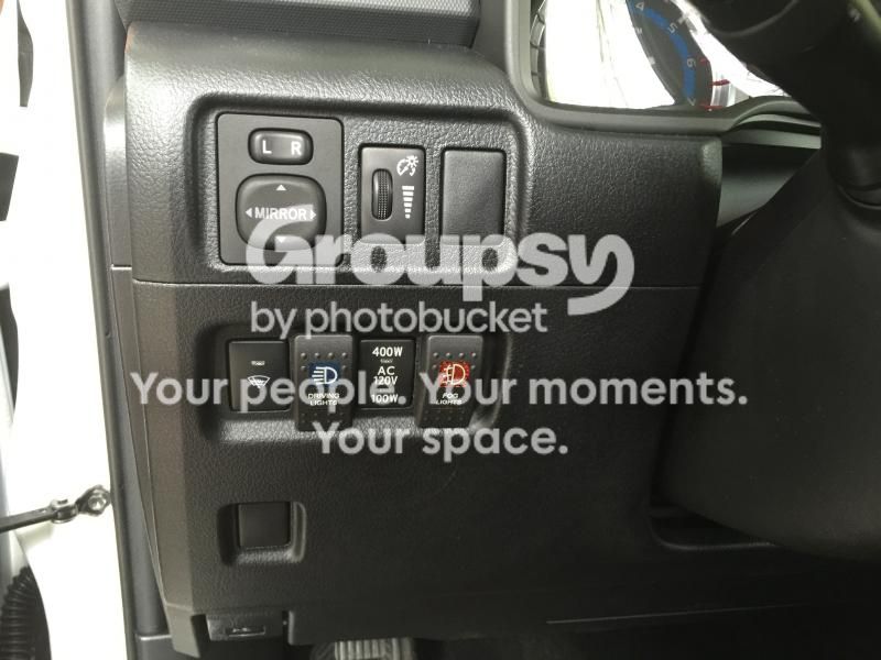

The OTRATTW switches look great and fit perfect after a little trimming:
All done:

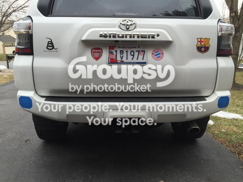

A few decals:

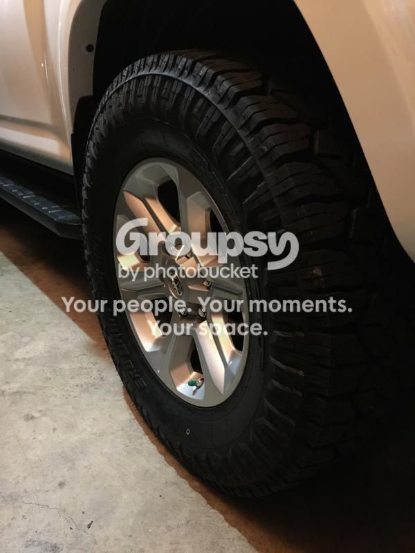

-LT265/70R17 Nitto Exo Grappler AWTs on the stock wheels (DONE)

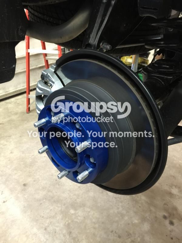

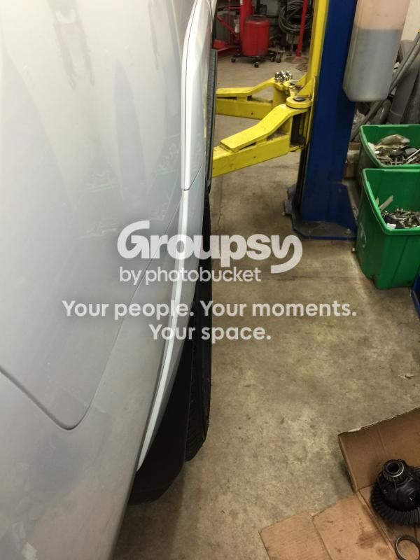

-Spidertrax 1.25" wheel spacers (DONE)

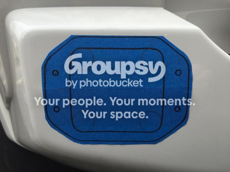

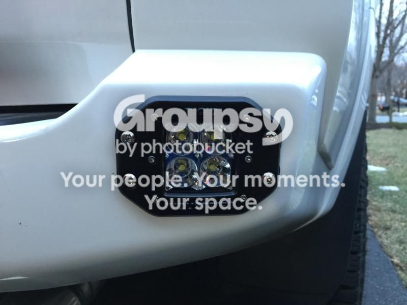

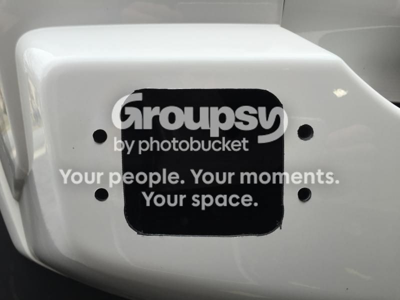

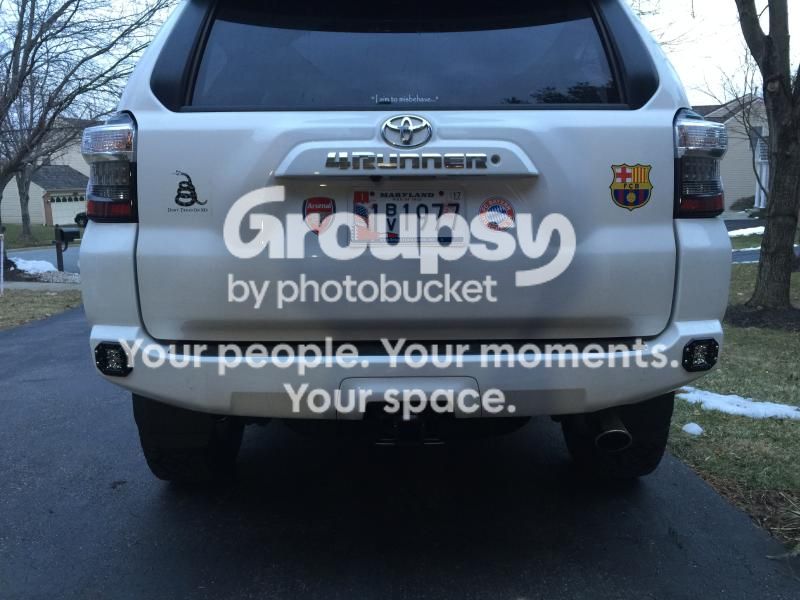

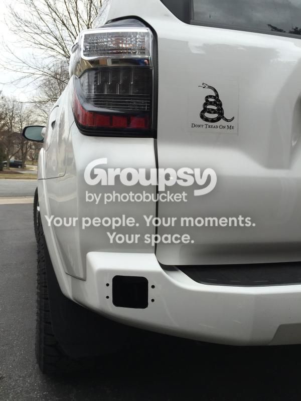

Flush mounted Duallys:

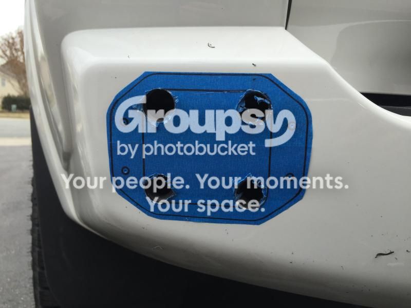

I made a template using the Dually's rubber gaskets:
I drilled holes in the corners and cut the rest with a Dremel:
Installed:
This mod is guaranteed to increase MPGs and horsepower. Significant gains in torque and towing capability are assured. Improved aerodynamics and sex appeal go without saying.

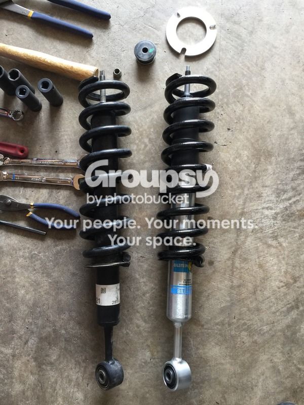

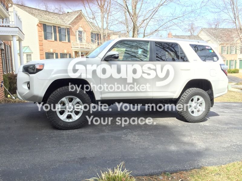

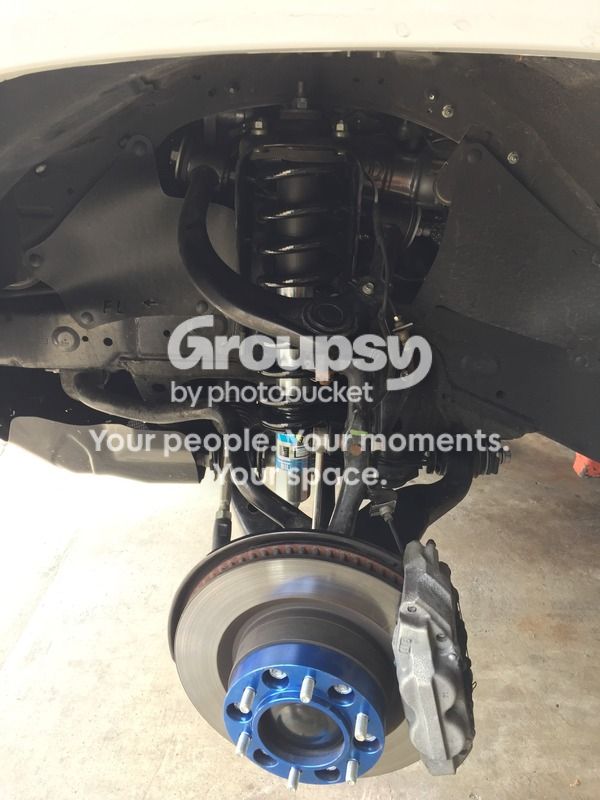

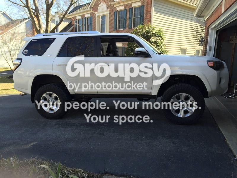

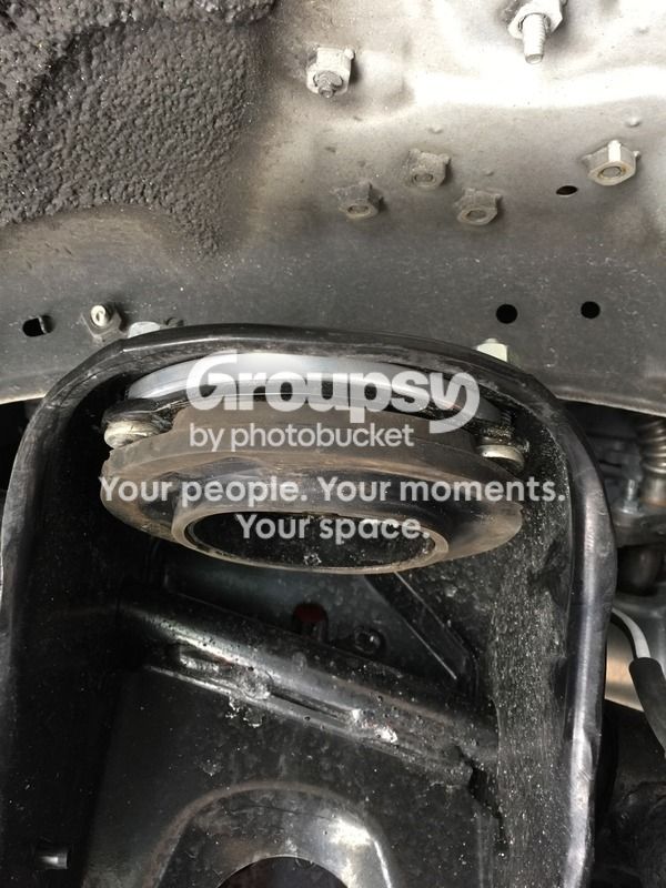

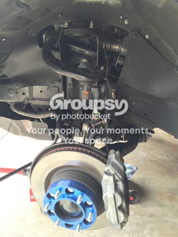

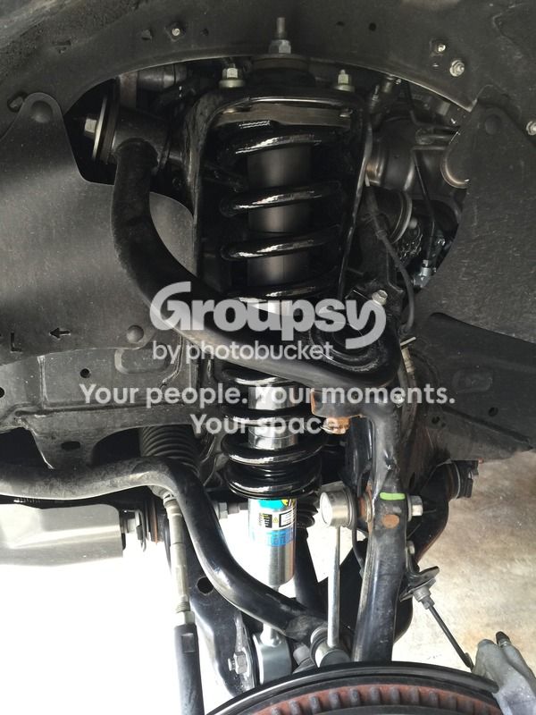

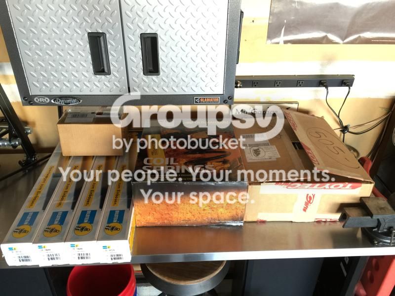

Put on the lift today:
OME front coils

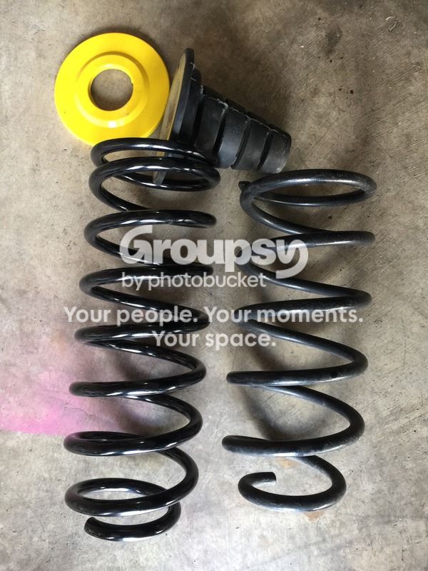

Toytec rear coils
Bilstein 5100s

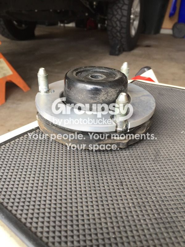

Toytec driver side front leveling spacer
OME driver side rear leveling spacer

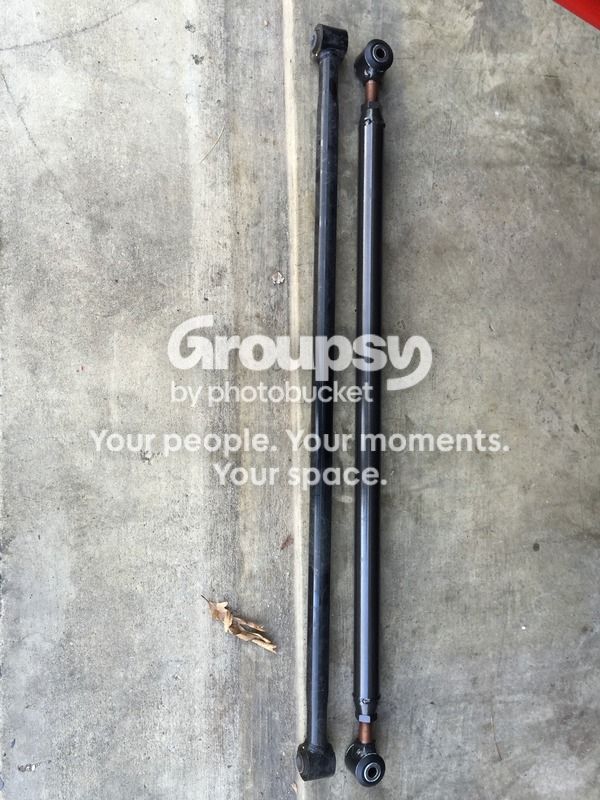

Sonoran Steel pan hard bar
1 person
5 hours

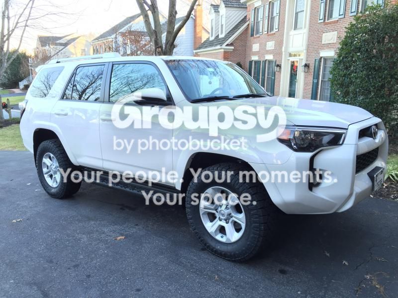

Measurements from the ground to the fender with 3/4 gas tank full

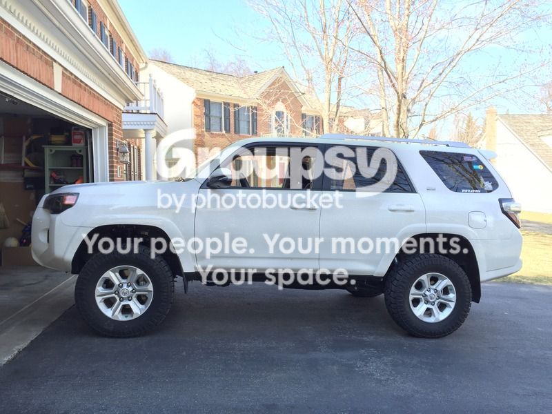

Pre-lift:
Driver front - 34 7/8"
Driver rear - 36 5/8"
Passenger front - 35 3/8"
Passenger rear - 37 3/8"
Post-lift:
Driver front - 37 1/8"
Driver rear - 39 1/4"
Passenger front - 37 1/2"
Passenger rear - 39 7/8"
Gains:
Driver front - 2 1/4"
Driver rear - 2 5/8"
Passenger front - 2 1/8"
Passenger rear - 2 1/2"
She needs an alignment, but she drives great.
I'll get some good "after" pics in the morning.

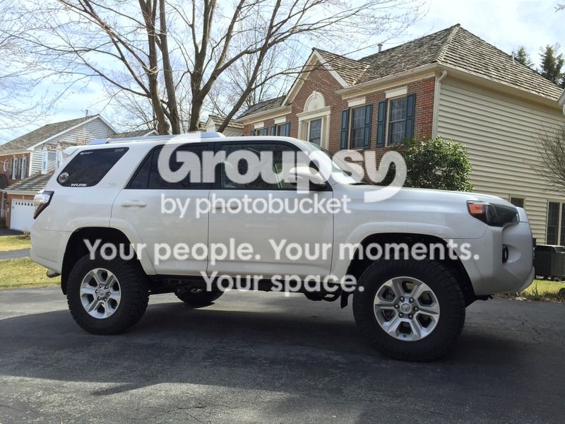

I went ahead and bumped the front 5100s from 0 to the 1.75" notch.
DF: 38 5/8"
DR: 39 1/4"
PF: 38 7/8"
PR: 39 3/4"
DF: 38 5/8"
DR: 39 1/4"
PF: 38 7/8"
PR: 39 3/4"
Those are pretty much the exact same measurements I got after I installed mine, and I was a little worried at first.
How do you like the OME coils on the front?
So you only put the rear trim spacer on the drivers side, right? And it only gained you a 1/8th difference between driver rear and passenger rear? I would have thought it would do more.
I have one that I've been waiting to put in, but I'm worried it may tilt it too much to then lean to the passenger side. I'm hoping it lifts the rear overall slightly as well.
