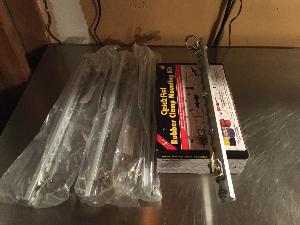

Got one drawer done today along with the tie down points.
A good use for mini Quick Fists.

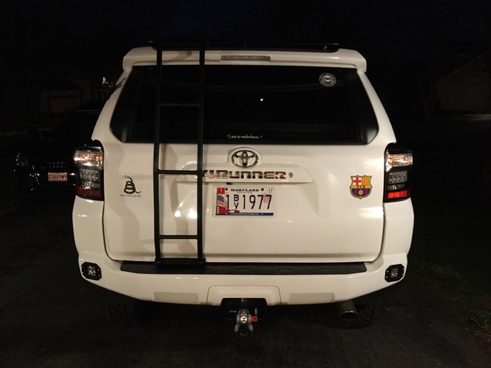

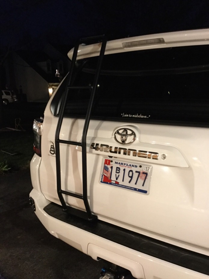

Plenty of clearance between the Baja Rack and Gobi Ladder.

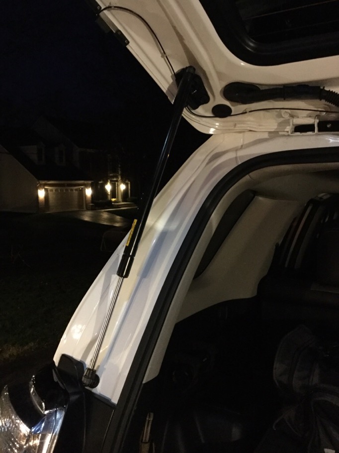

What tailgate shocks are those? I'm looking to add a ladder and don't want my tailgate coming down on my head.
I found them on Trail Duty's web site. They're listed under Gobi Rack accessories. They work awesome ...they also raise the tailgate a few inches higher than the stock shocks.
