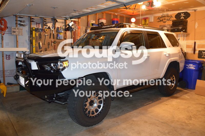

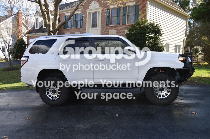

Here's how she sits now:

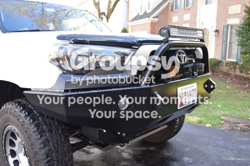

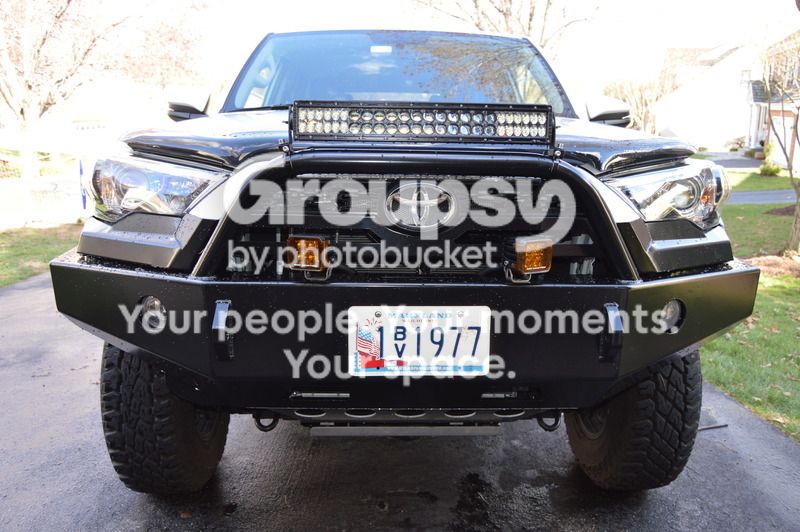

How did you mount your Dually lights under the horizontal grill cross bar? Did you add any metal flange to the inside for added support, similar to Desert Dawg's build?
I have two Amber D2s that I want to hang there, but not sure where to get the metal flange. If you did anything different, could you share what you did? Any additional pictures, close up shots?

There are a few pics in this thread, but I did exactly what Desert Dawg did, just 4 instead of 2 lights.

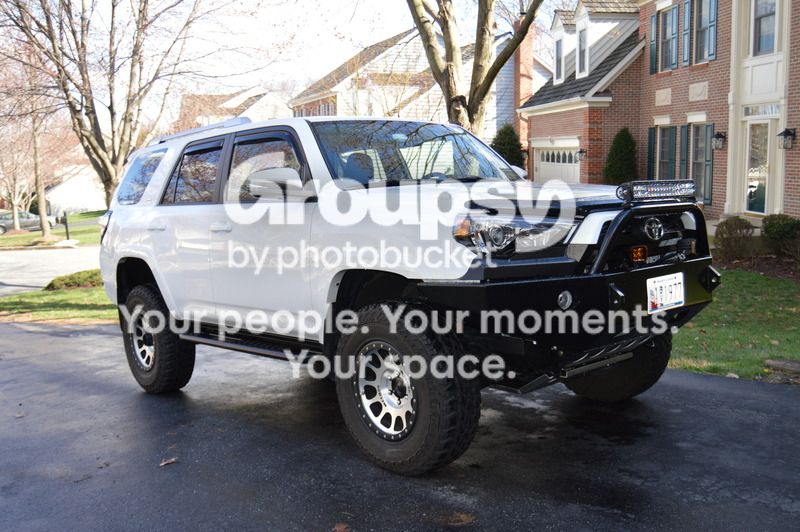

18 March Update:
1) Lowered the front 1/2" to be rid of a 35-40 mph vibration and gave her a bath.
2) Installed Shrockworks front bumper and enough light to make it day (cause its 'Merica and I can!)

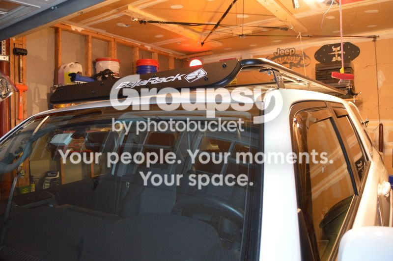

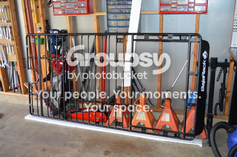

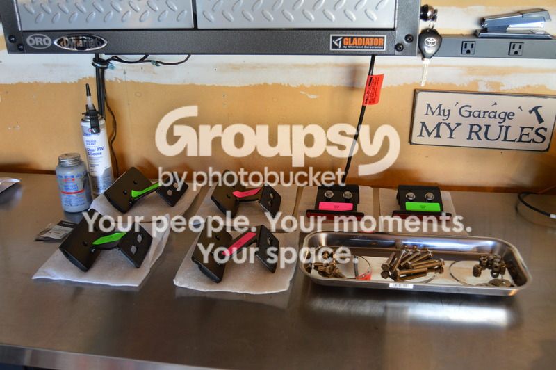

3) Baja Rack came today and I couldn't wait ...

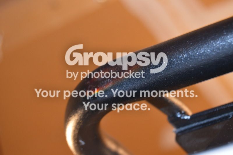

--Rack didn't make the journey w/o something to show for it. Little Rustoleum and I'm good with it.
--The rack install required a blood and body sacrifice ...but she's a DD/trail rig/sexy *****, so I don't mind.

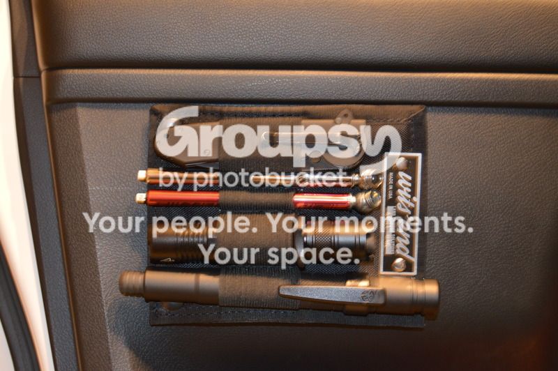

4) Added some door weapons ...
---Started working on plans for cargo drawers ...heading to Lowe's on Sunday!

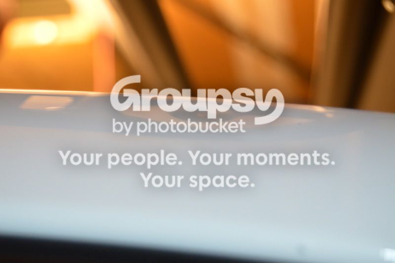

Looking at it this morning, I may have overtightened the roof bolts just a bit. I don't have a in/lb torque wrench, so I judged it with a small 1/2" wrench. No major damage, just some slight signs of overpressure on the roof at the corners of the roof brackets. Live and learn.
Nice Rack!
Great looking build, OP!
I'm anxiously awaiting the same Baja Rack from the TacomaWorld Group Buy. It will supposedly ship next week and it seems like Baja Rack has caught back up after the fire at the powder coat shop.
Any tips on the rack install or was it pretty straightforward? I'll try not to over-tighten based on your previous comment.
