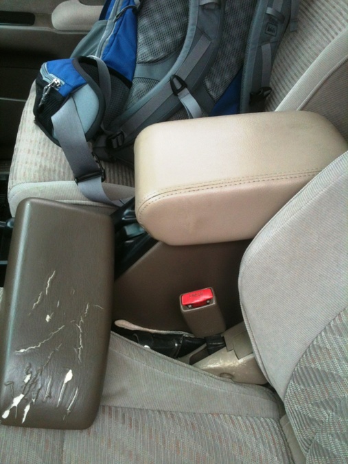

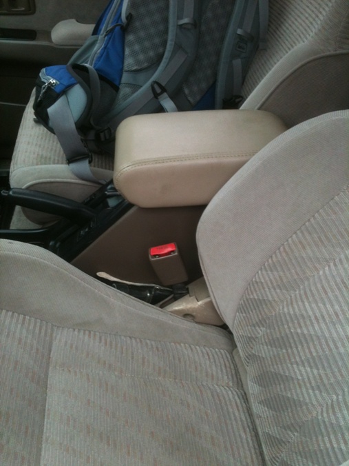

I finally found a tan 02 Isuzu Rodeo armrest on Ebay and paid 50$ total with shipping. My local Honda dealer wanted 120$ for a Passport armrest, which is the same thing. Both Passports and Rodeos from 98-02 have the same armrest. I enjoy the extra padding and the only problem with my interior was my trashed armrest the PO left behind.Now I've upgraded it. I took pics with my iPhone and I have to say, the armrest looks better in person. It blends in color wise better than the pics represent, but they're all I have for now.
This pic shows the old trashed one and the new one:
And this pic just shows the new one:
I had to drill a couple of holes in the plastic to make it fit. Took about 20 minutes and a few curses as I tried several screws before finding a decent fit. Big thanks to Bgmac for his thread: http://www.toyota-4runner.org/3rd-gen-t4rs/54787-armrest-mod.html

Dont toss the damaged 4Runner armrest. You could probably have it re-upolstered for ~ $50 and the sell the izuzu one back on ebay ... if you wanted to.
Hey Brianemc, I can definitely tell this is a mod you're not a big fan of, but honestly, I don't like the stock armrest. I much prefer the thicker padding, cuz I have an auto tranny and I'm always resting my right arm...on the armrest. Actually, in person, I think the armrest looks great too.

I just mentioned the armrest because I redid one on my previous vehicle pretty cheap. But I understand if you like the different one.

Nice armrest mod! I've seen it a few time before, but never done it, as my armrest is in near perfect shape!

Nice! The only thing I would have said is that it doesn't look to match that well, but you already mentioned that it matches much better than shown, so all I can say is that I like it! I've heard those armrests are much more comfortable to rest your arm on then the stock one.
Yeah, it's an excellent improvement. At first I thought it seemed kinda lame to even post a pic, but then I was like, "Hey, I use my armrest every time I drive my truck. And the one I had was torn up anyway. Might as well go for it."
The extra padding is awesome, and my GF and I can actually share it when we're both in the truck, another plus.
I'll take another pic with my camera instead of my iPhone, which decided to make the armrest look as out of place as possible. Honestly, if I was a person considering this upgrade, and I only saw my pic, I wouldn't do it.
