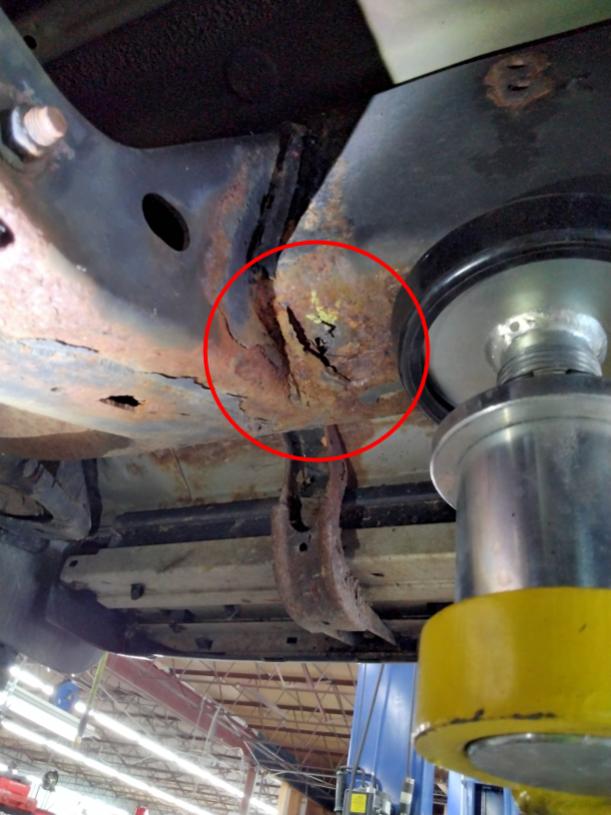

Here's a pic of the worst spot of rust:

yeah that rust hole will need patched by cutting out the area until its solid metal then welding in a new piece.. but i still dont see $1000 worth or time/materials there. a few hours at $100/hr shop rate & 20 bucks worth of metal is all that should be required based on that pic... but ya never know how far they have to cut out until solid metal. again, check with some other shops, or shops more geared towards frame/suspension repair or off roading/trucks.

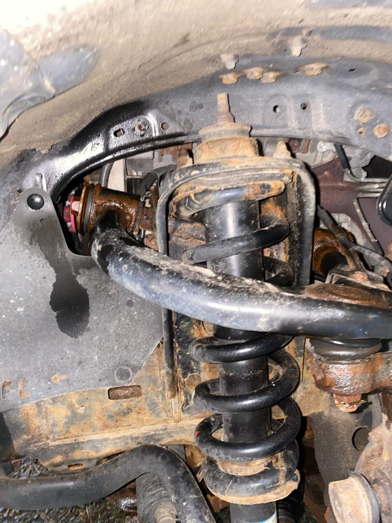

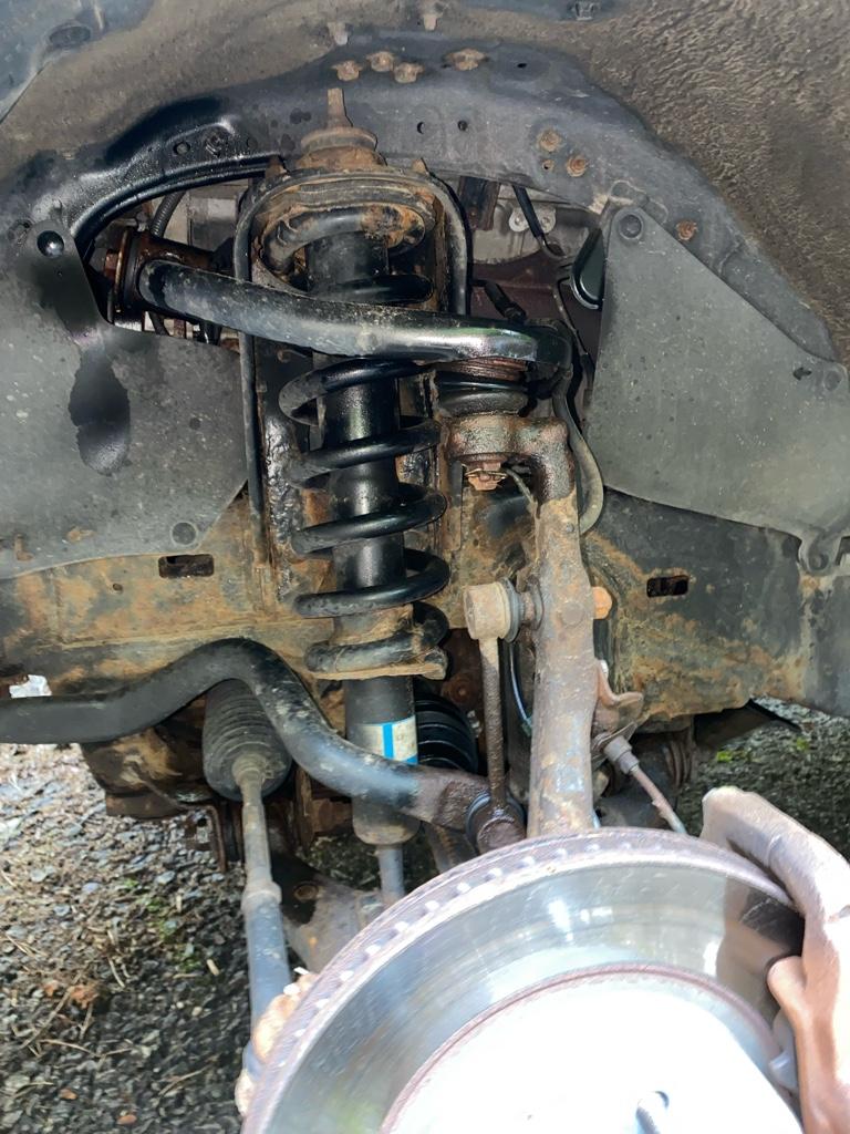

These really need replaced? Let's see some pics.

Hard to see the back half of the upper control arm but other than someone spraying something near the front bushing they seem to look fine. Not really even that rusty. Can't see much of the LCA but also probably fine. These just aren't parts that really need replaced. Bushings may wear out. I've never had to replace the UCA and LCA on a Toyota (or the bushings). I replaced the upper ball joints on a 300k Sequoia and realized after I had them popped free from the UCA, the UBJ's were almost as tight as the brand new ones I had ready to replace them with.
