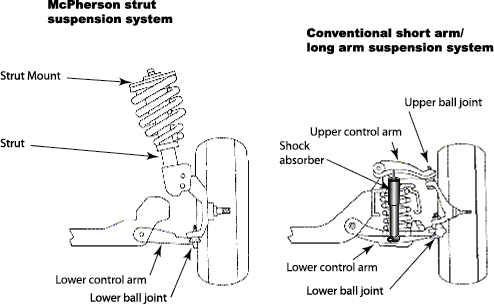

i keep saying it because its true. the definition of a strut vs a shock clearly describes the difference, struts are part of the steering axis & dont have an upper control arm. shocks/coil over shocks dont have any rotating points related to steering & have upper & lower arms. but here is a pic to show it better.
regardless of what aftermarket companies or some mechanics call them, 4runners do not have struts, they have coil over shocks in the front with upper & lower ball joints in the 2 control arms & do not rotate.

LOL. not upset at all, i just prefer to call them the correct name for what they are... coil over shocks. toyota calls them shocks too in their service manuals, not struts. a modern mcpherson strut incorporates the steering rotation in the assembly, a shock/coil over shock does not.

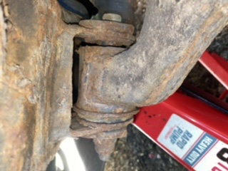

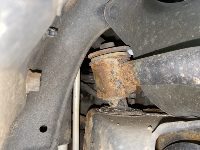

Better pics of CA’s
Here’s some better pics of the control arms. Looks like the bushings are beyond toast. Anyone think I can save the arms and just replace the bushings?

ouch, yes those bushings are toast. you can probably remove the arm & replace the bushings but i think they sell a loaded arm with new bushings & ball joints for a very decent price. probably easier to replace the whole arm & save a lot of work.
Was thinking the same thing. If I’m gonna go to all that trouble, might as well just replace the whole thing. Will probably do the shocks at the same time. This will be a big job, but I’m ready to tackle it and save about $3,000.

Those LCA bushings remind me of [MENTION=429038]y=mx+b[/MENTION] lol, be prepared to sawzall the cam bolts off. He has an excellent write up. Just click his name and look through his history. Good luck!
Like [MENTION=109843]montijo505[/MENTION] said, I've got a writeup on replacing mine here: Whiteline Lower Control Arm Bushing Tutorial (120+ Pictures)
I did it all with hand tools sitting on my butt in the driveway. An impact makes the ball joint press stuff much easier
After watching some videos and reading some write ups, I think I can do this. Can’t you buy arms with ball joints that just bolt on? Maybe I am not understanding what press means.

And to answer your question, yes you can get completely assembled arms that you just install.
