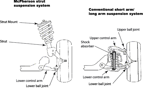

i keep saying it because its true. the definition of a strut vs a shock clearly describes the difference, struts are part of the steering axis & dont have an upper control arm. shocks/coil over shocks dont have any rotating points related to steering & have upper & lower arms. but here is a pic to show it better.
regardless of what aftermarket companies or some mechanics call them, 4runners do not have struts, they have coil over shocks in the front with upper & lower ball joints in the 2 control arms & do not rotate.
hope that enlightens you

please enlighten me (us) where toyota calls 4th gen 4runner front shocks, struts??
when buying new shocks from toyota they are called shocks. & in the repair manual they are called shocks, no mention of these being called struts on 4runners.
not sure why people are so confused on the proper terminology of shocks vs struts... probably comes from aftermarket companies & mechanics using generic terms, but if you hold a shock or coil over shock in one hand & a strut in the other its very obvious how/why they are different.
my apologies for correcting people when they call them struts, i have this crazy affliction where i like to provide accurate info in an attempt to help others... & i appreciate it when others help or correct me when im wrong. :peace:
