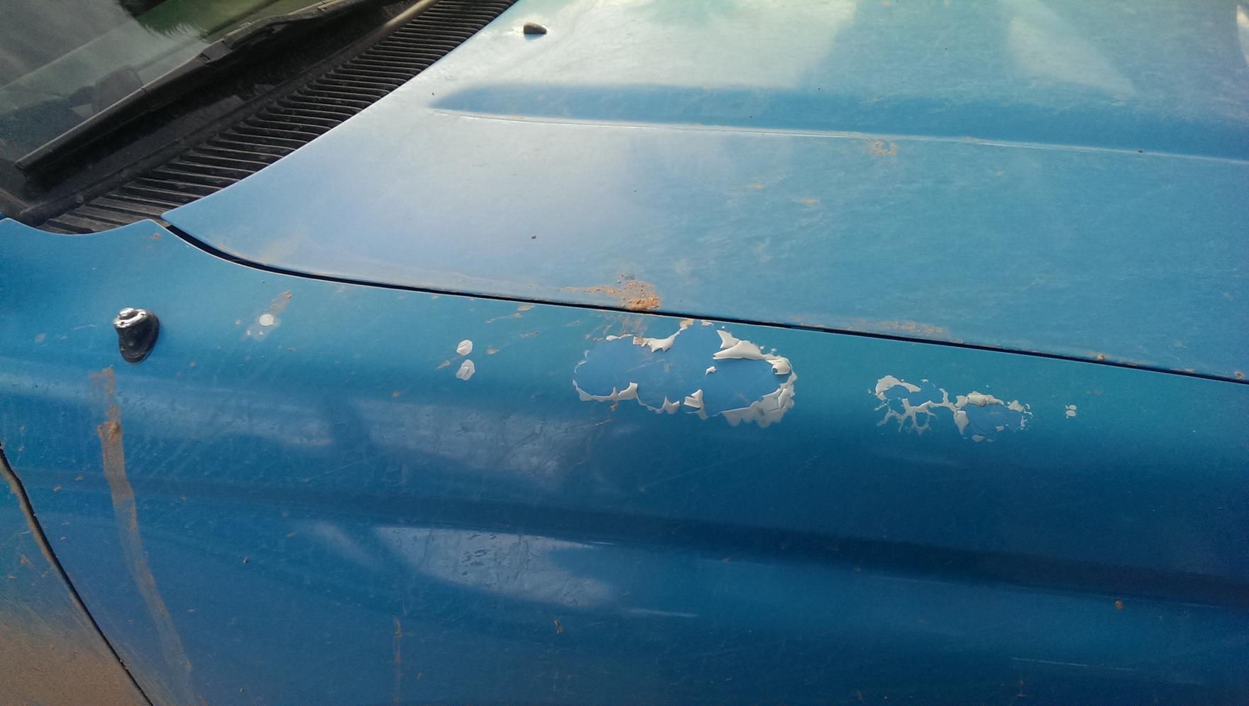

So looks like the next mod is new paint.
Any color suggestions? I'm thinking just going back to the stock evergreen pearl.
